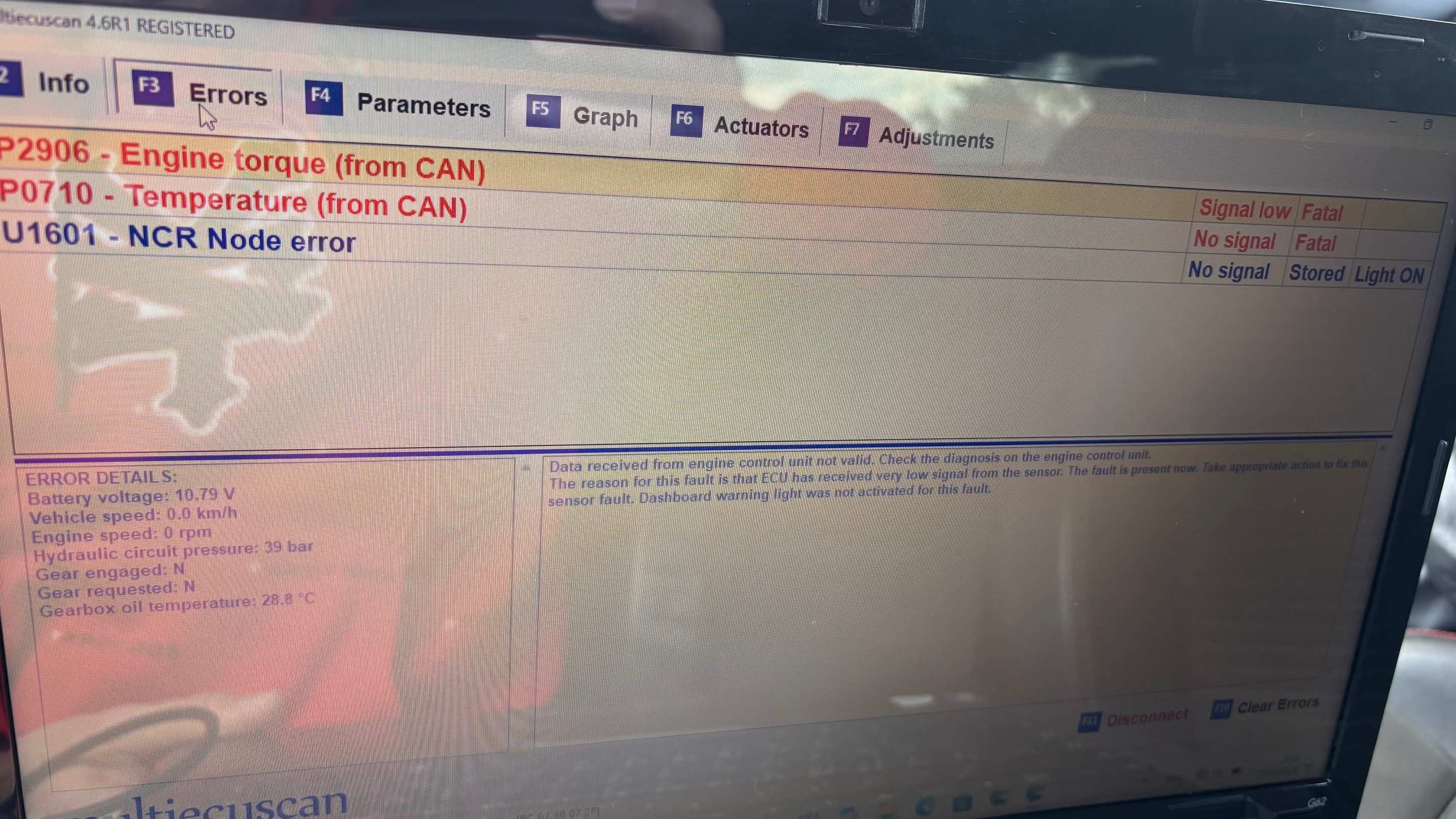

So those are the same errors that you had in December. And same low battery voltage.
Yes, these are the same problems that remain. It's interesting that it shows an error for the temperature, yet it detects that it is 28 degrees. The low voltage is because the car is not started, and even when I kept it connected to the charger, nothing changed.
Perhaps that's a minimum reading for the sensor. It's not the external temperature, but the gearbox oil temperature sensor.
Can you measure the voltage on the battery. Because if it's different, perhaps that could be a clue.
I can't figure out where this temperature sensor is located.
Yes, I can measure the voltage on the battery, but it's not that important because it was connected to the network, and the voltage was normal. I'm not talking about that time when it was 10v
The sensor can be inside the gearbox.
What I was thinking about is that perhaps the BCM is damaged and shows strange values. Could be an internal error or a connector problem.
I find it strange that voltage, temperature and three errors are still the same a month or two later. And despite the errors you've managed to do the proxi alignment.
I have already replaced the BCM with a similar one, though not new, and the situation remained the same. I recently reviewed old photos of these errors, and yes, the temperature was consistently recorded as 28.8 degrees. Should I check while the engine is running?

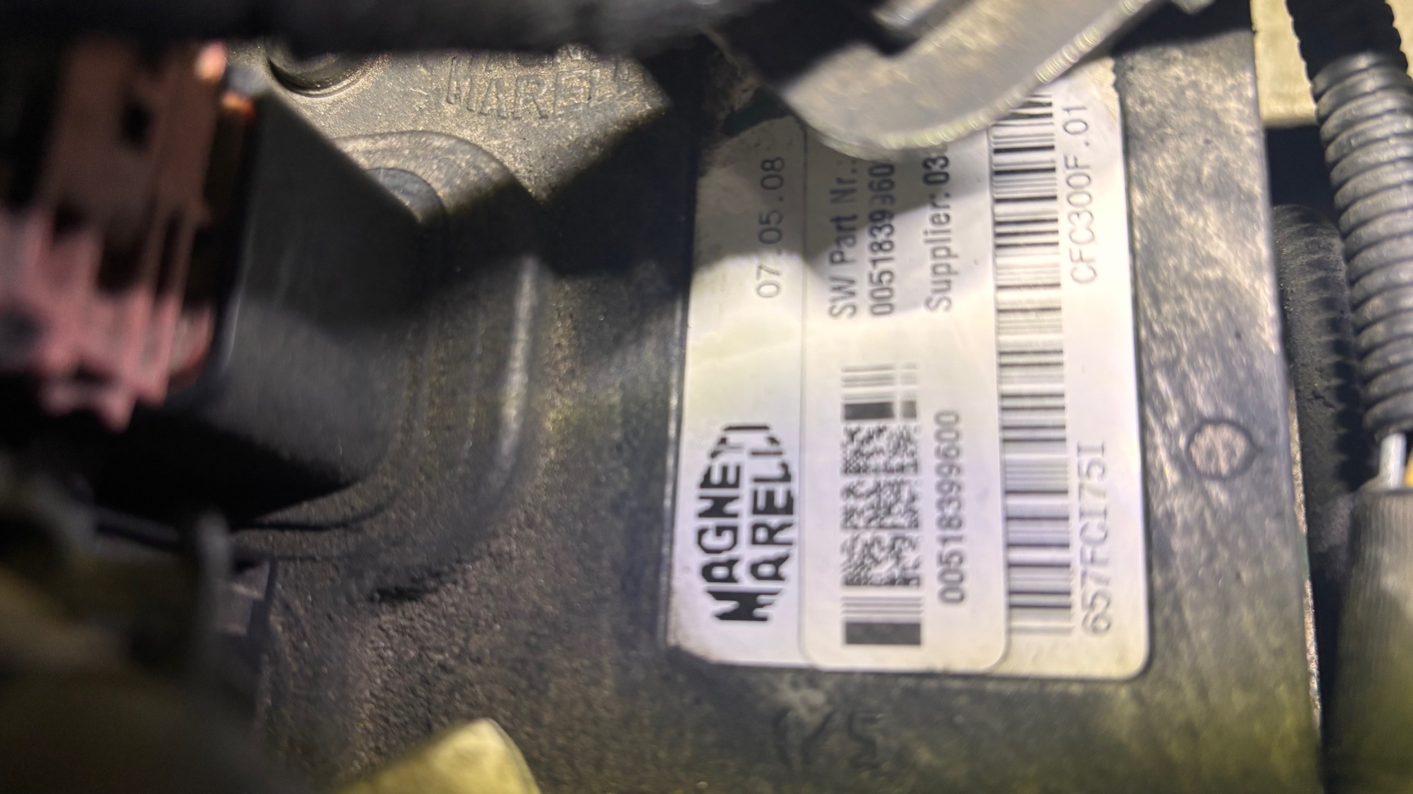

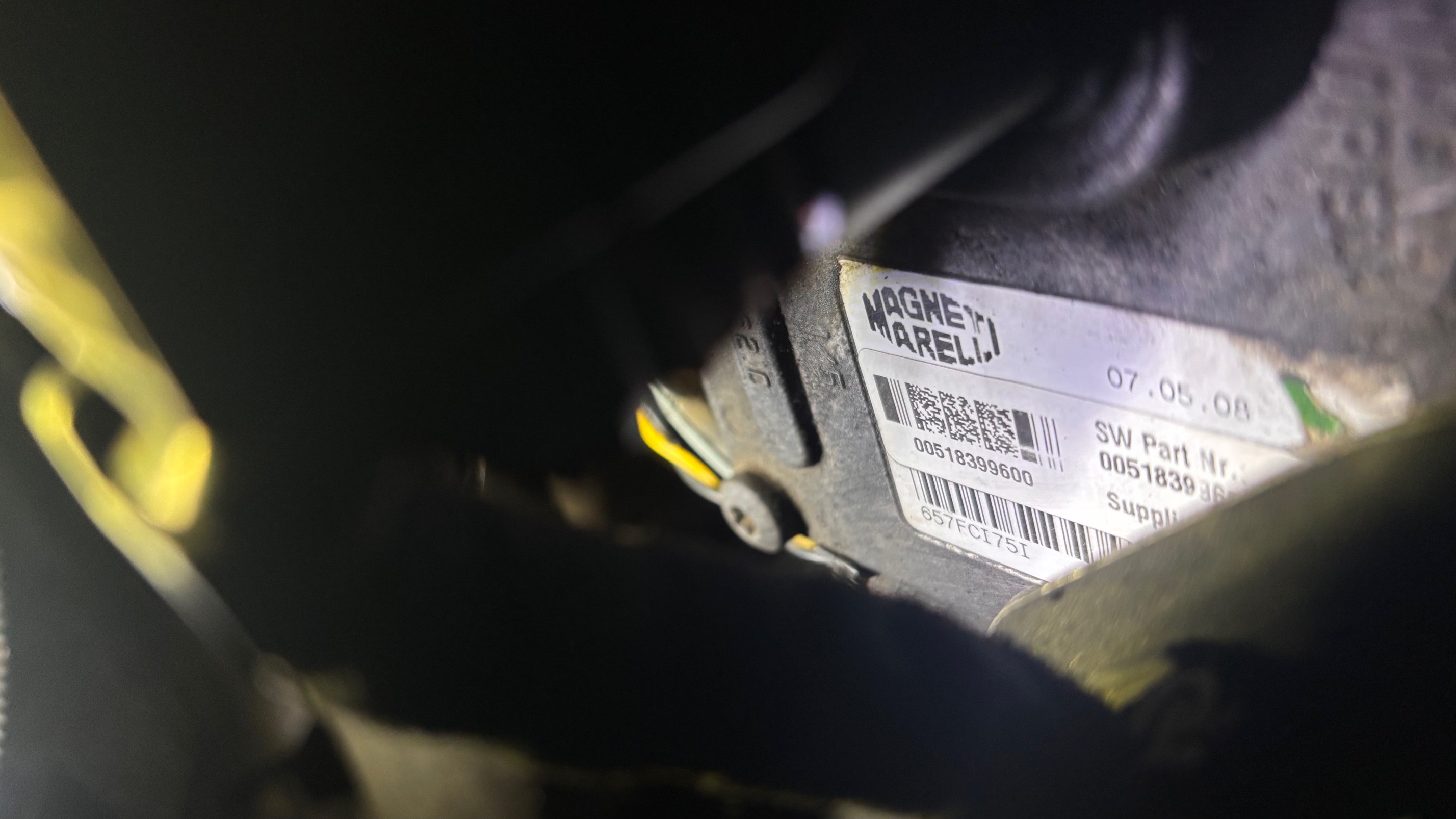

Here I took a picture of the robot module, it's impossible to get it here, maybe someone can help me get one?

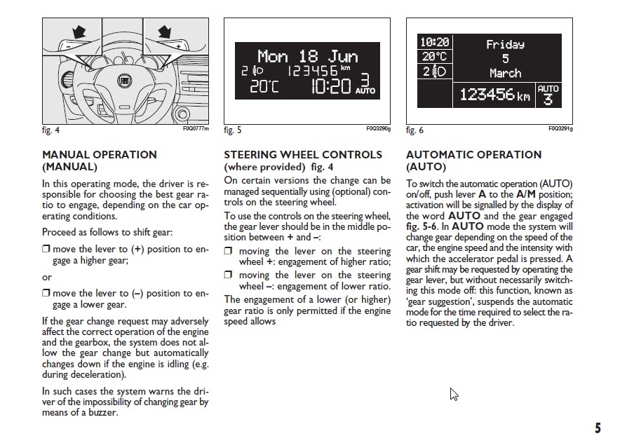

so, if have the display on fig 5 cannot change it with mes to fig 6? Unless if changing the whole speedometer unit, correct?
No, you can't. The hardware is different.
I'm not even sure if it's an easy swap for the speedometer unit, as it certainly holds some data from the car, which could be unconsistent with the data hold in the BCM.
its possible with proxy. Just thought that display style is a software job, which seems wrong
