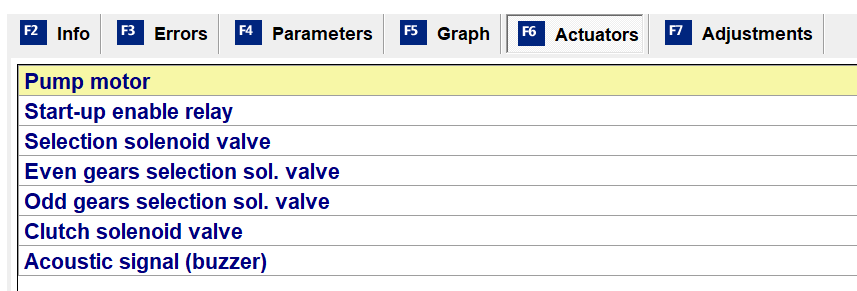

Have you observed all the actions described in the Actuator tab? All the results are Failed, but as far as I remember you have to confirm manually the action had place. It's something that MES cannot decide on its own.
All the readings in the Parameters tab seem to be OK.

Apparently, everything I checked is okay... but during one of the actuator tests, there was a pop and the result is in the photo...))))))))
But as you can see, I've already taken it apart and replaced it. If you could suggest what actions to take after the replacement, I would appreciate it. I mean how to bleed the system...
