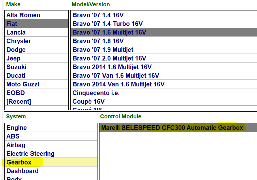

I have already checked everything according to this diagram. If I am not mistaken, the problem is with the CAN bus. I have checked the wiring according to this diagram, and everything is fine there. What else should I do? Do you have any advice?
Where from you've got the information that the U1601 is a CAN bus problem?
On the screenshot from MES I can see 'U1601 - NCR node error'.
The car is trying to communicate with you, but from the beginning you're trying to look as far away as you can.
