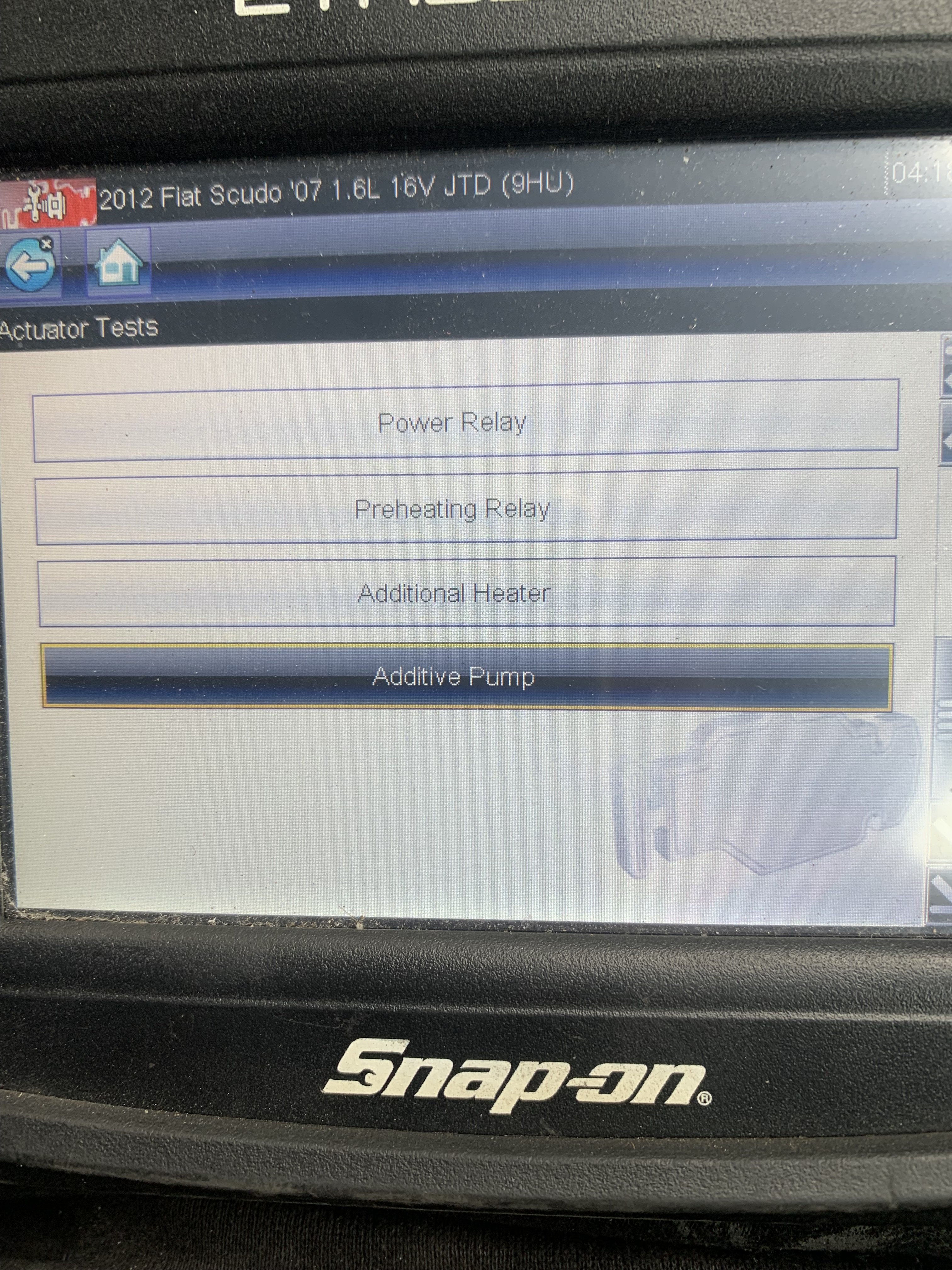

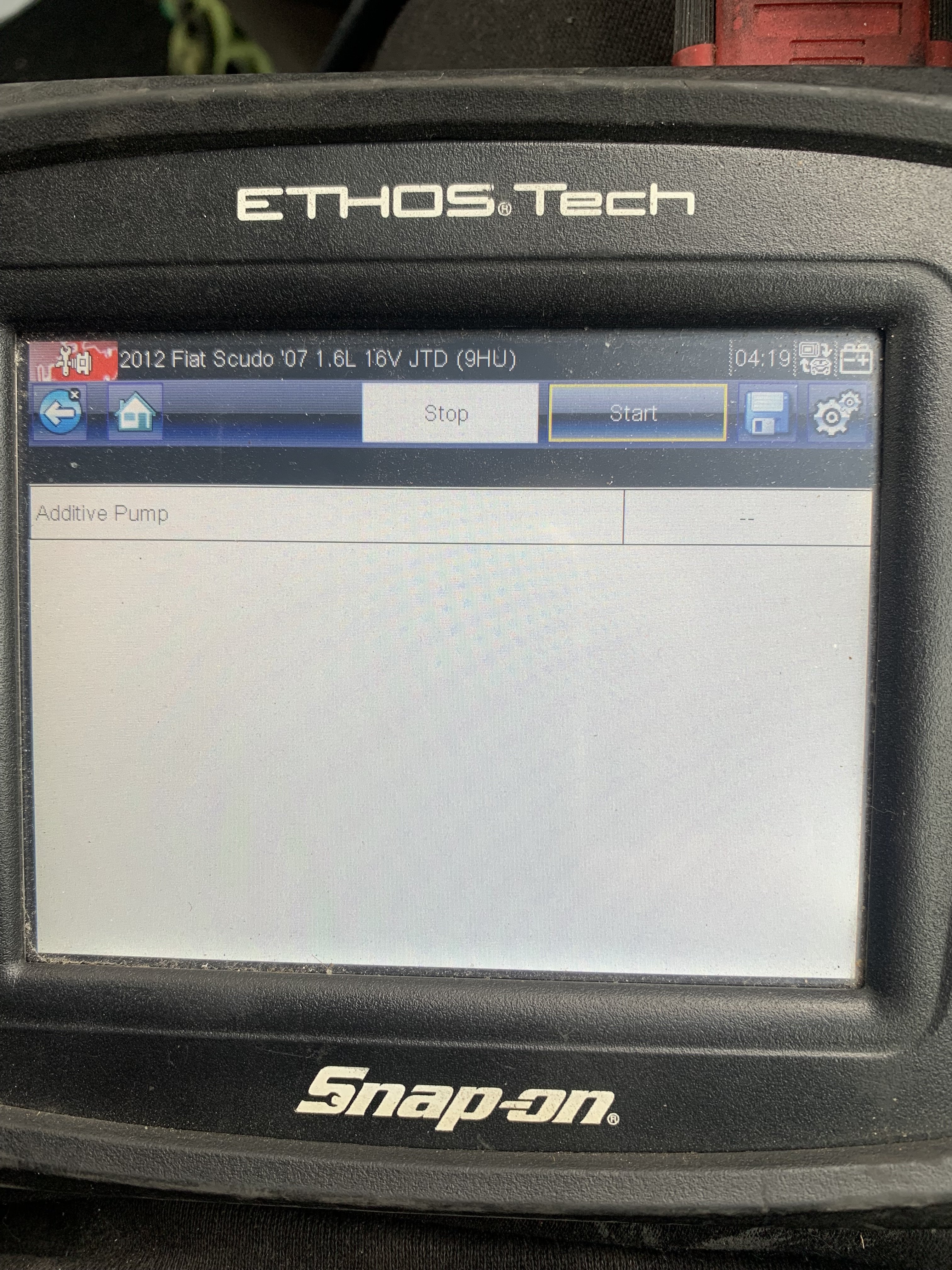

What is the 2500 rpm trick? and is my pump faulty? I have lots of fluid in the tank, i have a snapon tool which in functional tests additive pump is listed, it has a start stop but not sure what its doing? Please see attachments

On the Snap On tests has it got a function for after replacing or topping up fluid reservoir, there should be a help section to guide, but basically it involves priming the pump, assuming it is working to to get the air out of it.

It is not unknown for them to fail, on the Citroen one my diagnostic tool told me the amount of fluid left and also the state of the DPF filter.
Then I used my mates Snap On tool to prime the pump after refilling the Eloys fluid bag.
where do i check on my snap on fluid level? cause its got loads..
I don't know for sure as I only use my mates on odd times as I am retired, but if you have got it to recognise your vehicle and then go into the bit about replacing DPFs and Eloys Fluid reservoirs etc. It should guide you. I did it on the Citroen with your 1560hdi engine and it was fairly straightforward. I told it I had fitted a new DPF (I had removed and cleaned it) and then told it I had replaced the Eloys Fluid (I had refilled it using a kit, don't get it on your hands, kit comes with plastic gloves etc.)
