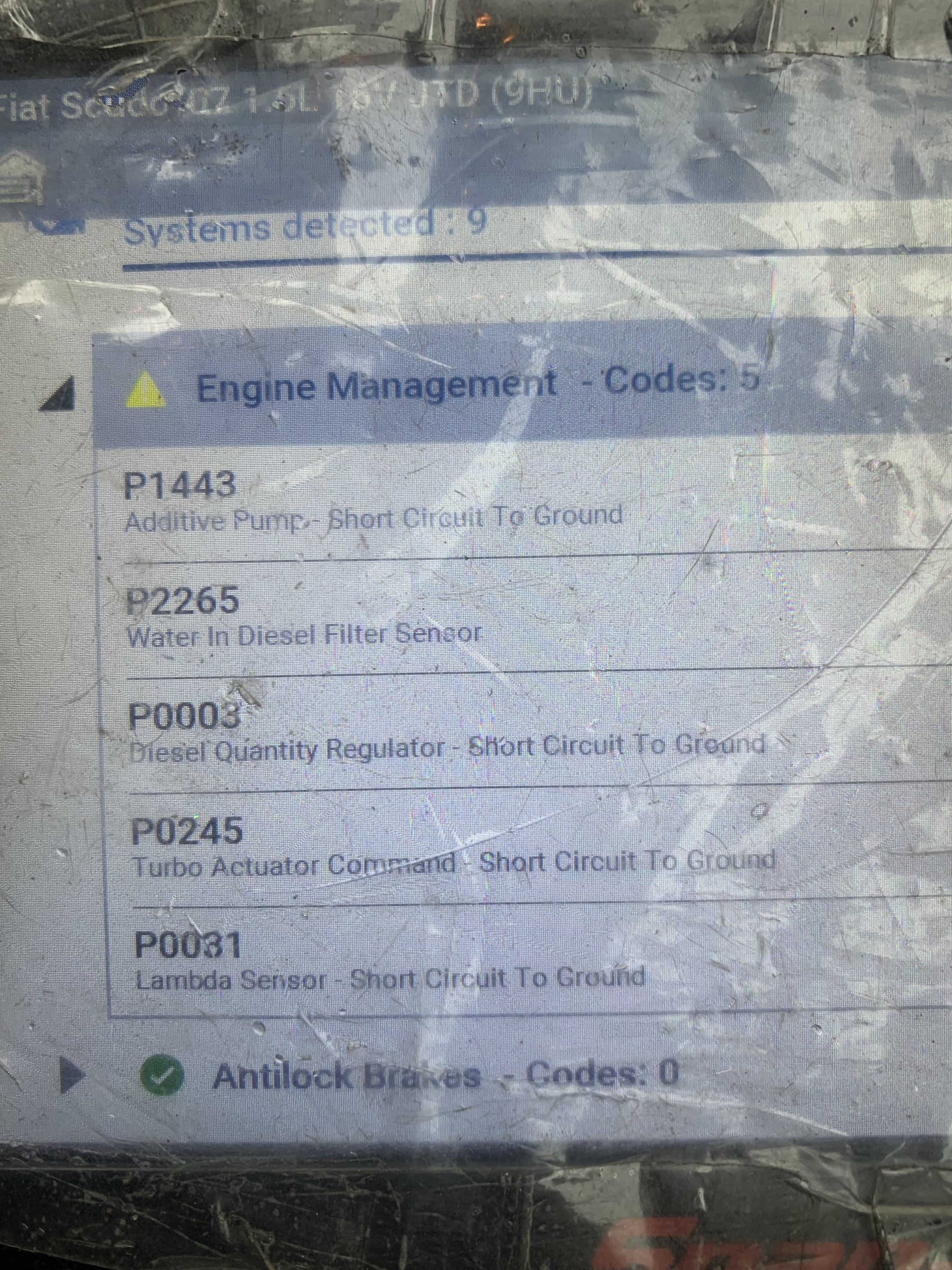

I have 4 codes, the codes sound like an earth problem, snap on wont clear them, could anyone please tell me where to start? Van is on STOP.

Not been flooded, it happened all of a sudden, every code saying short circuit, ive looked at all the fuses, took battery live off then unplugged ecu then replugged cant see any damage, even checked earth from front to battery, i have new fuel filter and primed, non runner
Most of the error codes seem to reflect a wiring issue, so hopefully not ECU or BCM, generally lots of people blame a computer but usually it is external as in wiring or sensors etc.

Snapon zeus up to date, it clears and they come back, each code description is “short circuit to ground” this is not a component issues but wiring i’m just wondering is there a weak spot somewhere on vehicle, is the BCM under bonnet to the left holding many fuses? Thats ive not unplugged but checked earth to battery

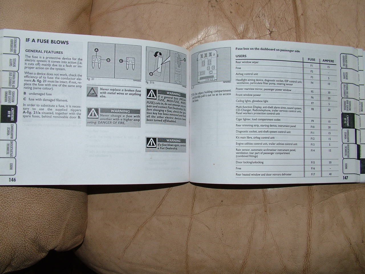

Don't know if any help, but these photos are from my handbook on the 2010 Scudo 2.0 LWB fuseboxes , saying what does, what so may help identify. The engine compartment fuse box does appear to be what is described as BSI/BCM?
Rain water does seem to get around engine compartment a lot on these vehicles.:(
