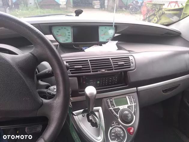

I've attached a photo of the gear selector from a 2004 Fiat Ulysse. Pretty sure it would fit into the Multipla with minimal modification. The problem would be the rest :)

There are almost always a ton of bits you’d not expect that are different between an auto and a manual gearbox car. People often convert a failed auto to a manual as it’s a lot cheaper and easier to find a manual box, any auto sensors no longer needed you tape off in what ever position they need to be in.
If you have a manual you won’t have those sensors or the wiring, or in some cases the software in the engine or body ecu. Nothing is impossible but I think you’d have to gut the car and literally swap everything over, including dashboards, and wiring looms.

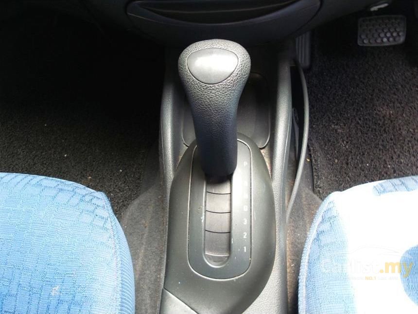

The gear selector switch on the Marea is goddam huge and will be a bitch to put in the Multipla
No boost in engine power as the automatic Marea uses the same 100 1.6 16V 103HP engine as the Multipla :( but hey, it's acceptable for a low-budget automatic conversion
I've attached a picture of the landing strip which is the Fiat Marea gear selector. Any way this can be adapted/converted to one from a Fiat Ulysse or something smaller? I'd have to cut into the dashboard of the Multipla to put this humongous thing in
