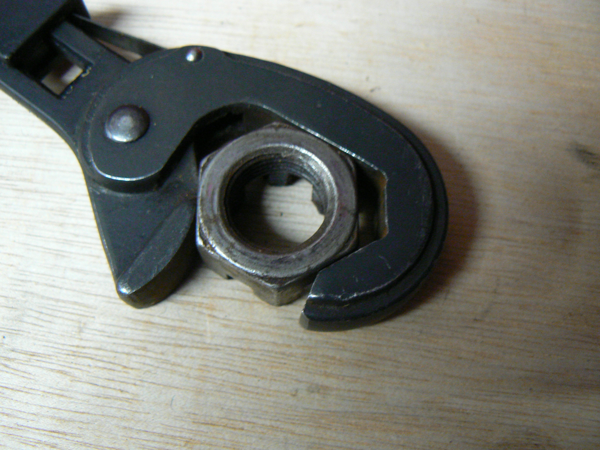

A number of years ago I found one of these:
in a market in Salisbury town square whilst visiting my daughter. It's a Stanley brand which is not a brand I particularly think of in relation to automotive tools but they make good enough screwdrivers etc. I liked the look of it because it has 3 gripping sides but more importantly, it grips the hex it's on tighter the more pressure you apply to it's handle (on the return stroke it also "jumps" round to the next set of hex flats so, on something like a tube nut it grips extremely well with none of the tendency of a split ring or open ender to splay the jaw flats and you can "ratchet" round a set of flats at a time as you slacken the nut. Each wrench handles a range of sizes too.
It was actually the biggest one I bought in that market because I wanted to use it on the locking nuts on steering rack track rods - which can be "stupidly" tight and cause open enders no end of problems. Unlike a Stilson, which is what I would often use on tight ones, it doesn't mark the nut faces. It works so well I then bought the other two off a site on ebay, (there are only 3 in the set, each wrench, as I said above, doing a range of sizes. The smallest one is my automatic "go to" now for tube nuts.

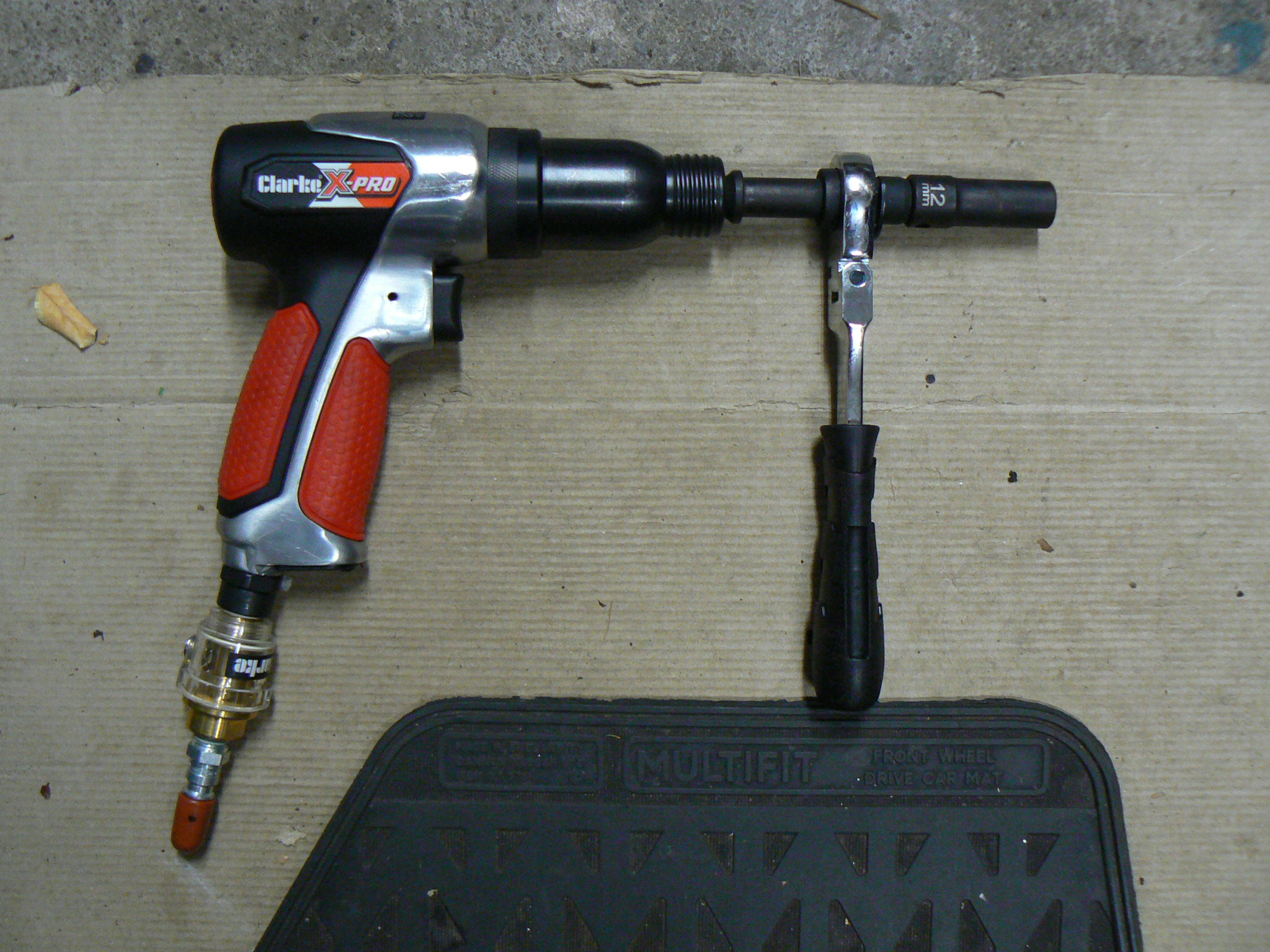

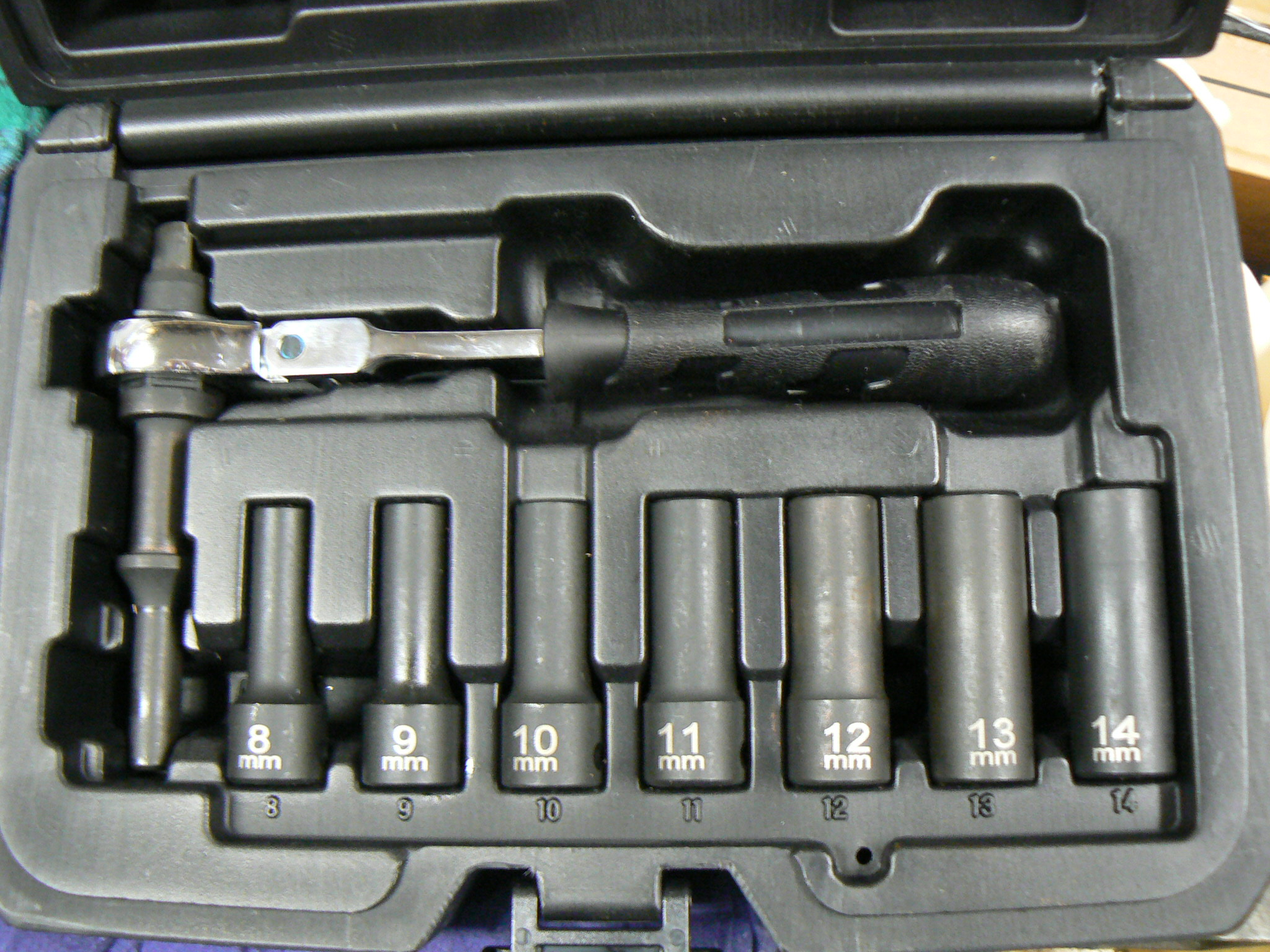

Lastly here's a tool I've shown you all before but at that time I hadn't had it or used it much so, apart from having wanted one for some time and being very pleased now I had it, I couldn't really comment on its usefulness. I was a little worried it had been an expensive indulgent purchase which I might not use that often!
It works in conjunction with an air hammer - just an ordinary one will do
but the clever bit is that the hex depth inside the socket is quite shallow so when you put a hex into it it stops before the whole hex is inside
This is critically important because it works by shocking the screwthread of the fixing thus loosening corrosion. You have to bear this in mind when deciding where to use it. Ideally it works very well indeed on brake bleed nipples which is primarily what I bought it for. Look at these pics to see how the nipple sits in the socket:
and here it is on the nipple of the new cylinder waiting for me to find the will to install it into Becky. Notice the socket doesn't "snug" down completely over the hex head? this is critically important to ensure the hammer vibrations are transferred into the nipple not the casting
In use you would spray some Plus Gas on the nipple and then assemble the air hammer, driver punch complete with it's handle and suitable sized socket:
Then put the socket over the nipple and trigger the air hammer. Let it hammer away for a while, I usually give it about 20 secs to start with. Then, quite gently, try applying a turning force with the wrench handle. Stop well short of what you would judge a shearing force to be if the nipple doesn't move and carry on with a bit more hammering. The most I've had to hammer for so far is about a couple of minutes (that seems like forever when you're actually doing it) but you must resist applying too much turning force and snapping the fixing due to impatience. Keep hammering and it will slacken in the end - at least every one I've used it on so far has! Its absolutely "magic" on bleed nipples (for which it's specifically intended) but I've also removed a tube nut after I'd sawn off the pipe which i didn't think had the slightest chance of coming out and so saving an otherwise good cylinder. Normally in a situation like that, where I wanted to save the cylinder but couldn't move the tube nut I would take the cylinder off the backplate and clamp the stub of the tube nut in my vice then rotate the cylinder to get the remains of the tube nut out but if the tube nut is that corroded there's a good chance the cylinder retaining bolts will be too so you're making problems by trying to undo them. Just cutting the tube off and "attacking" the otherwise undamaged hex on the tube nut with this tool almost guarantees it'll undo - and the cylinder stays where it is! In fact It works on anything where the vibratory force is being applied directly through the fixing to the screwthread. So brake parts as mentioned above but also a nut on an exhaust manifold or a bolt screwed into a casting - I'm thinking up new situations for it all the time. The socket range that comes with it is quite limited but, as long as you are working with a flat headed fixing (like a hex headed bolt for instance) you can just pop a nut or two inside a standard socket so the force is applied to the fixing through the nuts not through the outside of the socket to the casting as would happen if you didn't put the nut spacers inside the socket. What it's not going to work on would be the sort of situation where a nut is on the other side of a chassis member and you can only shock the bolt head. Or perhaps a bolt screwed through a suspension mount through the chassis into a captive nut - I think all you'd achieve would be to break the captive nut free! So you definitley have to apply the "little grey cells" but, used intelligently it's a wonderful tool.
