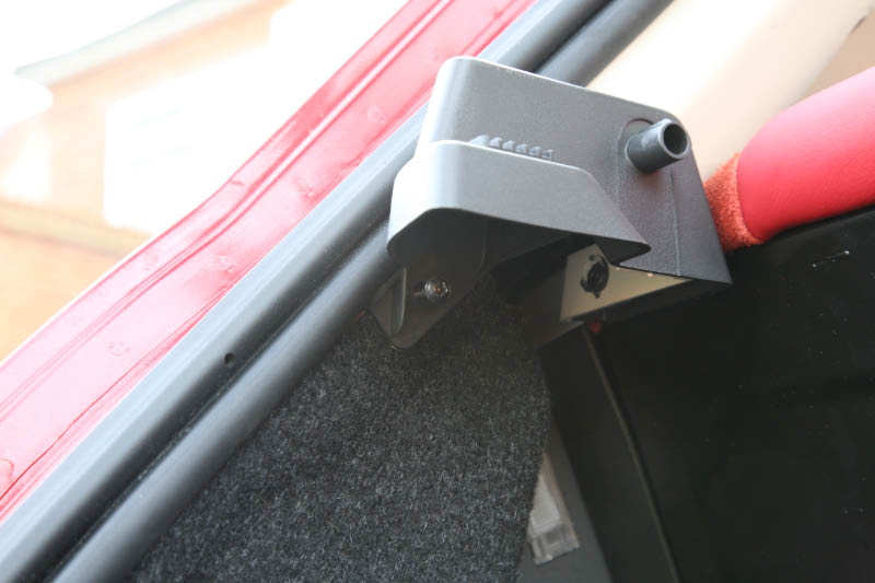

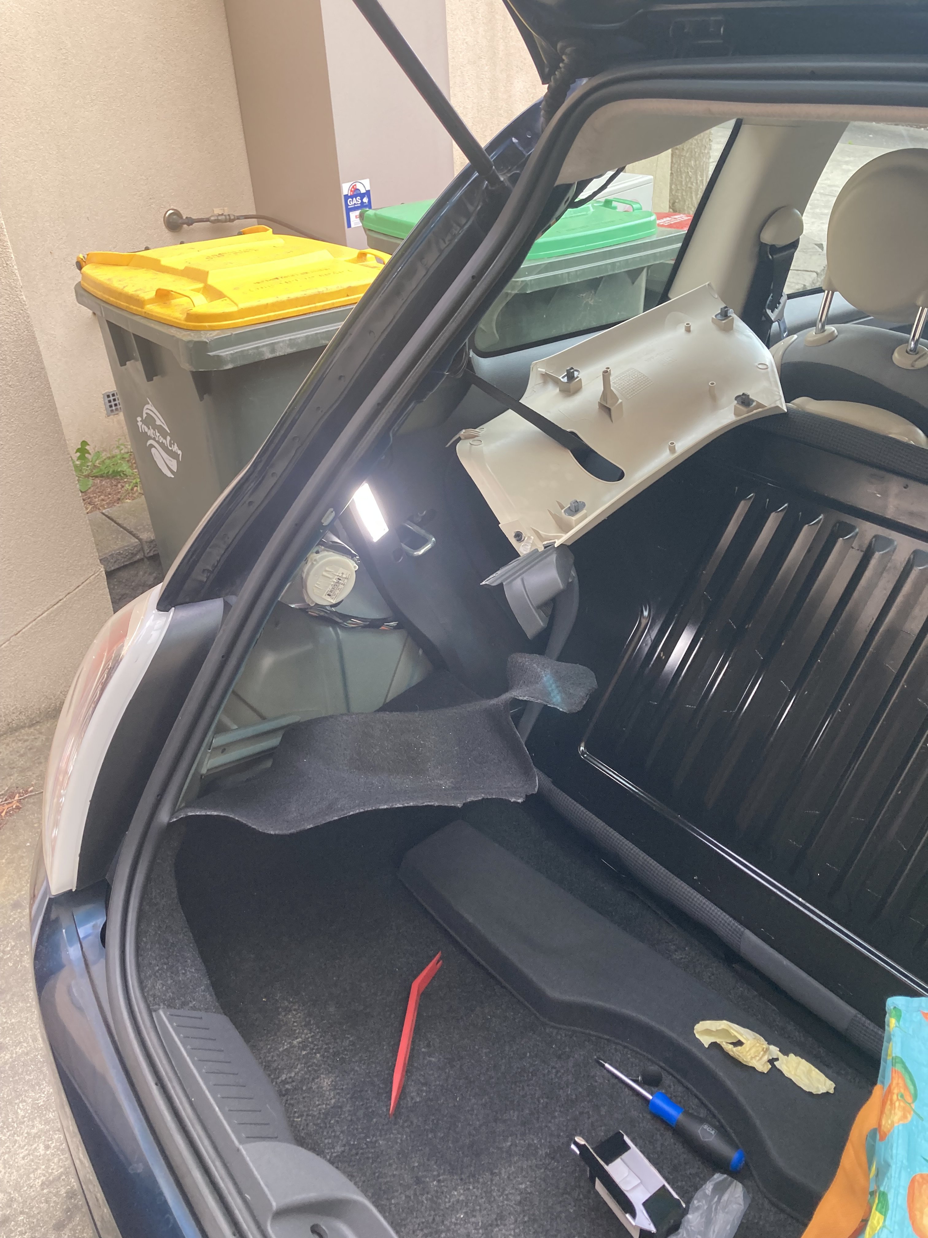

- Working from the back of the car, lower the rear seat back (or near-side back if a split seat) to improve access.
- Loosen or remove the screw that holds the near-side parcel shelf support to the body.

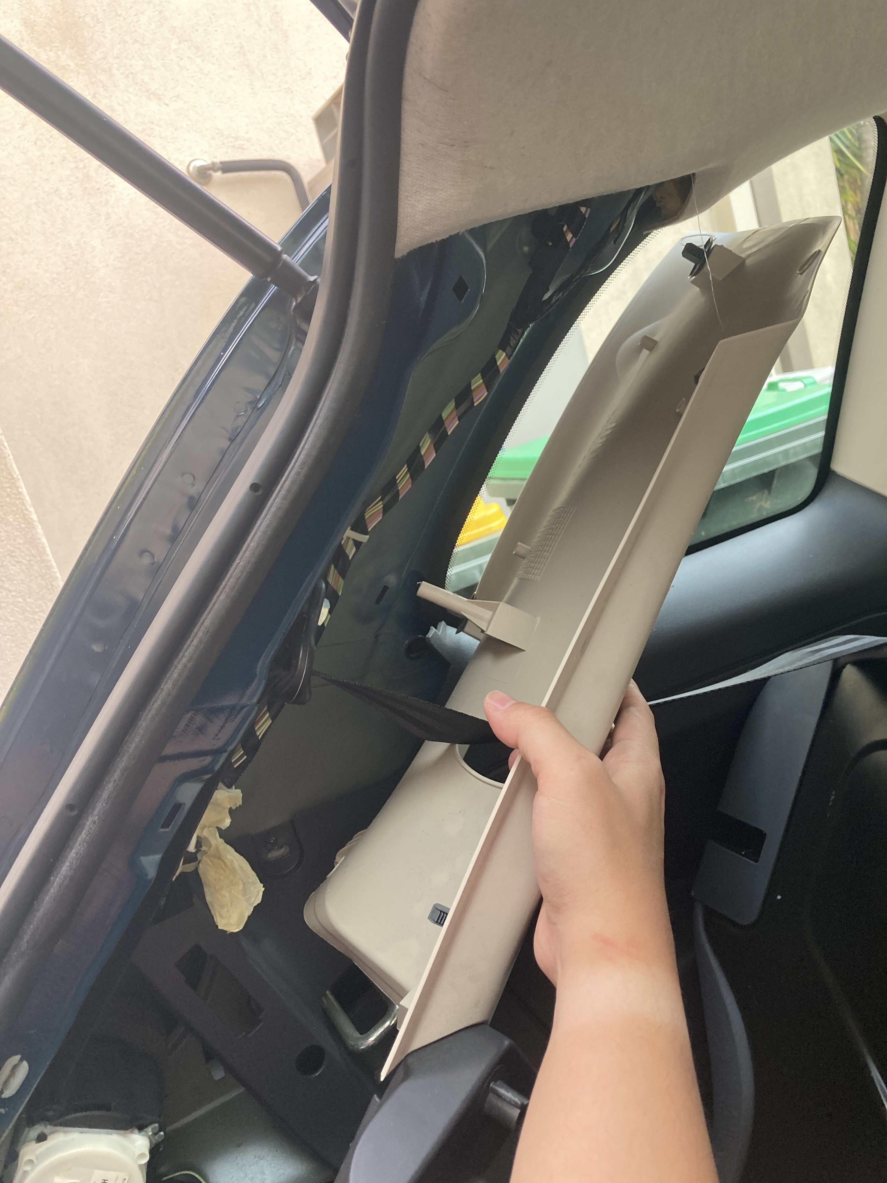

- Prise out the plastic push clip that holds the near-side carpetting to the body side panel either using a large flat screwdriver or a panel removing tool if available.
- Gently ease down the top half of the side panel carpet, or remove altogether.

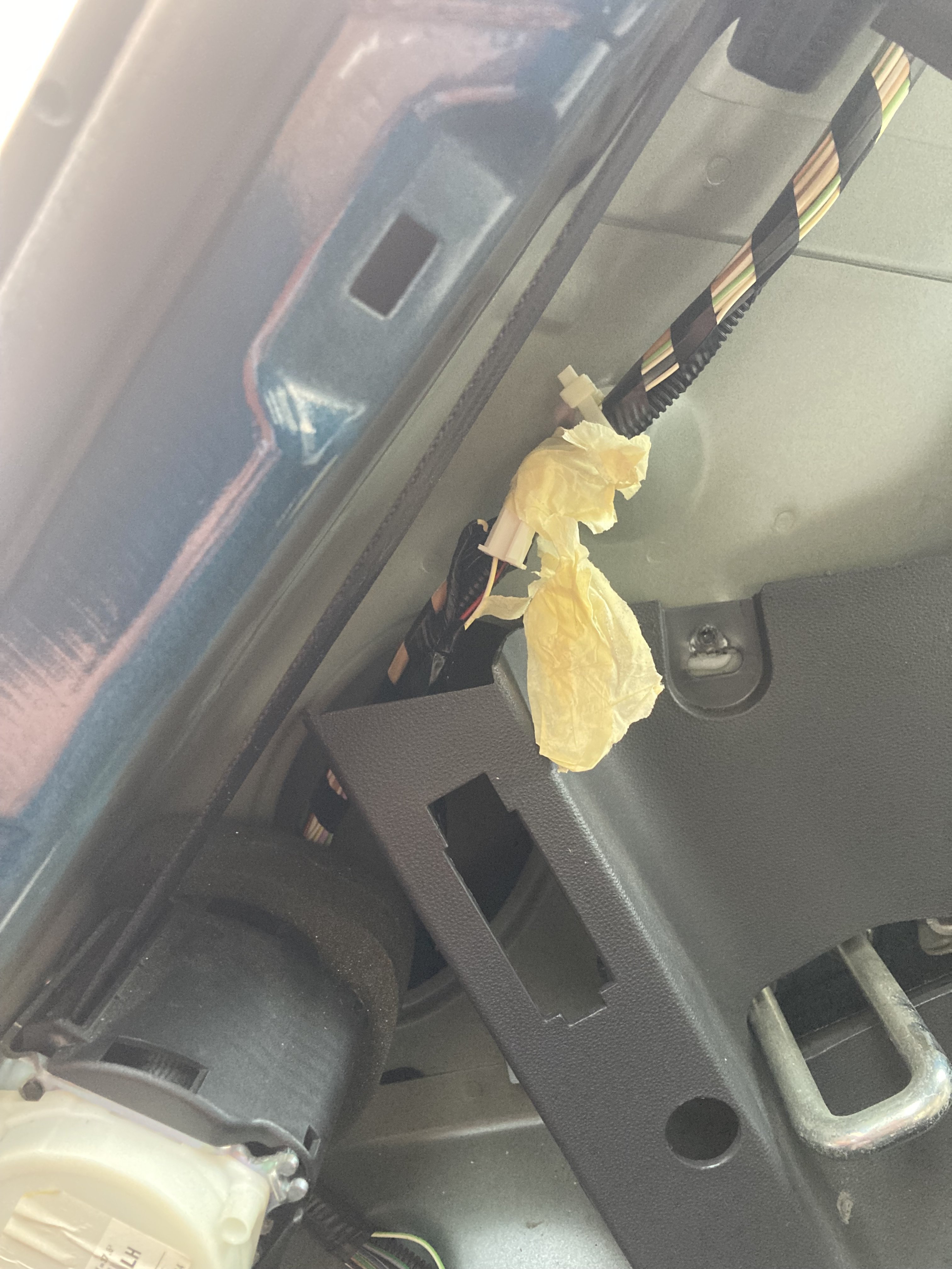

- Locate the cable for the boot light, which is likely to be taped to part of the loom behind the exposed seat belt mechanism.
Installing the Light
- Feed the cable through the aperture in the trim panel and connect to the lamp assembly.
- The light will come on as soon as the cable is connected since the boot is open.
- Slide lamp upwards into the aperture and push the lower edge to lock into position.
Refitting Carpet
- Gently work the carpet panel back into position noting that it tucks behind the rear quarter panel trim and the rear seat mounting.
- Push in plastic clip.
- Replace or retighten trim screw. Do not overtighten as it fixes into a plastic plug.
