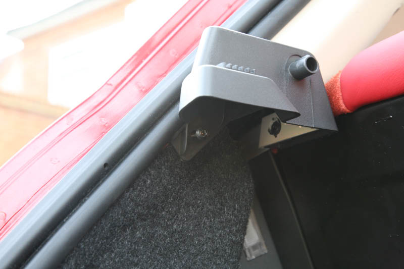

  • Working from the back of the car, lower the rear seat back (or near-side back if a split seat) to improve access.
  • Loosen or remove the screw that holds the near-side parcel shelf support to the body.
  • Prise out the plastic push clip that holds the near-side carpetting to the body side panel either using a large flat screwdriver or a panel removing tool if available.
  • Gently ease down the top half of the side panel carpet, or remove altogether.
  • Locate the cable for the boot light, which is likely to be taped to part of the loom behind the exposed seat belt mechanism.
Installing the Light
  • Feed the cable through the aperture in the trim panel and connect to the lamp assembly.
  • The light will come on as soon as the cable is connected since the boot is open.
  • Slide lamp upwards into the aperture and push the lower edge to lock into position.
Refitting Carpet
  • Gently work the carpet panel back into position noting that it tucks behind the rear quarter panel trim and the rear seat mounting.
  • Push in plastic clip.
  • Replace or retighten trim screw. Do not overtighten as it fixes into a plastic plug.
