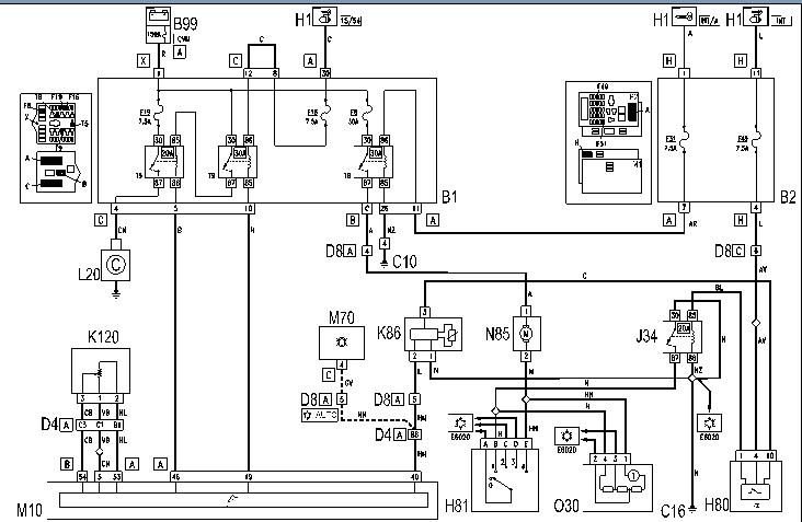

1.2 system.JPGClick to enlarge
If the frost sensor (shown as K86 here) is working properly then it should turn off the compressor for a while when the system gets cold enough otherwise your a/c sysgtem may ice up. If it isn't working then you may get your symptoms of a/c not working after a while of operation until you turn it all off and the ice melts
Try simulating what the frost sensor does and turn your a/c off say every 10mins and see if the fault disappears
