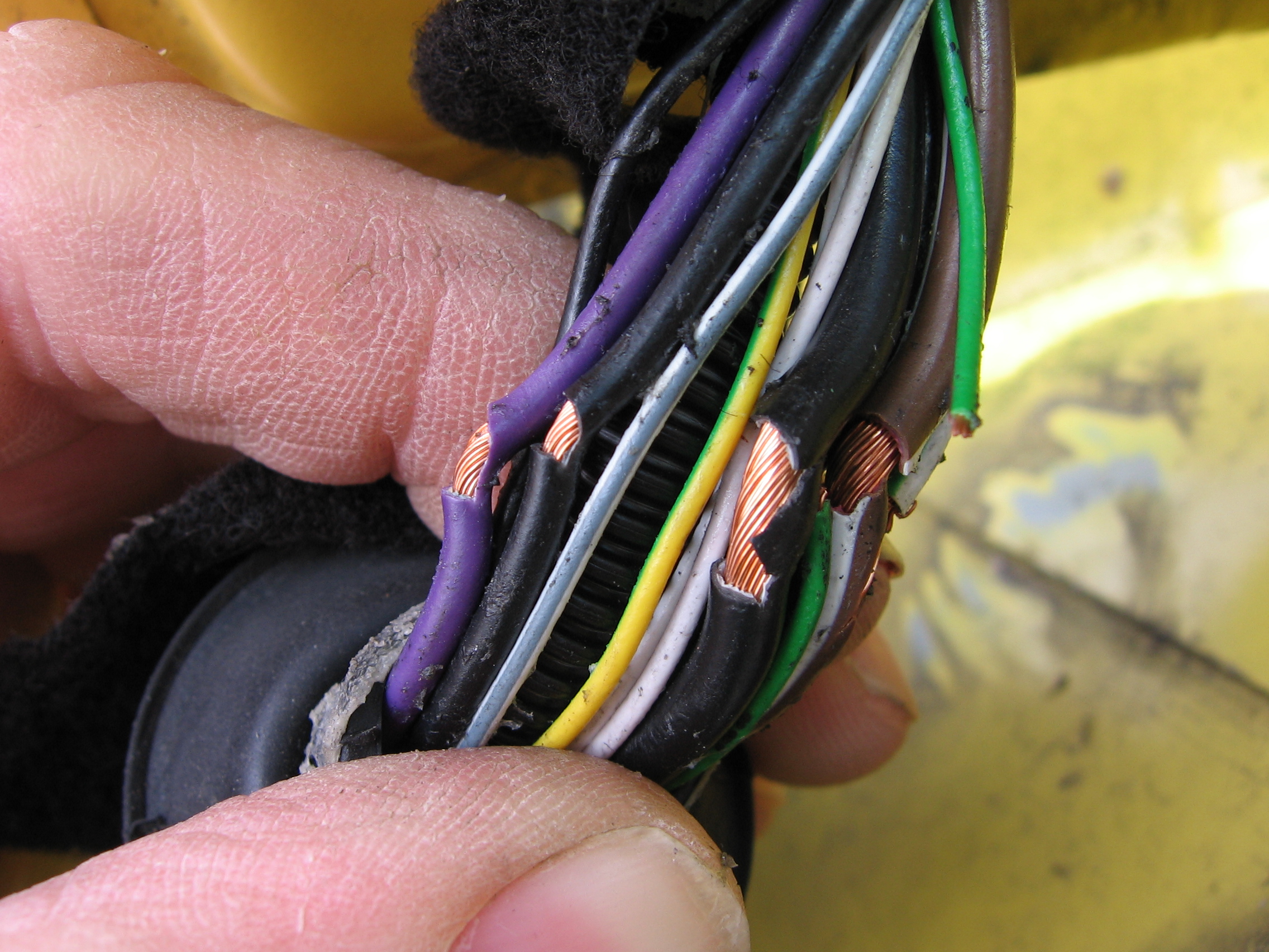

So.... having driven Benny for nearly 55 thousand miles, I started having an "issue" with the rear wiper; whereby it would start wiping for a few sweeps on engine start. A quick search on here found I wasnt the only one, but it wasn't a common issue.
The diagnosis was frayed cables where the hatch hinged.
So this weekend I got in there to discover this..
I did not expect this level of damage. The wiper feed wire is the broken thin green one btw.
Looks like I need to break out the wiring and replace a whole shed load!
So, if you havent already checked yours, do it as soon as you can. It may be worthwhile doing something preventative........
Cheers all.
Tony.
