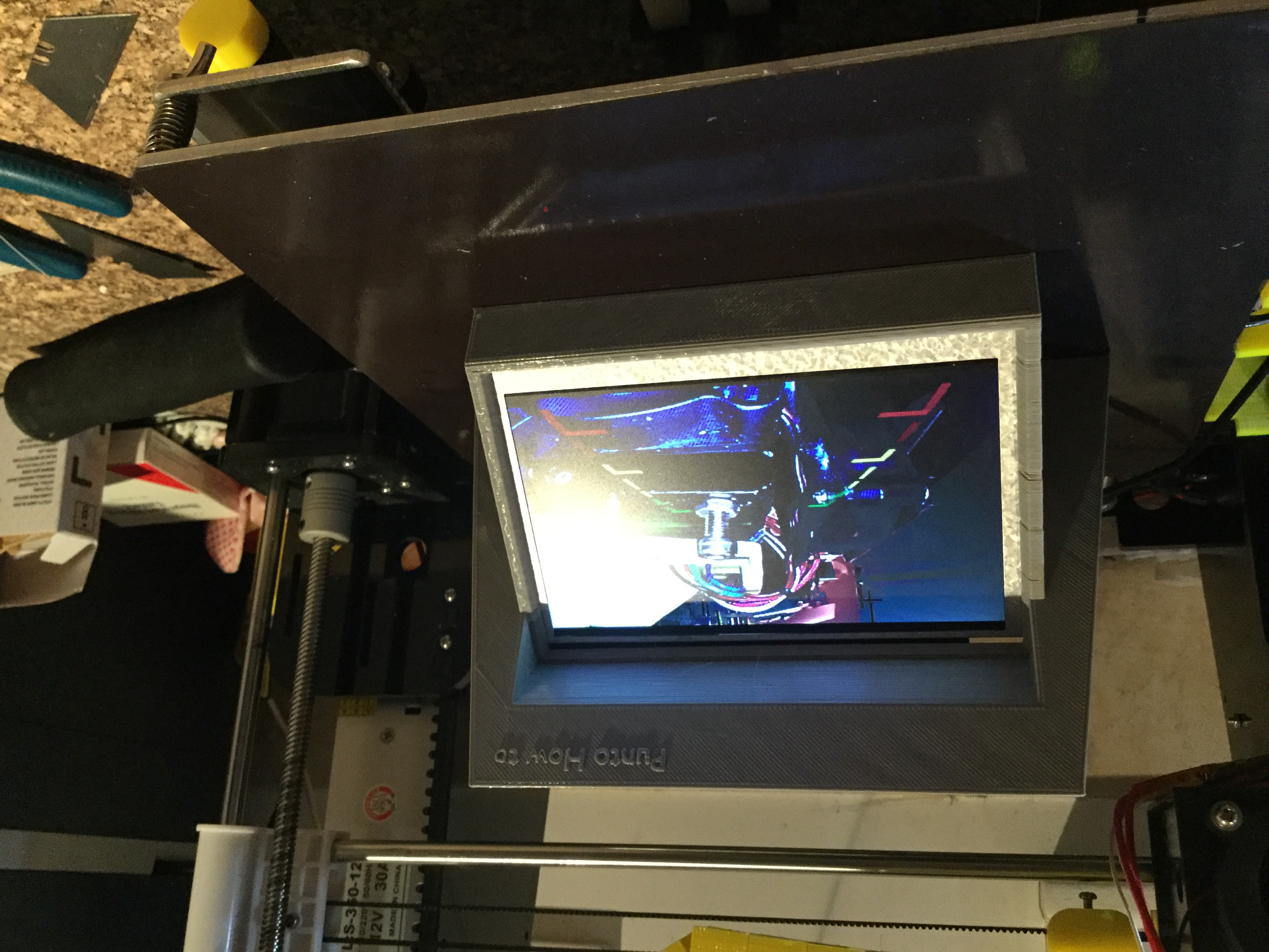

I got a 3D printer for Christmas and the whole purpose was for projects like this so I have set about designing a roof mounted binnacle for mounting the screen.

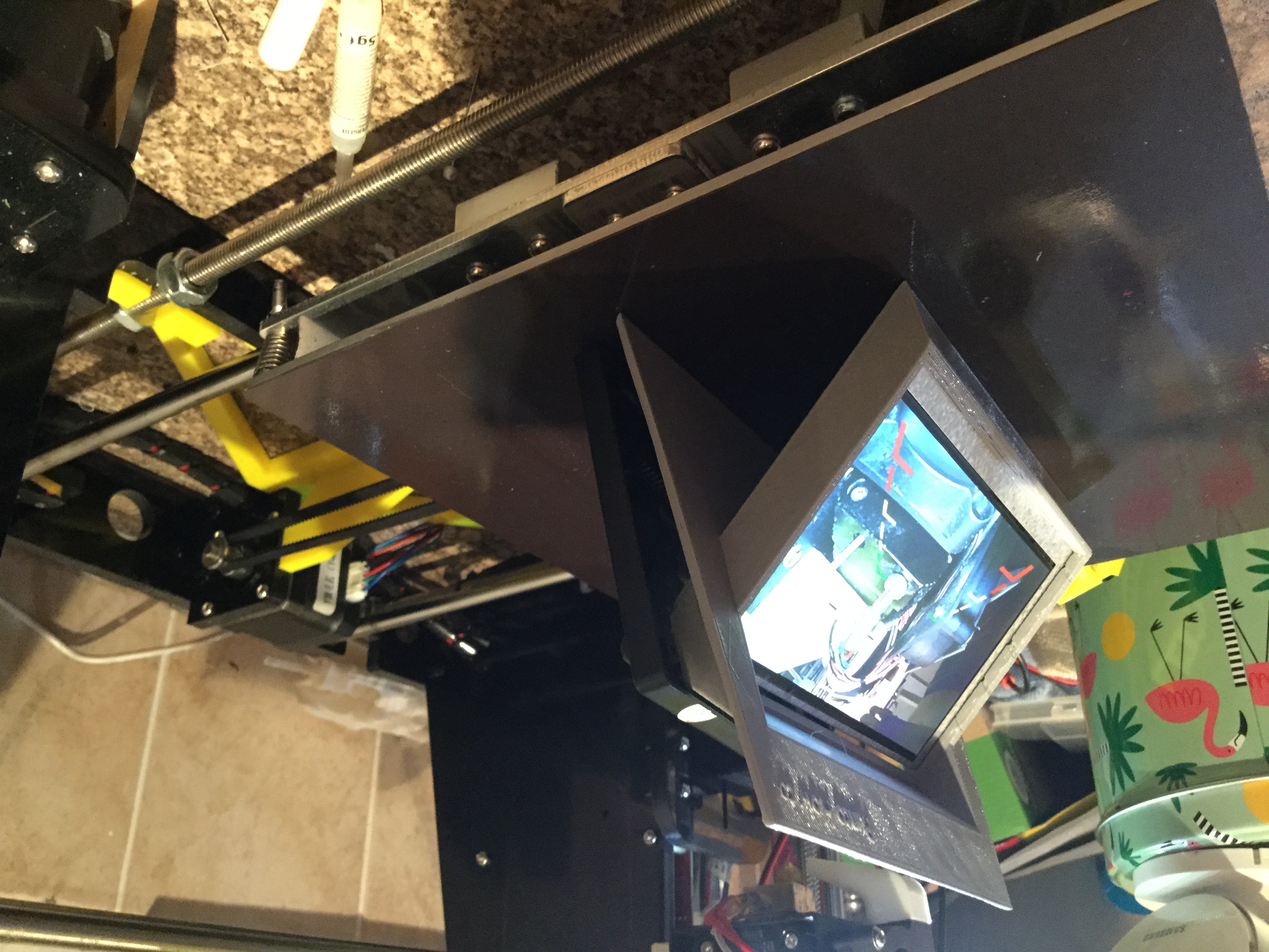

This is a project in its infancy and my 3D design skills are pretty poor at best, however here is Version 1.0 with the screen mounted. Fast low quality print, to prove the concept. Watch this space for future updates. At the moment all I can do is work on the binnacle, but once my back is better I can do the full install.
attachment.php
attachment.php
Back to the drawing board, I need to add vent holes to let heat away from the back of the monitor and give it a little more space behind for components as it’s a bit tight.
I need to also make the front enclose the screen better, as at the moment you can see the galvanised frame of the monitor. I may move the monitor back and include some space in front of it for some buttons or switches, and many new cars have some small LEDs that shine down on the gear stick area which is also a possible addition.
What would you add to something like this? Let me know below if you have any ideas.

Kinda depends where you are going to fit it, I have one of the aforementioned LED down lighters but it is directly above the gear knob. It strikes me if you place that in this position you may be blocking your rear view mirror.
If you are fitting front and centre on the inside sunglasses holder with a hinged lid?

PPS A 2mm aluminium cover frame around the screen would look good. Cut the metal with step drilled holes at the corners and angle grinder with 1mm slitting disc to cut the straight lines. Clean edges with a file and give it a brushed finish with a flap wheel. Quick coat of clear lacquer job done. Attach with large flange buttonhead or countersunk stainless socket screws or glue it on with car body acrylic sealer.
Yes it is going above the gears/backward of the interior light.
A very valid point about the rear view mirror, having looked at this it does just show the back bottom part of the enclosure in the top of the mirrors reflection but does not obstruct the view of the mirror. I can rake the screen back on more of an angle and I can sink it further into the ceiling to over come this.
A sunglasses holder would be nice, not sure if there is room. I can think about it though. (y)
Dunno what’s wrong with back, had an MRI Wednesday and seeing the consultant Monday so we’ll see then. Paying private to get it sorted quickly, and sorry but I would never go to a chiropractor.
I like the idea of the aluminium front, but want to keep it simple, the final design will be much more smooth and in keeping with the rest of the Evo interior.

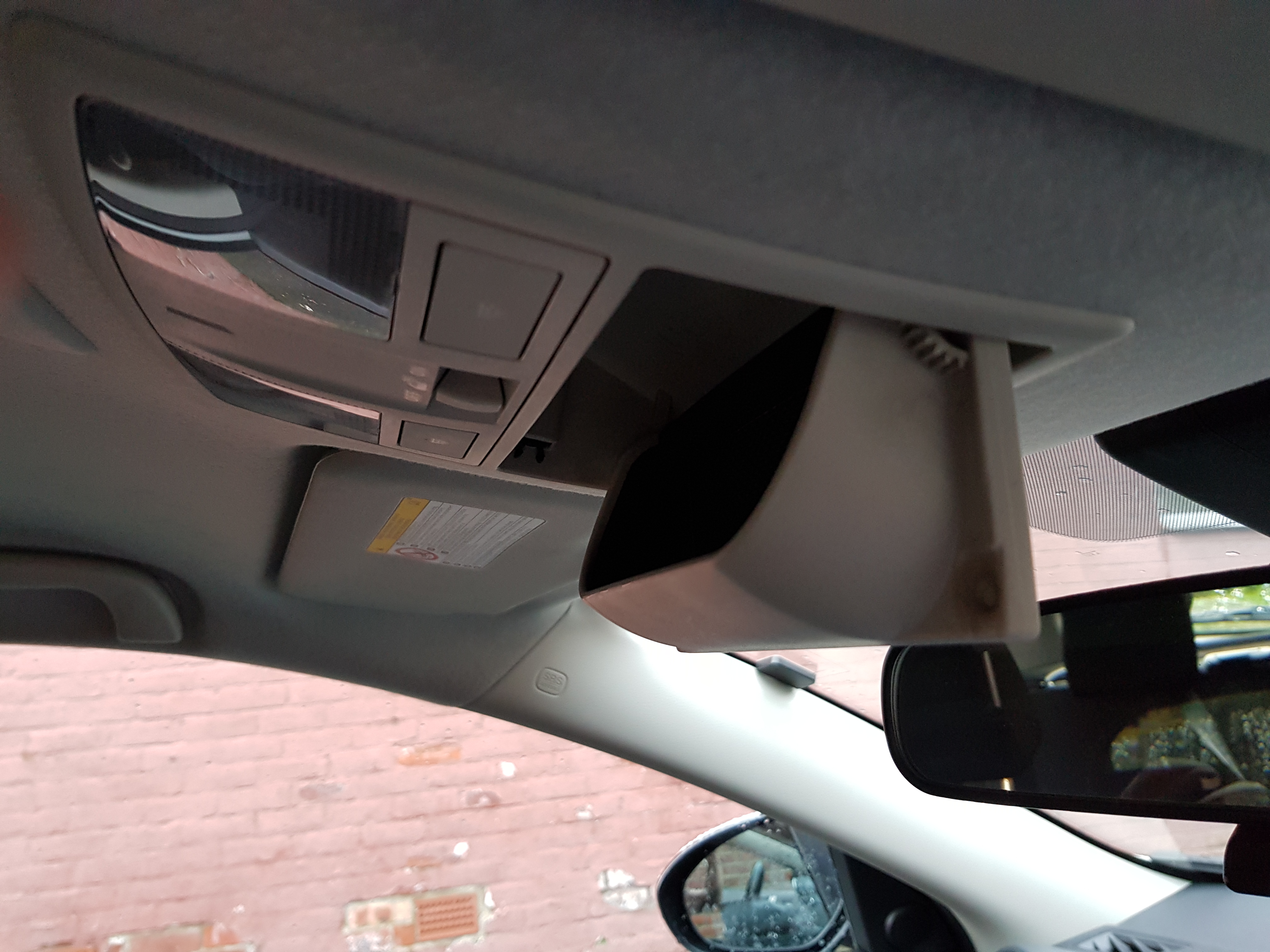

They don't have to be huge, a c shaped/bucket plastic flap just big enough for glasses and a 90 degree hinge out of the panel. To be honest I was just thinking of the roof unit in mine.
Obviously it's lined with anti scratch material and flush with the roof once shut.
