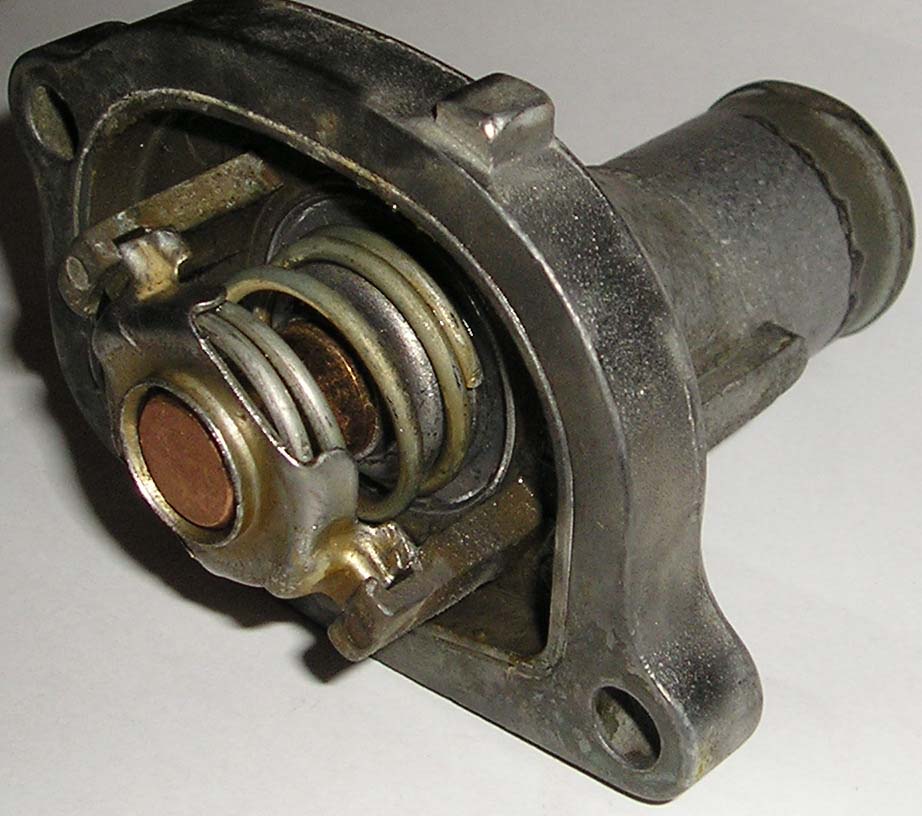

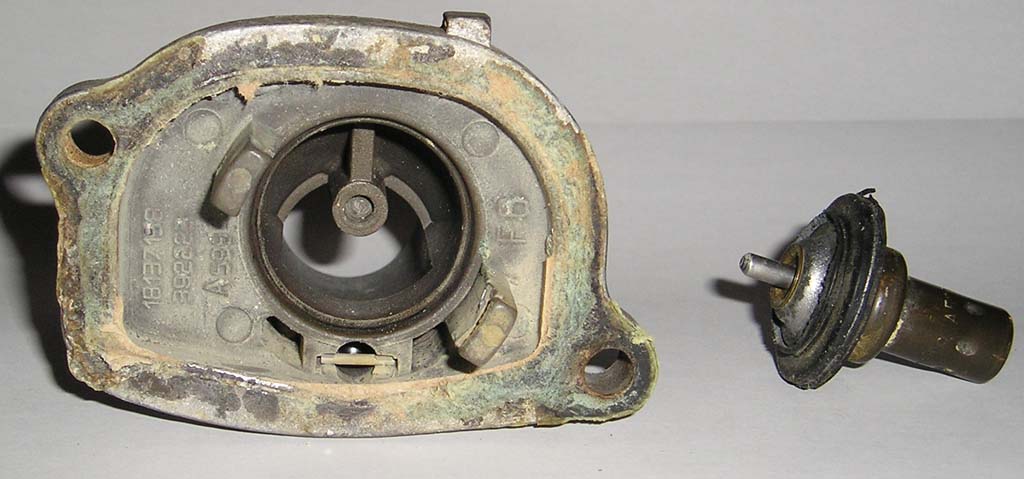

Spurred on by the weekend's hot running and this thread, I've had a play myself. Bought the stat listed above (Halfords HTK 602, only a fiver) and took the old stat of Spare Engine 2 in the garage. The stat comes apart fairly easily, shown below are the parts from the Cinqy stat and the new one:
A is the new thermostat which has been cut to get the guts out (God Bless the Dremel!)
1 is the new stat spring
2 is the old stat spring
X is the old stat innards
Y is the new stat innards
Housing - if you can't work that out...... :rolleyes:
Retainer - holds the innards and spring in. Just press and turn to remove.
Note that this housing is slightly different to Aaron's - it's a genuine Fiat one (not sure if Aaron's was or not).
In true "I can do science, me" style I found a thermometer in the garage and started fiddling. The standard thermostat innard X has a large rubber seat, which sits inside the recess you can see in the housing. It needs to move quite a long way before it will allow a reasonable flow, as it needs to come all the way out of the recess - about 1/8" approx.
I found out how these beasties work in the process of doing all this. If you look at X and Y above, they have a pin sticking out one end. What happens when they get hot is that the pin pushes out, and against the spring tension the innards move back, lifting the stat off it's seat.
The results of my experiments (I didn't have an Igor to assist me, unfortunately) are as follows:
Using the standard stat, things just start to move at 85'c. Bear in mind though that it'll have to get hotter than this to get the thing properly out of it's seat.
Using parts 1 and Y, things don't start moving until 89'c - this I thought wierd as it's an 82'c donor stat.
Using parts 2 and Y (had to open out the end of the spring just slightly to allow it to seat on the new innards) things start to open at 87'c - I tried this as I thought the new spring felt like it was under a lot of tension. Still too high for an 82'c stat though.
Finally sussed the problem. The pin on Y is shorter than that on X, so it needs to get hotter and extend more before it can move off it's seat. Solution - chuck something down the hole for it to sit on. Using the lovely Dremel again, I chopped the head off a small self tapper (approx. 2mm thick) and carefully placed it in the hole. Thermostat still closes properly, but the result now - it starts to lift off it's seat at 82'c. Bingo!
This stat may well control better than the standard Fiat one too, as it just seats nicely around the hole, not inside it - so when it opens it should flow more straight away.
Just need to fit it and see now :)

Here are two better photos of the housing units I have, again first one from 1108 Punto 55 Engine and the second one from a 1242 Punto 60 engine. There is cleary a different in the length of the pin on each of the thermo units, I am just wondering whether the 82 thermo we have bought will fit directly into the 1242 Putno 60 thermo housing without modifications. I think I will have to be trying that and see what happens.
David

It's all a bit confusing this stuff. I started off looking for a Bravo or Punto 1.2 16v stat, as the Haynes manuals say the 16v one opens earlier than the Cento. Guess what - they're the same part number according to the Fiat parts CD and Halfords data books!
David - Try to figure out how much gap you've got between the end of the pin and the end of the hole it goes into. Ideally there should be none, but the stat should be seated closed when assembled. I can test it for you if you like, I guess me egg pan is buggered now anyway!

I`ve stripped down the thermo from my 1242 and the pin is also shorter than the one in your 1108 thermo,
Maybe the 1242 thermo is the one to use?
Cheers
Adrian
I have put the new 82 Thermo into the 1242 housing and it works a treat, dunno the operating temps yet (waiting on thermometer). But I had the standard 1108 thermo and the new 82 thermo in the same pan when I was testing them, and the new 82 thermo opened sometime before the standard 1108 one did. So fingers crossed when I test them with a Thermometer they will be ok.
I tried both springs, the one from the 1242 thermo and the one that came with the new 82 thermo, I found that the spring supplied with the 82 thermo allowed the thermo unit to open just before the standard the 1108 thermo did. So I changed the spring to the one supplied with the 1242 thermo, I found that the this allowed the 82 thermo unit to open quite a bit before the standard 1108 thermo did, a bigger gap between than in the first instance (spring from the 82 thermo)
