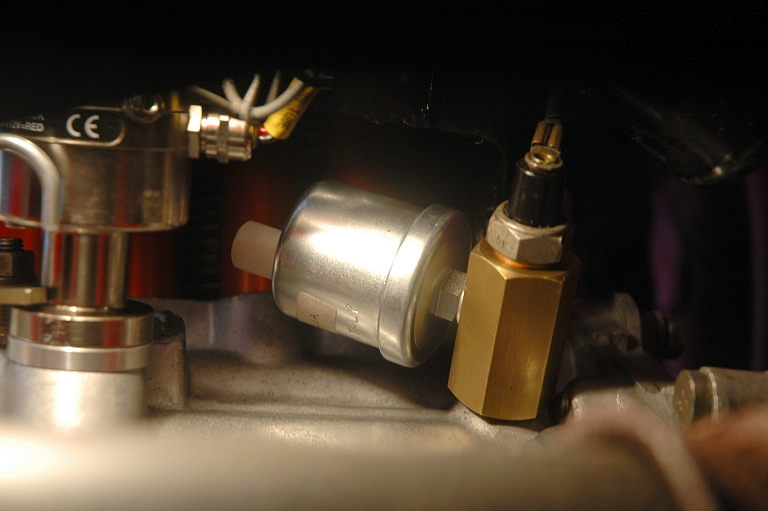

Hi Chris, I seem to recall seeing somewhere a picture of an oil pressure sender you had fitted to your car. Can't see it in this thread but am sure it was you? Anyway, as I recall it was a hollow hex that I assume was threaded male at one end for going into the block and female at the other to take the regular switch, and then drilled and tapped to take the sender unit at 90 degrees to the switch. Does that sound right? If so, did you buy the part or make it?
Cheers Roger
Roger,
Yes it was me and your description is perfect. I got it from Mr Fiat in the US.
I've attached the best photo that I can, taken from below, given all of the bits and pieces that are now in the way. I found that I had to use the correct number of copper gaskets so that when the hexagonal mount was tightened the sender didn't foul on the crankcase.
Chris
