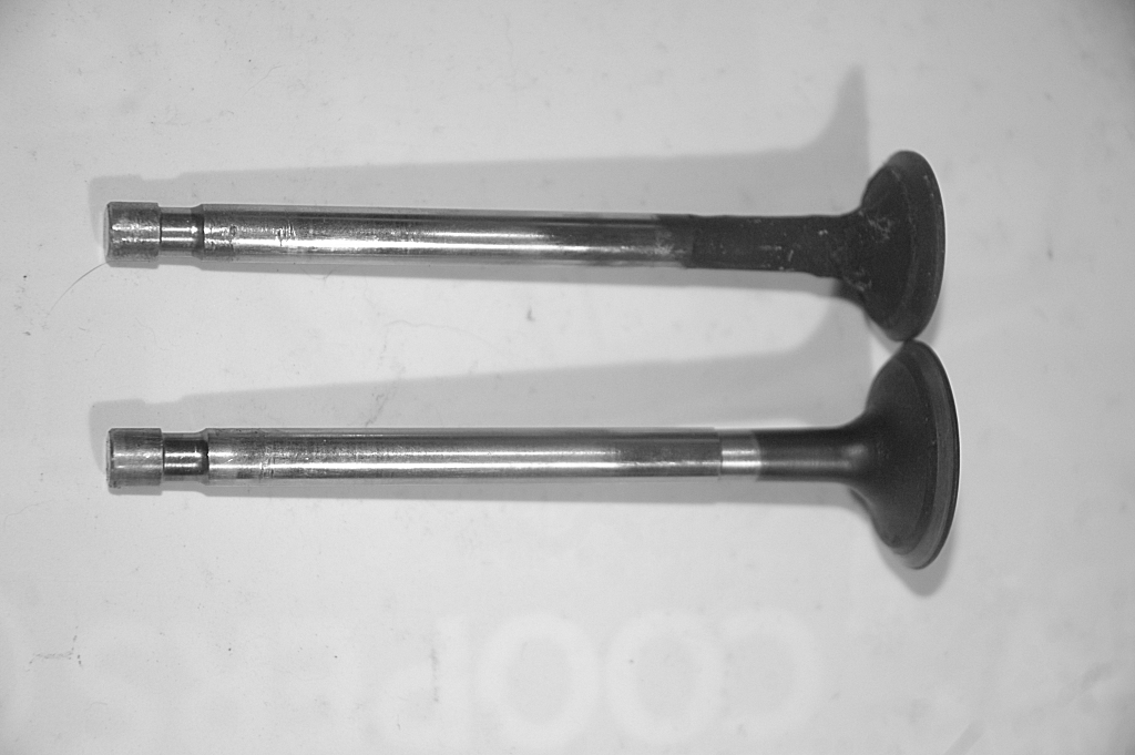

on the subject of replacement valves I was wondering if you could answer a stupid question? While browsing sites I noticed, as well as the valve size; 33, 36 etc and what must be the length there is a measurement of 7 or 8mm which I'm presuming is the diameter of the valve stem. I had thought 8mm would be standard for the 650 engine but I see measurements of both 7 and 8 mm listed on various sites for both fiat 500 and 126. I was wondering what was the difference and which would be usable for a 650 engine.
Regards,
Colm.
Colm,
The standard valves on a 650cc engine are 28mm (exhaust) and 33mm (intake) and both have 8mm stems and are also the same length (115mm).
I've attached a photo of the ones I pulled out of an old 650cc head to show the detail at the top of the valve stem as well.
Chris
