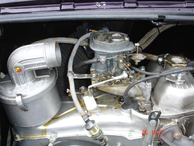

Have you looked at the Weber 30DIC. It's a twin throat downdraft carburettor which, with some modification, will fit, though I've not done it myself. I've attached a photo - it looks like a tight fit with not much room for an air filter ....

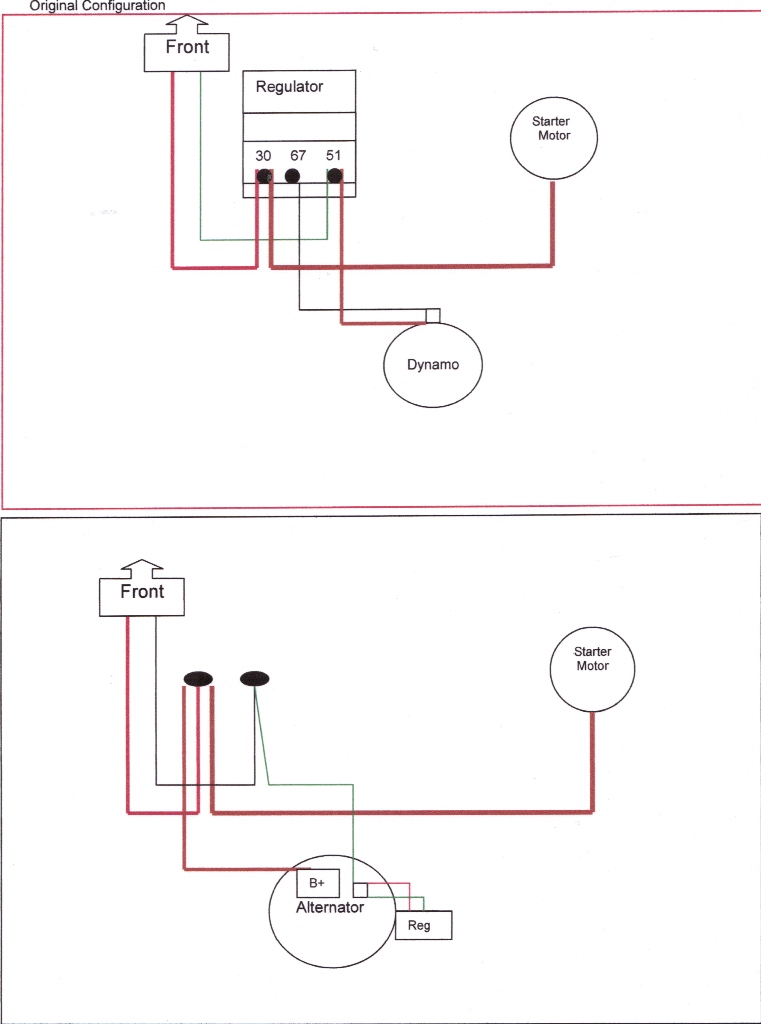

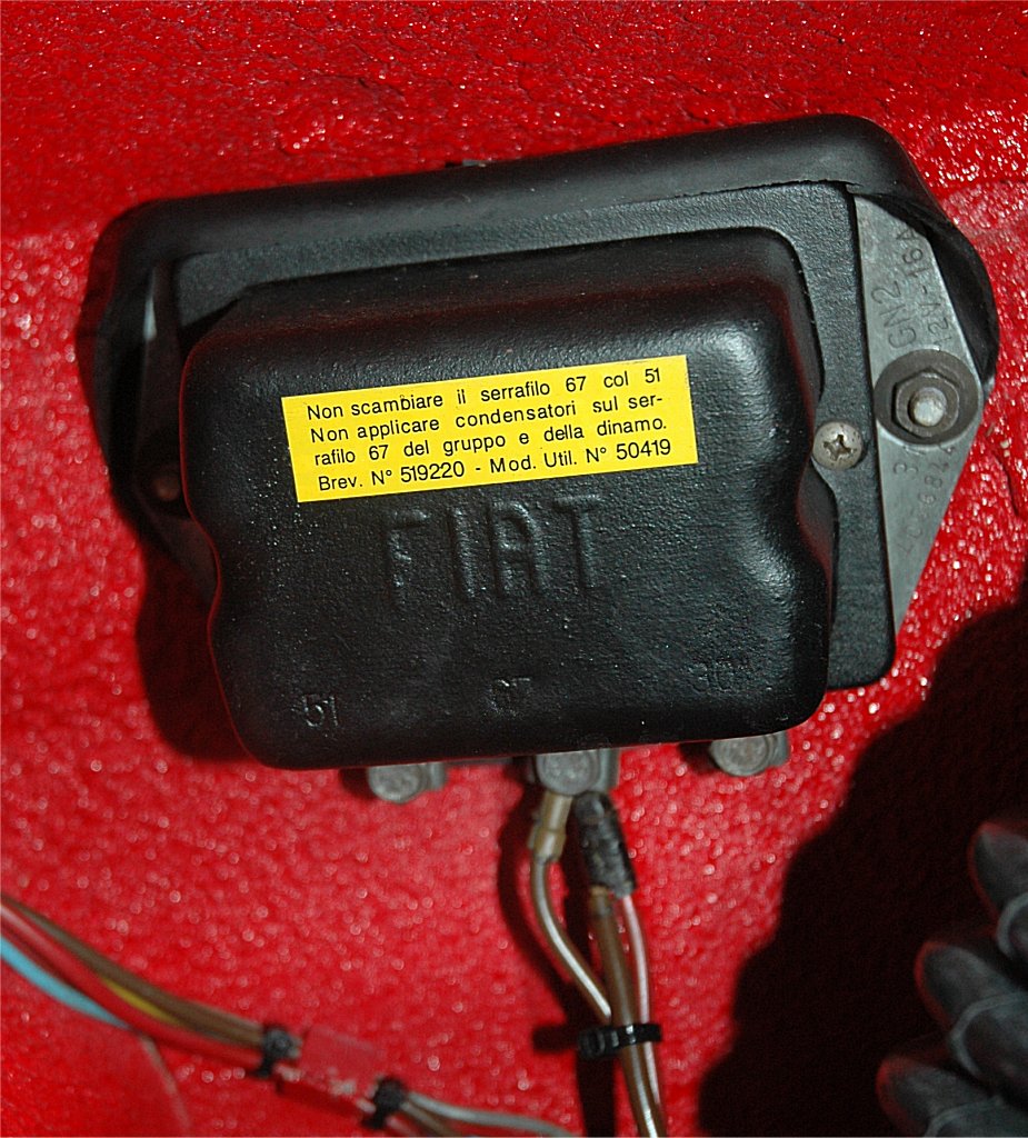

Thanks for the quick responses and useful info. I'm going to look for a 125 ignition switch. I usually get my stuff from Mrfiat.com but they don't carry it. Do you know of any place I can get one? I may tinker with rigging up the pull lever to a button that would activate the solenoid but I would like to have the ignition switch on hand in case that doesn't pan out. I think I read a post somewhere about someone doing this but now that I'm doing the upgrade I have been unable to find that post or any info. Also, is the electrical control box still necessary with the 650 motor and if so does it get wired to the new motor the same way?

Thanks again. I'll see if mrfiat.com has that part number in stock (I realized when I emailed them I asked for a 126 starter and not a 125 so that might have been the problem) The wiring diagram should be very helpful and is greatly appreciated. I should be in good shape when the engine arrives.

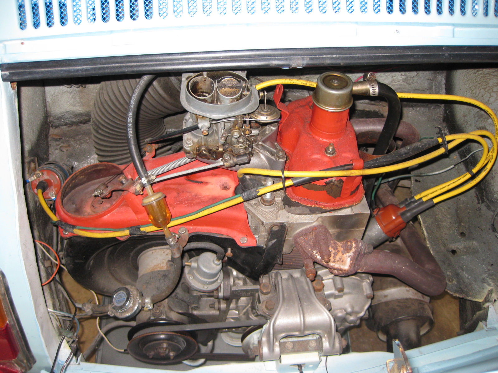

As far as the one poster who Bambino mentioned a weber 30 to, I can say it is very tight with the Panda head and the weber30DGF I have. Mine even had a spacer between the carb an intake manifold making it even tighter than the picture Bambino posted.
