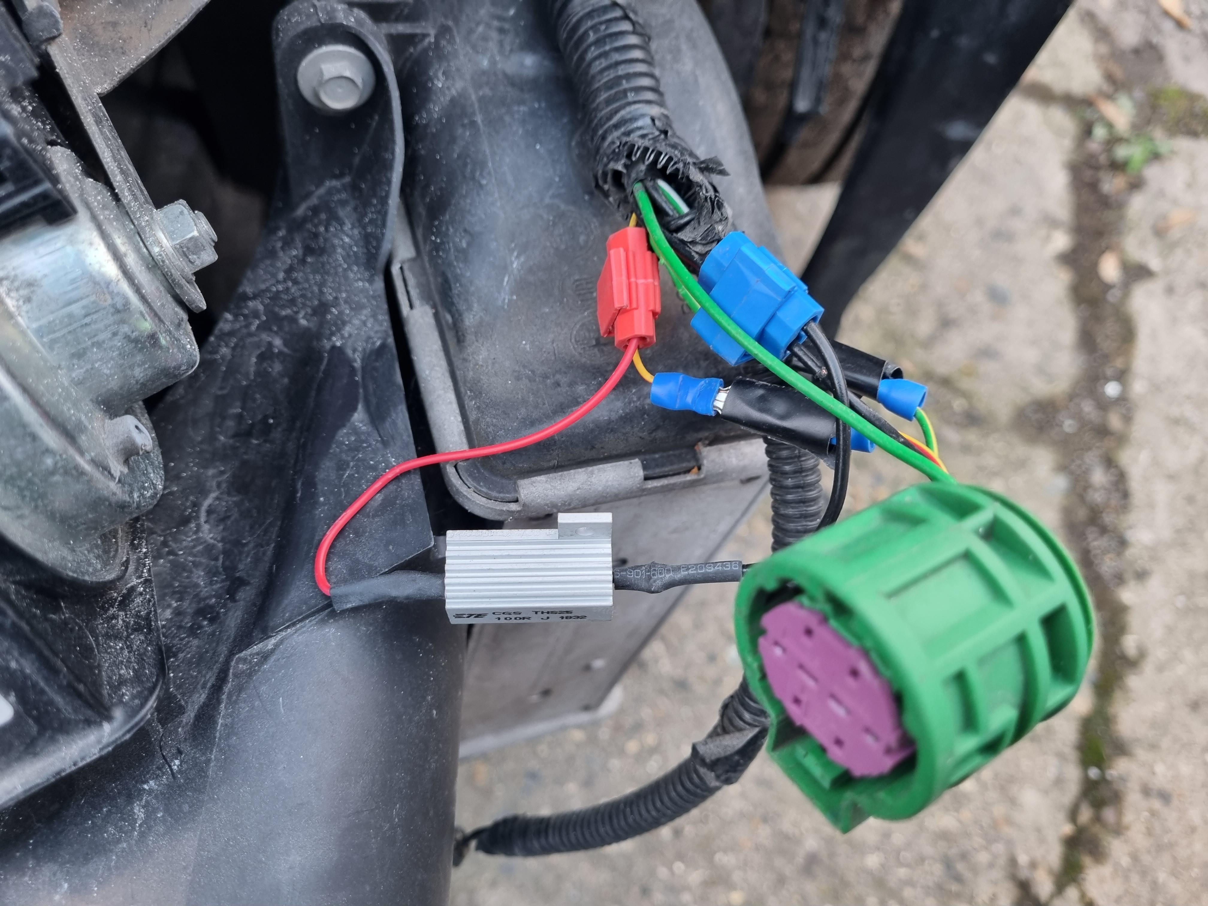

This is a picture of the driver´s side, isn´t it?
It´s not nice in regards of realization, but basically it should work if you have installed the resistor between the yellow/red and the black cable. The only thing is, in mine the cable is only yellow and not yellow/red but this is perhaps due to the fact mine is a Mk.2 model.
I really wonder, because in a other forum, a guy who installed on each left and right side a 56 Ohm resistor, said that the dash doesn´t throw an error, even if no lamp is connected....
