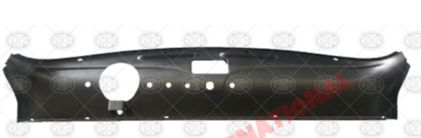

500F Panel:-

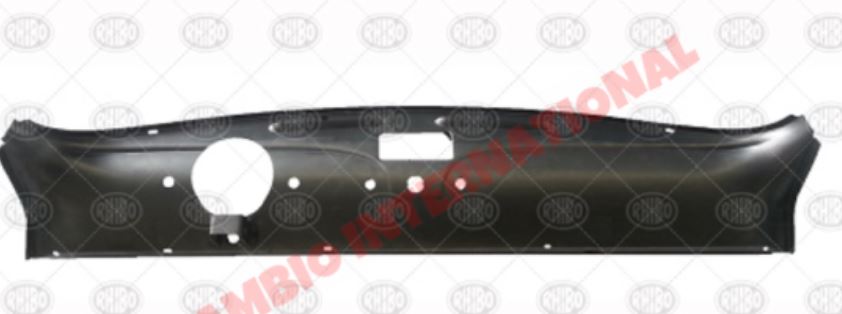

500R Panel:-

500F Panel:-
500R Panel:-

The additional hole is for the unnecessary switch for the internal light of the speedometer; it looks like Fiat recognised the superfluous nature of that switch. I can't confirm, but I would put money on it, that this is the only difference.
I would retain that hole depite it not being original. You could fit an original switch or light in the hole and use it for another purpose. On my car it operates an intermittent-wiper system.
The later "F"s and, (I suspect), the "R"s didn't even use the large, central hole because the ignition switch was transferred to the side of the steering column, which allowed a lock to be fitted; the hole was closed with a blanking-plate.
I hardwired my speedo lights to come on whenever my lights were on and repurposed the hole for a hazard light switch. Highly recommended.

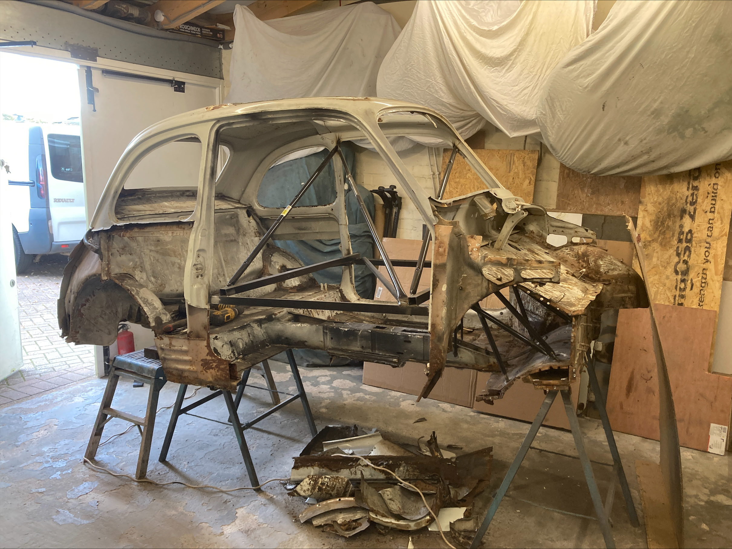

Thanks for the info. I think I'll go ahead with the F dash panel then. Welding a little hole up is nothing in scheme of things when the bodyshell currently looks like this and is getting smaller and lighter every day until it goes for shotblasting...

Thanks for the info. I think I'll go ahead with the F dash panel then. Welding a little hole up is nothing in scheme of things when the bodyshell currently looks like this and is getting smaller and lighter every day until it goes for shotblasting...View attachment 430108
When I was less aware of these things I once welded over the central hole where the early models have the ignition lock. Being used to the later cars that have a column-switch, I assumed that someone had retrofitted a switch or light and I wanted it original. That car is still around and I bet it still sports the de-holed dash-panel.
That's a deep restoration that you're bravely facing; I love the bracing-frame. I think we deserve a big write-up and more photos. ;)
