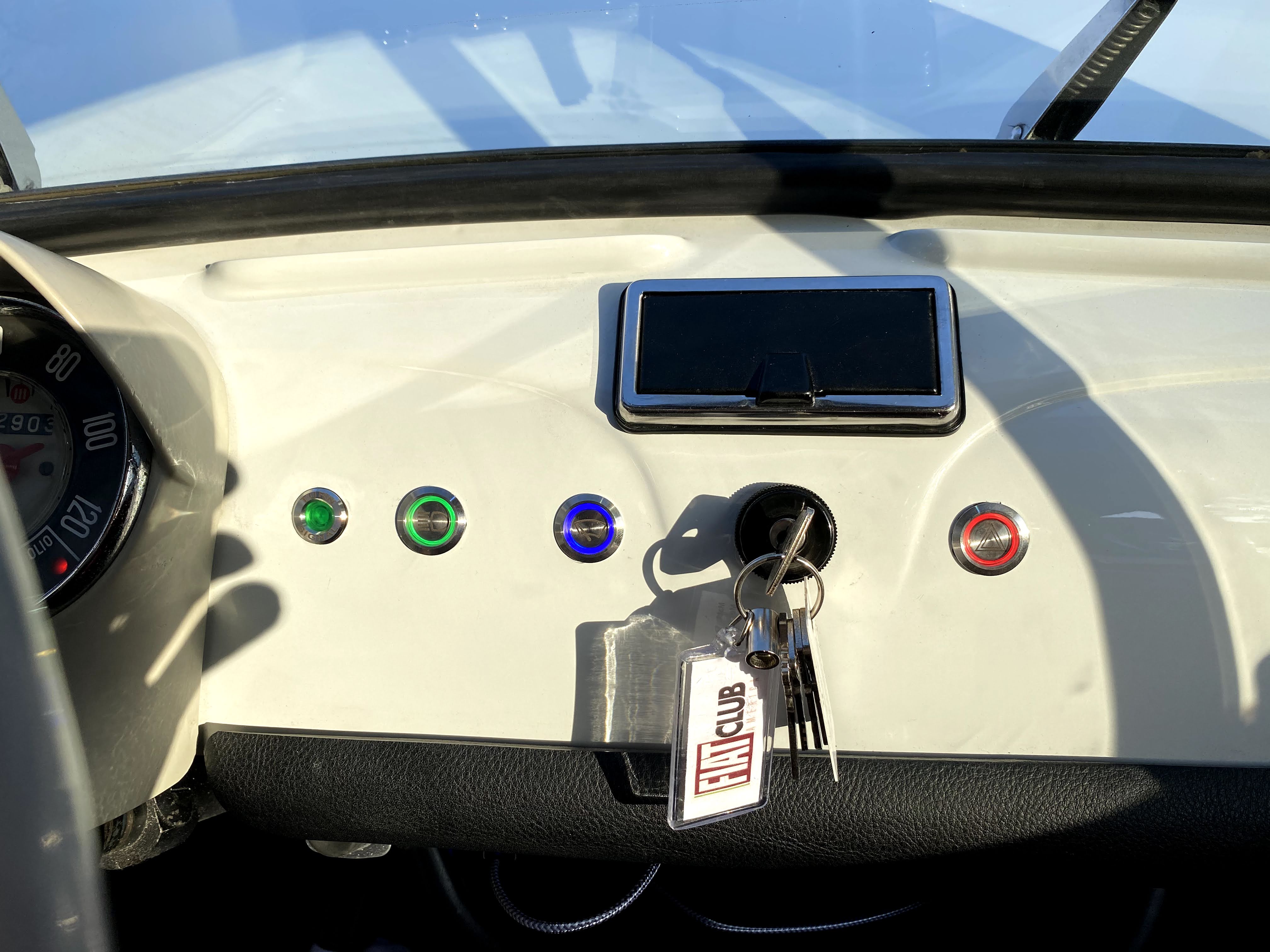

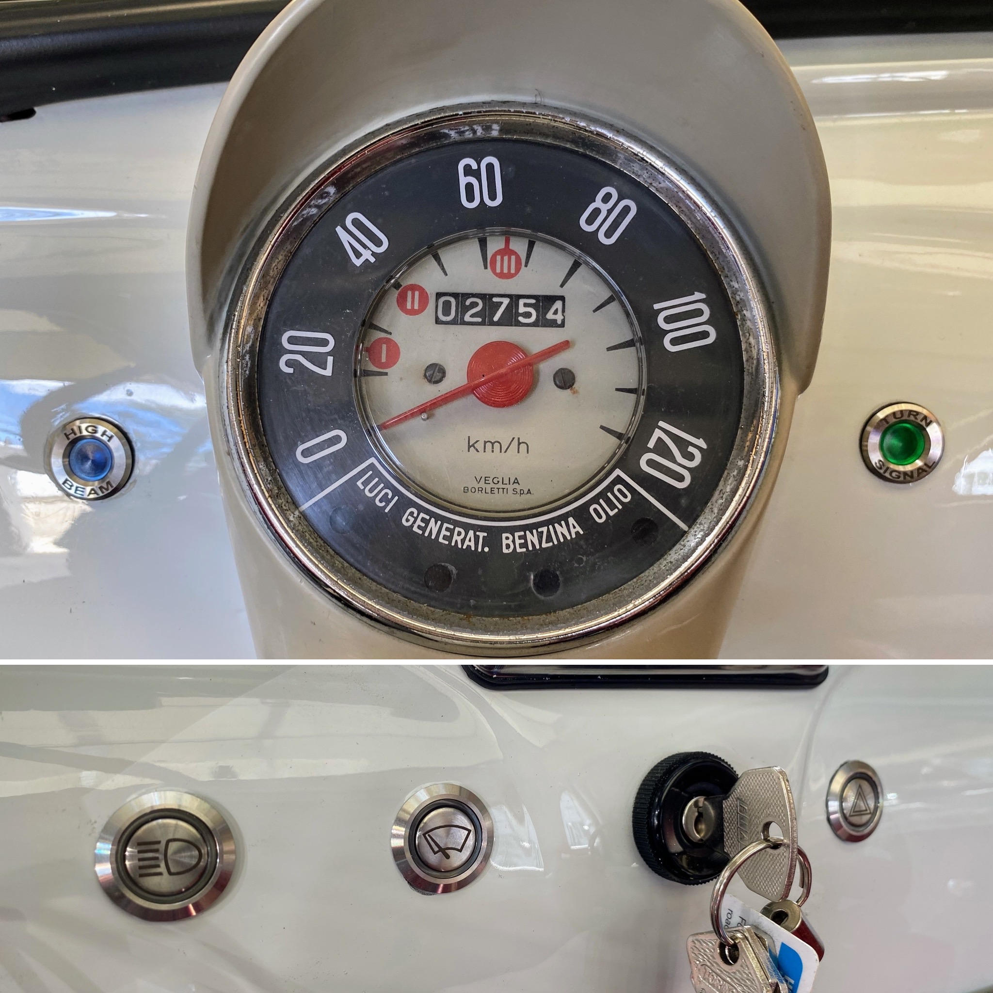

While the weather is still crappy, one of the projects I'm undertaking on little Martina is some button modernization (in this style) and incorporation of hazard lights. I didn't want to go with one of those aftermarket bulky add-on kits - I wanted to make it a clean, 'supposed to be there' look. To that end, I decided DIY was the only way to go. Since I didn't want to drill an extra hole in the dash, I decided to remove the speedo light switch and hardwire that bulb to the lights themselves. Seems silly to have an independent switch for instrument lighting.
Anyhow... after much research and planning, it's done! Sorta. I'm still waiting on my dash switches in the mail, but the hazards themselves work as intended. Here's the video of the initial op check:

Quick sneak peak at the new switches and lights. I’ll post a video a little later showing the lighting functions, but want to wait till I get a replacement turn indicator light; this one is burnt out it seems.

Well, the turn signal LED was bad, here’s a video nonetheless. Just imagine that incandescent is a green LED that says “TURN SIGNAL” around it. Thankfully, that’s the easiest to get to with the gas tank installed, so it should be a quick fix when the replacement arrives.

Chris - they are from https://billetautomotivebuttons.com/
I used 19mm buttons and 16mm pilot lights.

Alright alright alright. I got the replacement LED for the turn signal, so the new setup is complete. Pics and videos below

Buttons and lights are all from BilletAutomotiveButtons in Australia. Great customer service and fair prices. When I had a burned out turn signal LED, I told them on a Sunday and a replacement was in the post on Monday.
