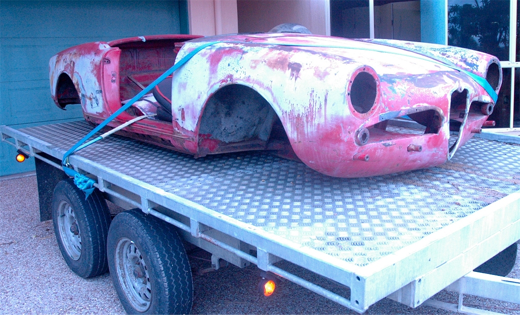

Mine is an early 1957 Giulietta Spider - I've attached a photo of the stripped shell on its way to the local restorer. It needs a lot of work but it is restorable. An SS would be great, but their prices are approaching stratospheric. I know where there is a completely restored SS shell in the US but the owner wants a very large amount of cash for it. Guess we could always win Lotto :)

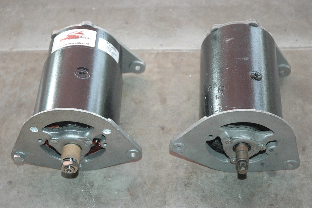

I got my Dynalite from Holden Vintage & Classic (www.holden.co.uk) and it is a replacement for a Lucas type generator. I'm not sure if they do Marelli cases, though I guess you could ask.
My old 500F generator is 245mm long and 93mm in diameter. It is a DSV 90 whereas you will need a D 90 for your car. The housing must be different.
Finally, I intend to fit the standard pulley on my Alfa Dynalite. I'm told that so long as it is rotating at about 1.5x engine speed, the charge rate will be OK.

One problem I can see is that Dynalites have a minimum diameter of 100mm which is 10mm too large for the pedestal. Would you be able to measure the case diameter please Chris?
I might use a shorter belt and pack more shims in the pulley to increase the speed- given that the 126 uses the same size pulley we shouldn't be too far away...

Now for the important stuff, my Dynalite is 104.75mm in diameter (4 1/8"). I wasn't aware of a minimum size.

Unfortunately the Giardiniera has a cast in support pedestal in the sump for the generator so size is critical. Buried in the Dynalite site is a statement that 100mm is their minimum diameter offered.
