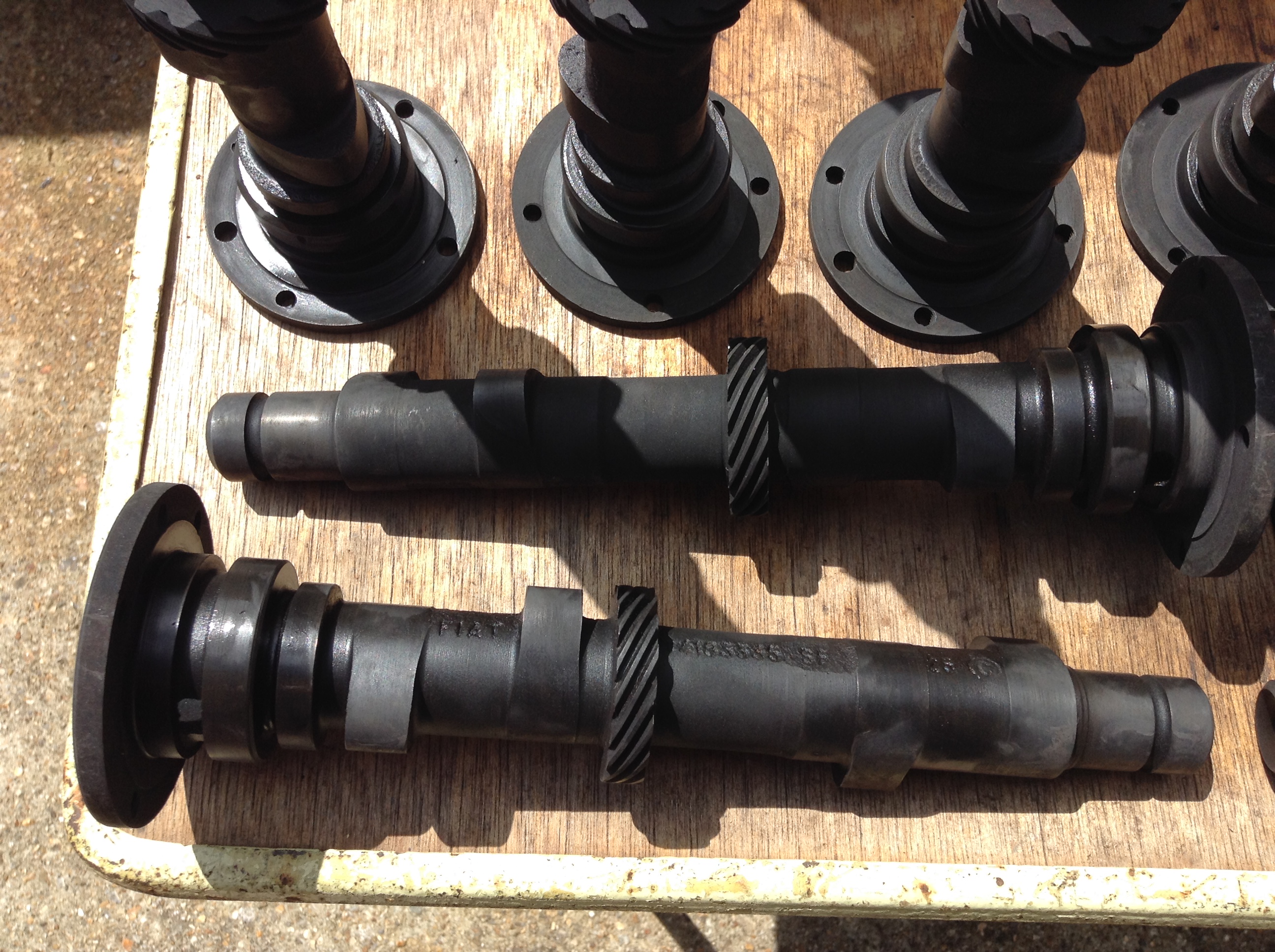

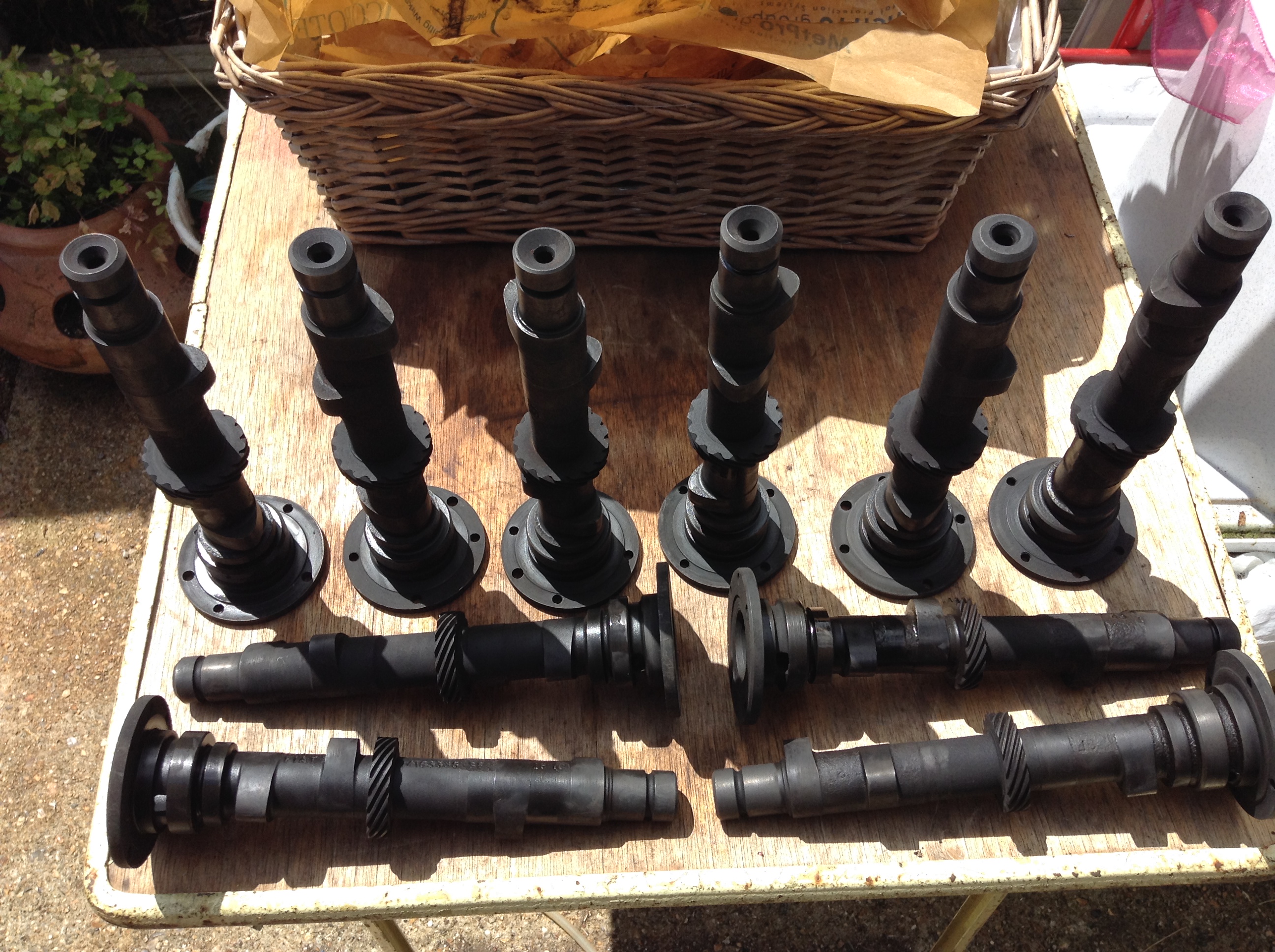

I had experience of camshaft upgrade reprofiling with Newman Cams. As a 126 car club project at a time when hot cams were unaffordable I got together with a pal and we collected as many 500 and 126 cams as we could, rejected a couple but had 17 that we thought were viable. I negotiated with Newman Cams and sent them the whole lot. After inspection they rejected a further three. I then asked them to proceed with a batch of ten. The process involved the regrind to a sport spec then finishing by nitride hardening. At the time we were able to sell them on to club members for about £100, £140 pounds less than those advertised at the time.

View attachment 459520View attachment 459518View attachment 459519
The BIS camshaft will FIT INTO the 120 (Giardiniera_ engine but WONT WORK unless some engineering is carried out. (1) When the BIS cam is fitted into the '120' engine, an electric fuel-pump will be required as the cam-lobe to operate the fuel-pump operating rod on the BIS cam does not align with the postion of the the pump's drive rod in the '120' engine. (2) The centre bore for the oil-pressure valve must be added tothe BIS camshaft. Now, not having been able to put a BIS cam alongside a '120'cam, so that I can see the reason for this, I am not quite sure what that entails.However, if those 2 problems can be overcome, the BIS cam should give better performance than the stock '120' cam.
