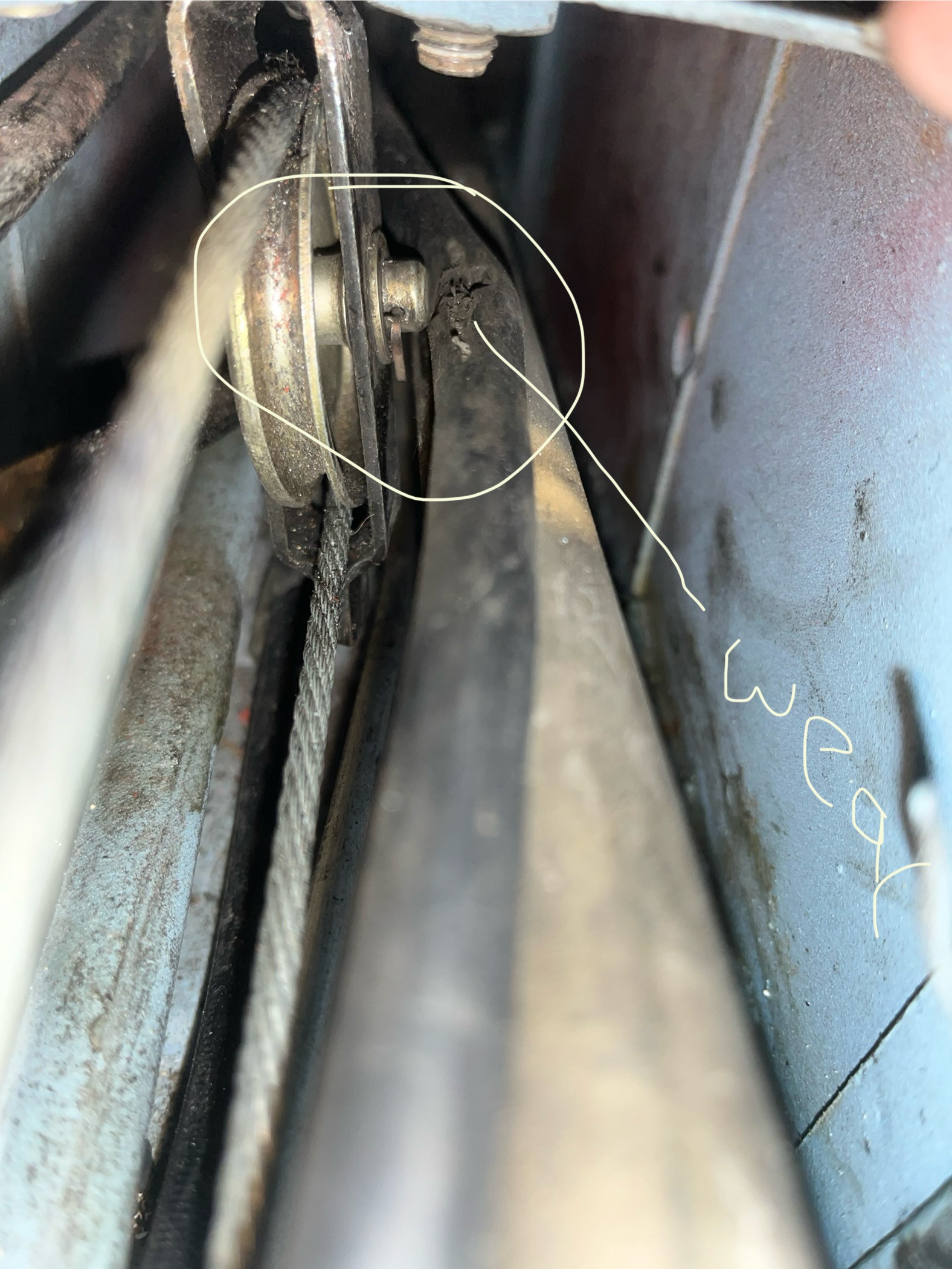

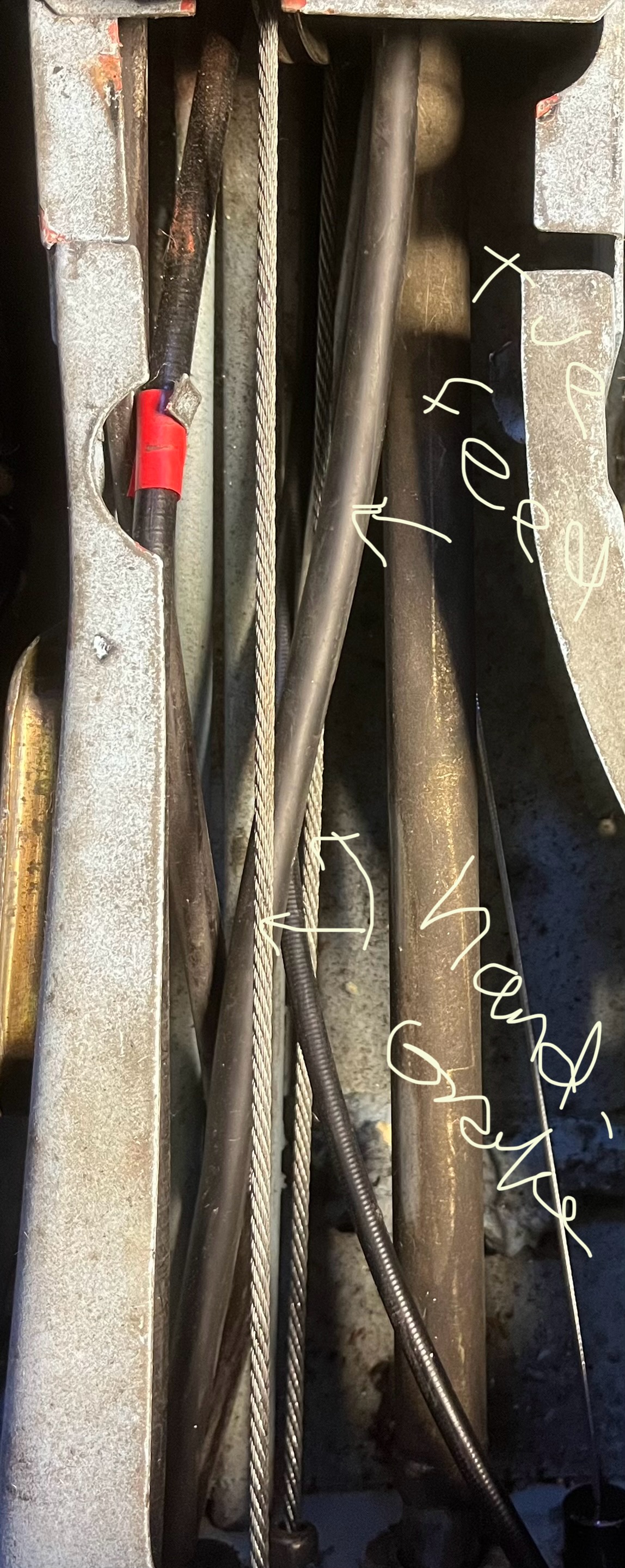

However, as I was putting it all back together, I noticed that in the transmission tunnel, the positive feed from the battery goes across from the entry point to he other side, threading between the handbrake cables and was then catching on the side of the handbrake pulley. Whilst the damage to the rubber may have been caused by me trying to re-tension the handbrake, it looks like it will always be vulnerable to being snagged as the handbrake is applied and released. A couple of years ago, this cable was changed (not by me) as it was shorting in the tunnel and it looks like the same thing will start to happen again very soon.

Secondly, I am wondering if anyone knows how the positive battery cable should route through the tunnel - should it really thread between the handbrake cables and how can I stop it getting caught and wearing? Does anyone have any pictures of a better route when I inevitably have to replace it again?

I’ve added some pics to try to explain the current routing and show the wear on the cable.

Just as an observation, my Giardi never had an earth strap of any sort, I always figured that the substantial engine-to-rear-crossmember anchor was doing the job. Your might want to repair/reinforce the insulation on the starter cable just where it's damaged and then slightly modify the routing to avoid the
rubbing points (which you'd have to do anyway, and cheaper than a replacement).

Thanks both for your replies. A new battery, new starter and new starter cable, plus a slightly shonky repair on the positive battery feed in the tunnel (access was extremely tight, so it’s a bodge of insulating tape, plus a cable tie to try to hold it clear of the handbrake pulley which is full of sharp bits) seems to have more or less worked - it has now started, just in time for the rain to come in to prevent a decent test run 😂
