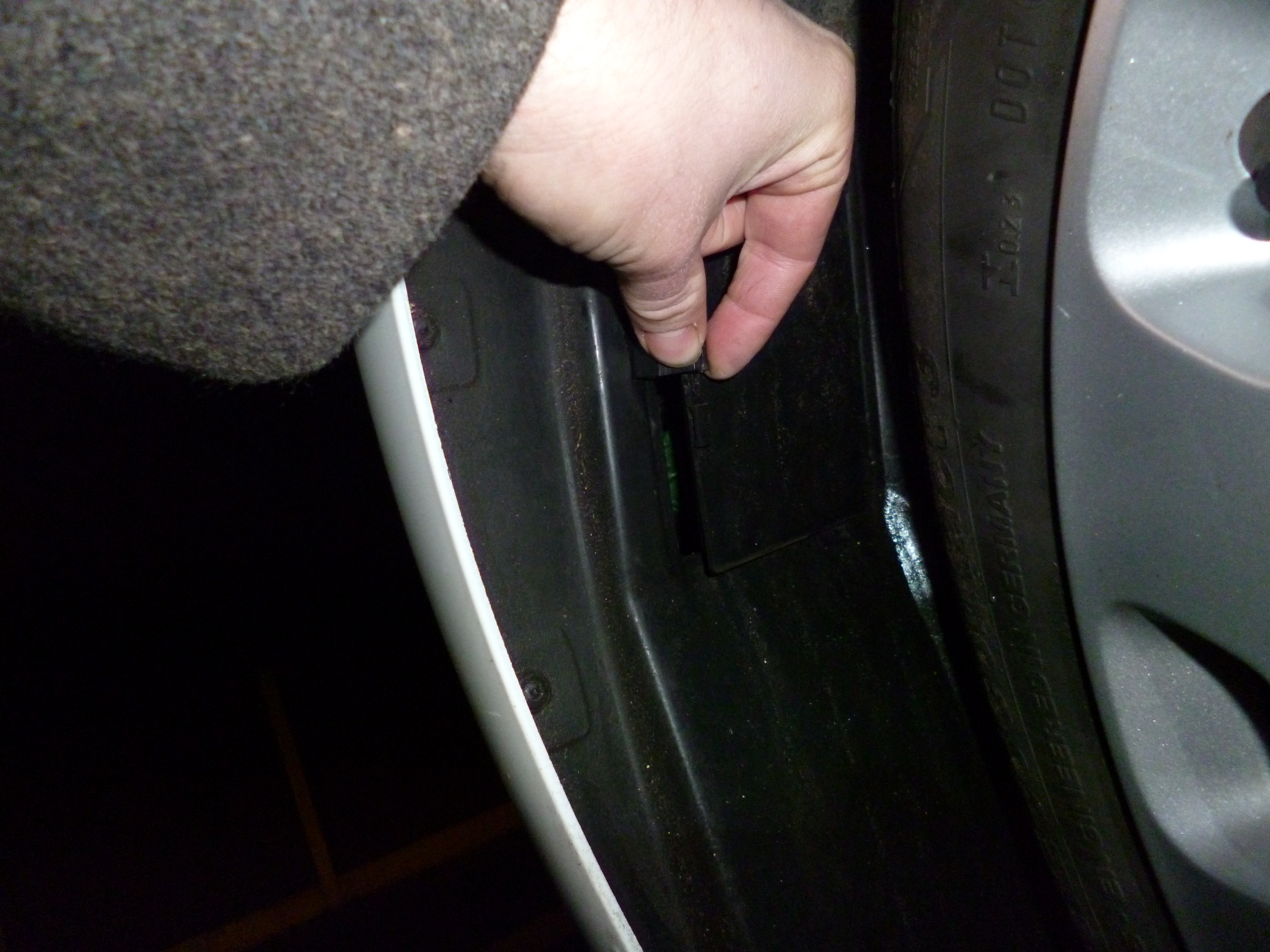

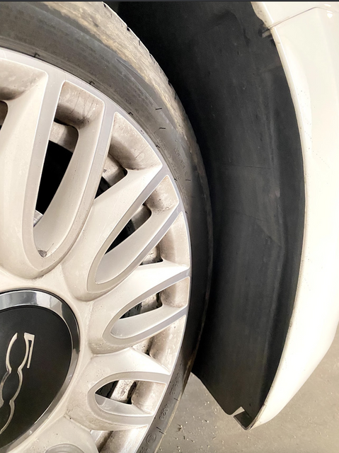

First off turn the front wheels to full lock to make some room...
Next locate the inspection hatch...
Then Remove the cover by nipping the little tabs together and remove the cover....
now locate the rubber cover pull the tab and remove....

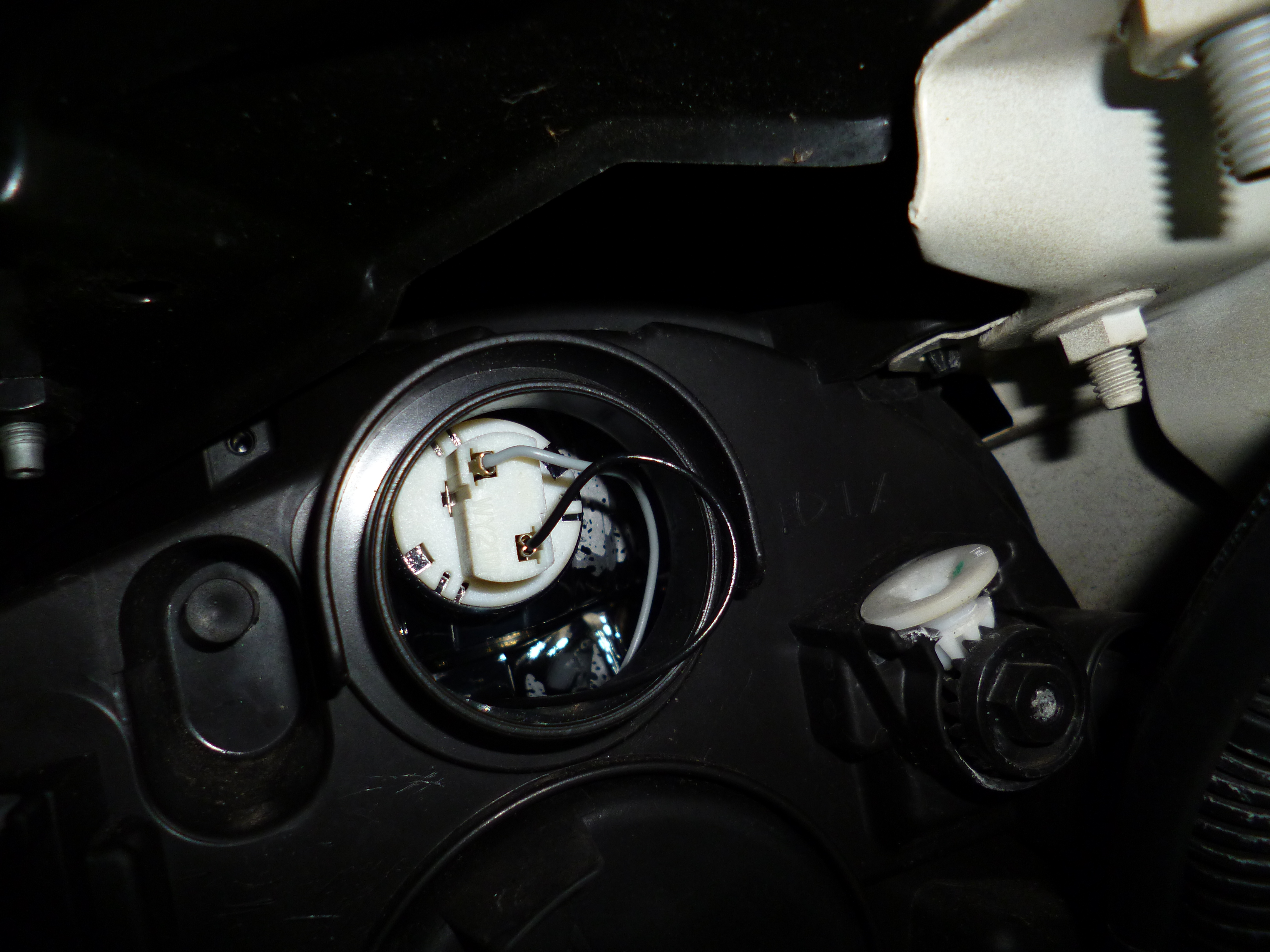

this exposes the back of the bulbs (in this case the DRL/ Parking light (580 bulb) (TOP)

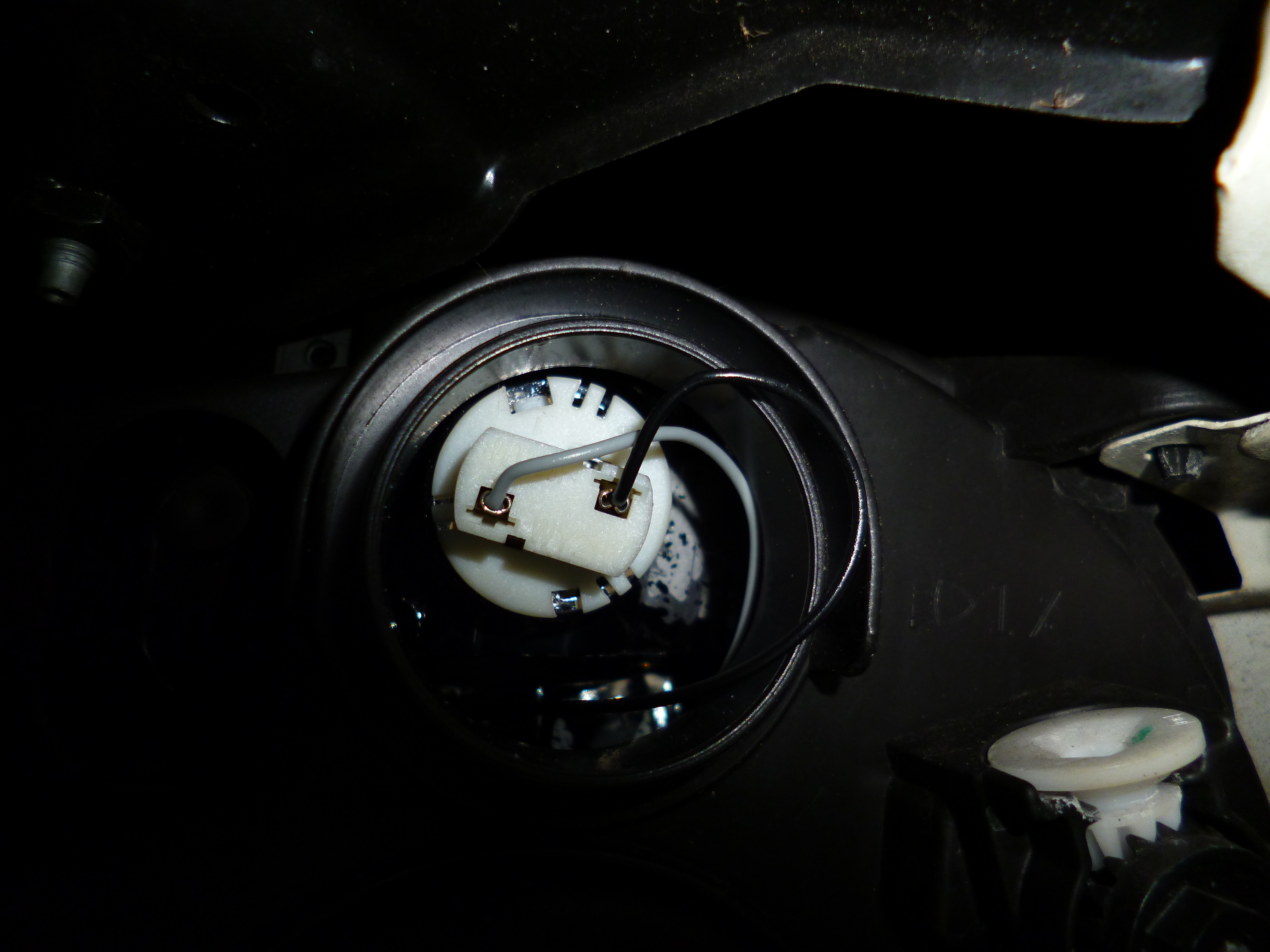

Grip the black plastic i found it easier to get my left hand on it (passenger side and rotate it ANTICLOCKWISE until it stops turning..
Next wiggle and pull the holder outwards this exposes the bulb
THE BULB IS A PUSH FIT ON NO ACCOUNT ATTEMPT TO TWIST OR TURN THE BULB OR IT WILL SHATTER.....
reassemble in reverse order having first checked you have the bulb in the correct way round if the wrong way round the DRL will be dim and the Parking lamp will be bright. so check before fully resembling.....

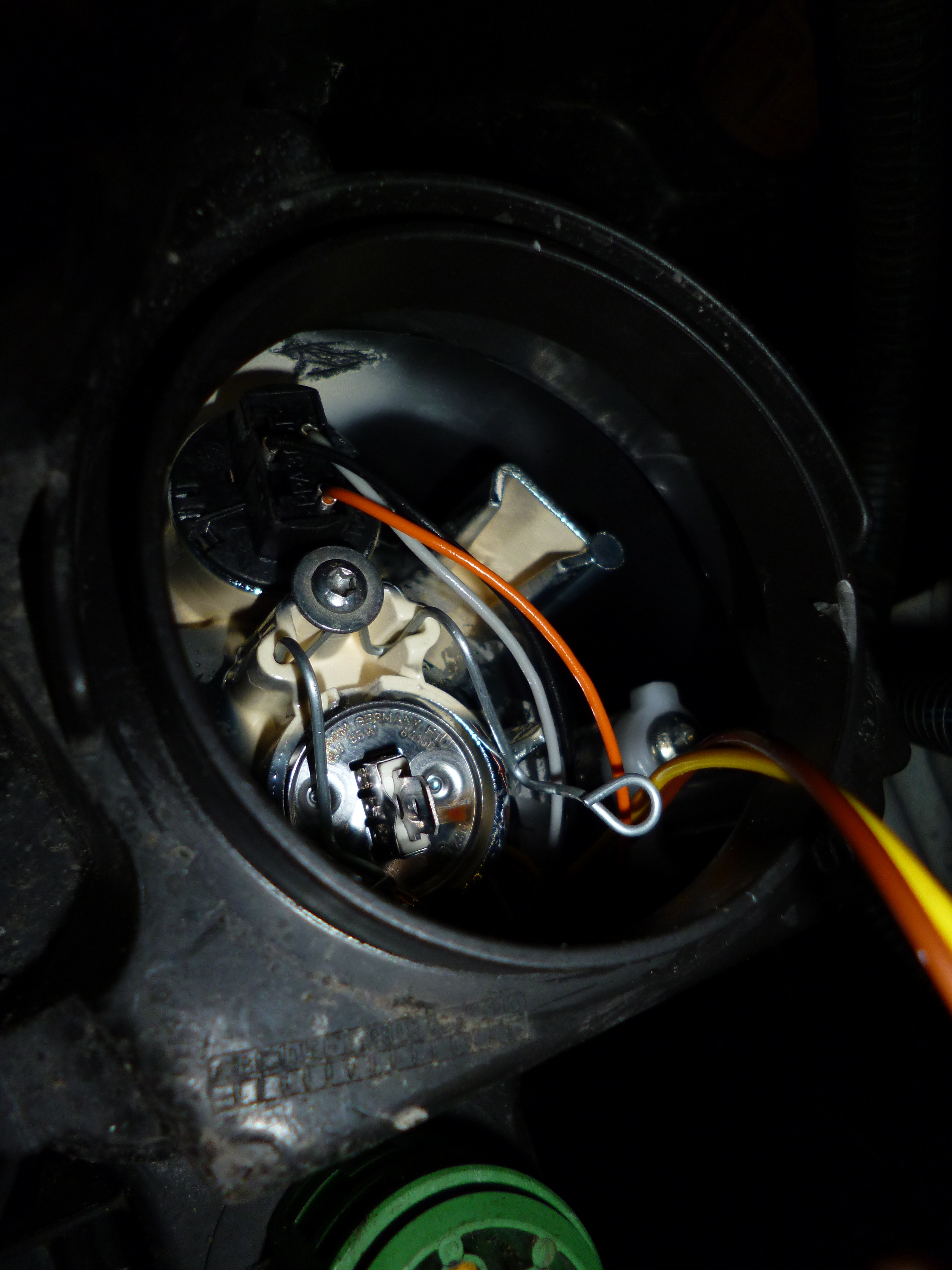

Main beam H1 55w bulb
Follow the guide above to access the back of the bulbs,...

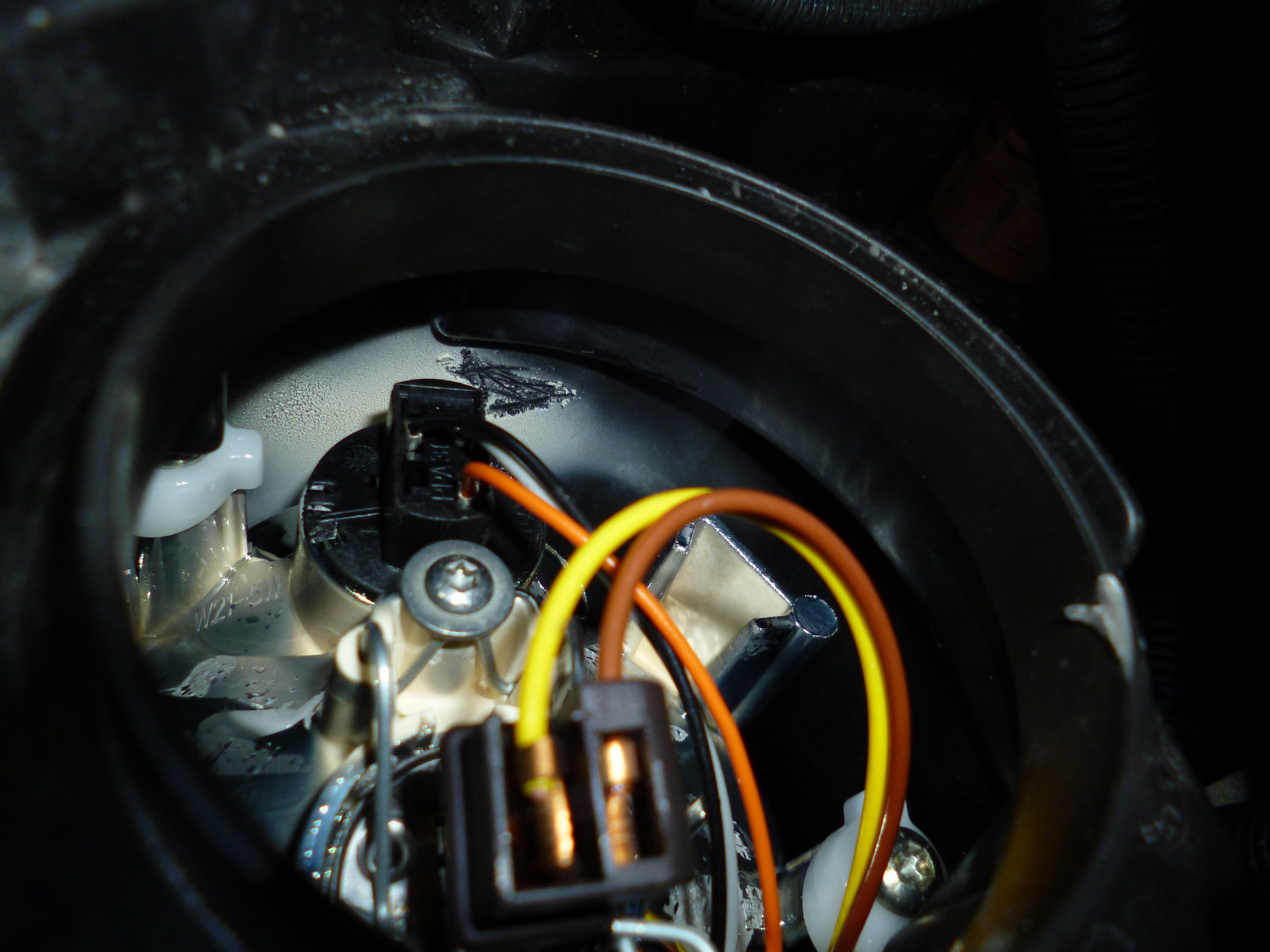

then pull off the connector plug...
then release the 2 spring clips by lifting them away and to the side they will stay there once bent and pushed back slightly...
once the 2 springs are splayed apart carefully pull the bulb out making a mental note of how it sits (it is possible to get it 180 degrees out of line but then it wont sit straight)
then remove the bulb

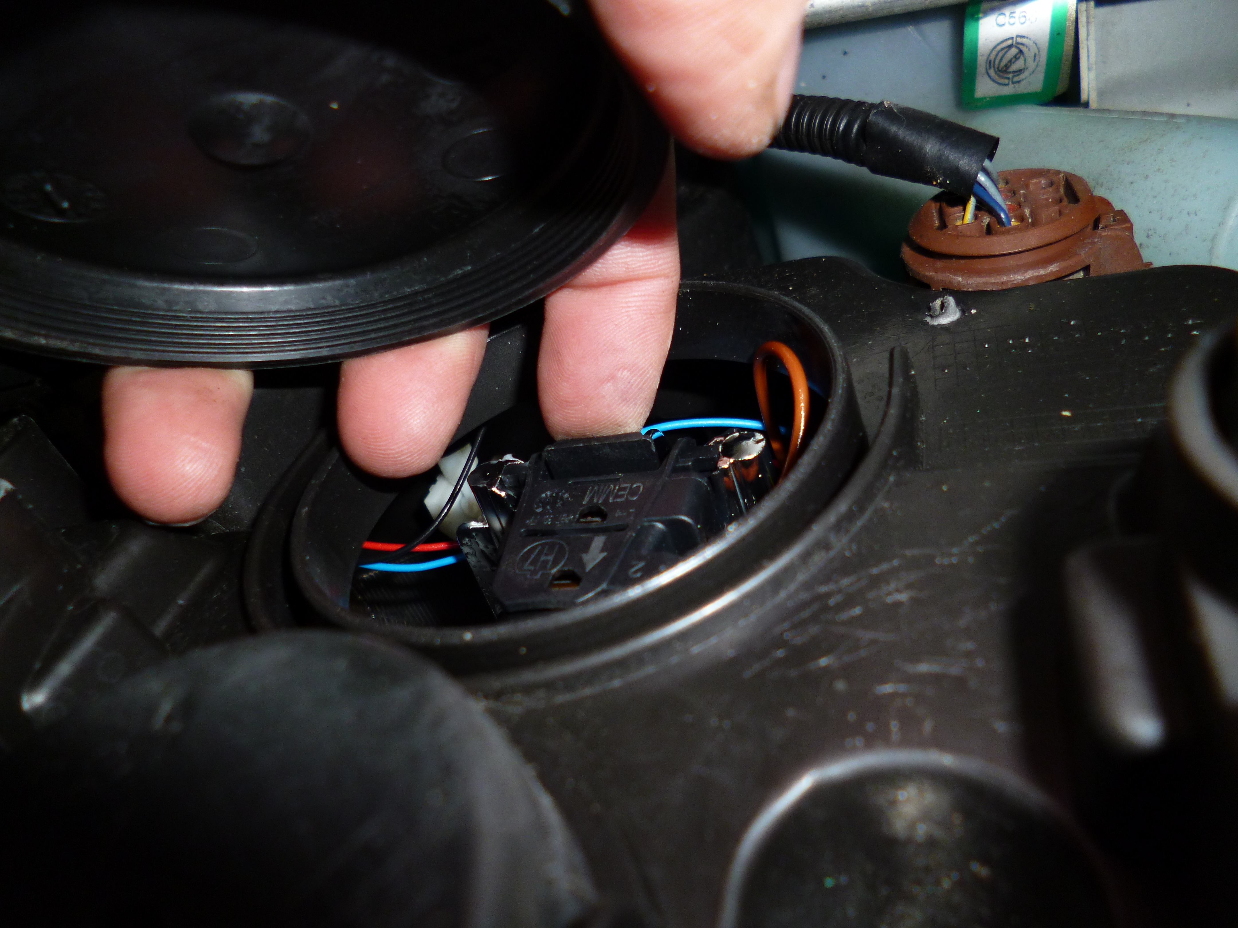

THE HEADLAMP H7 55w
first open bonnet and locate back of headlamp......
but this time remove the larger rubber disc
exposing back of bulb
now press the little tab at the base and pull outwards...
