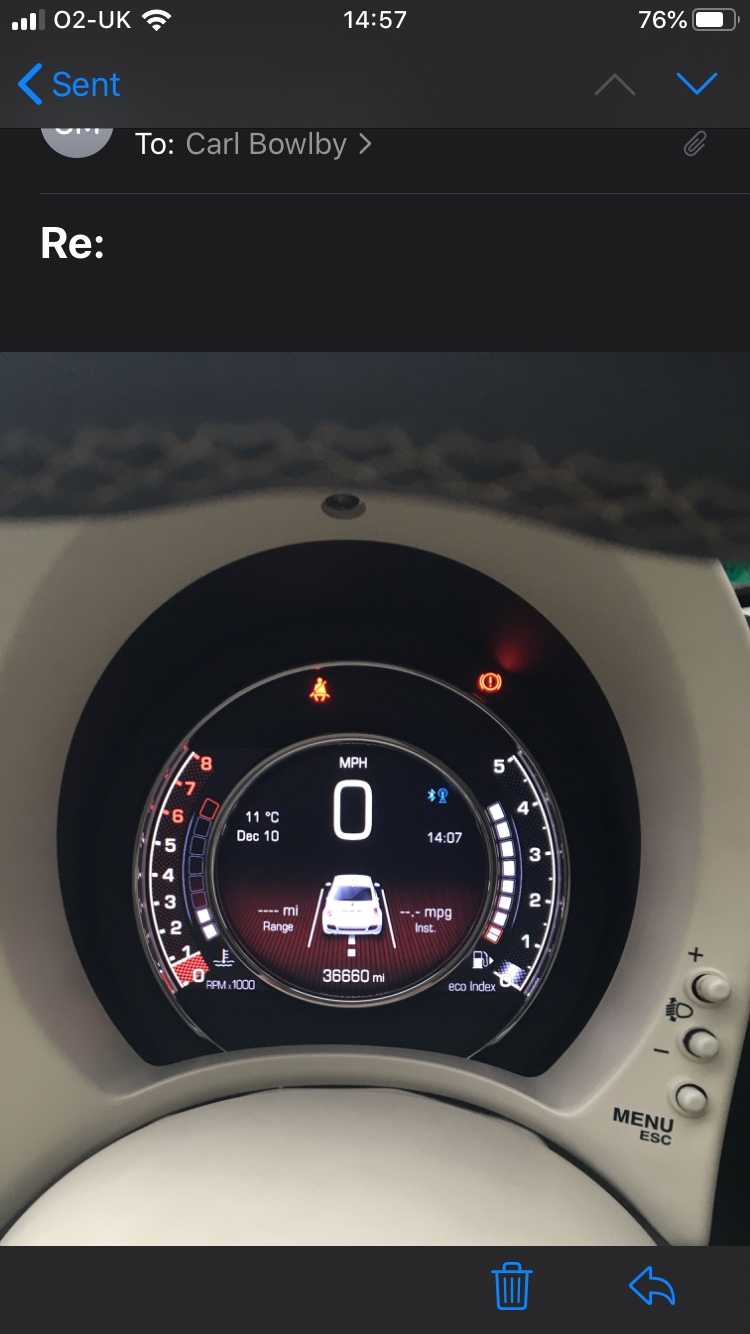

IMG_2736.JPG I upgraded to one of these!!
That looks great, where from and how much? (y)
eBay! I paid 65 just need to keep your eye out... is your car a 2011/12? If so look for a 2014/5 year speedo DO NOT touch a 2016 or older as they are facelift models and won’t work (as I found out) lol I have learned everything from this forum it’s the place to be when we own 500s!!
Just seen one on eBay but for 269£. Think I’ll wait but does look great .
