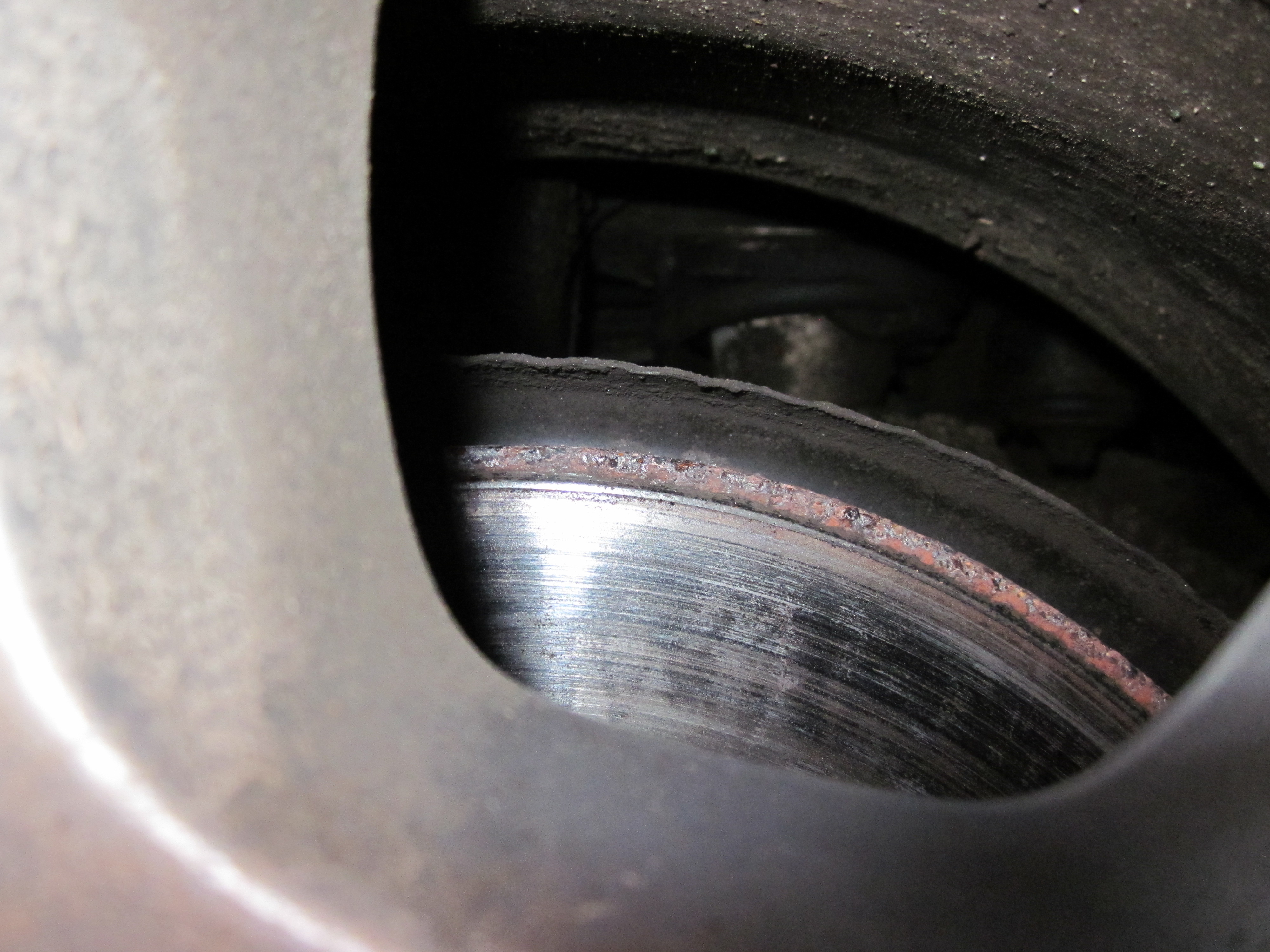

Are these any good?
There's quite a lip there. The braking surface looks smooth though. Just milling the lip off might be enough, all you'd be worried about then is the thickness.
Rear discs do wear as a normal part of their workload. The question remains, is this normal wear for this car?

Are these any good?
Mine look the same. I think this is typical of rear disks. They don't wear away the corrosion as they dont apply anywhere near as hard as the front ones.
If you did want to change them, I just did a check on euro car parts. the have rear disks from £7.79 each, £13.99 for Brembo, and £14.99 for Bosch.
