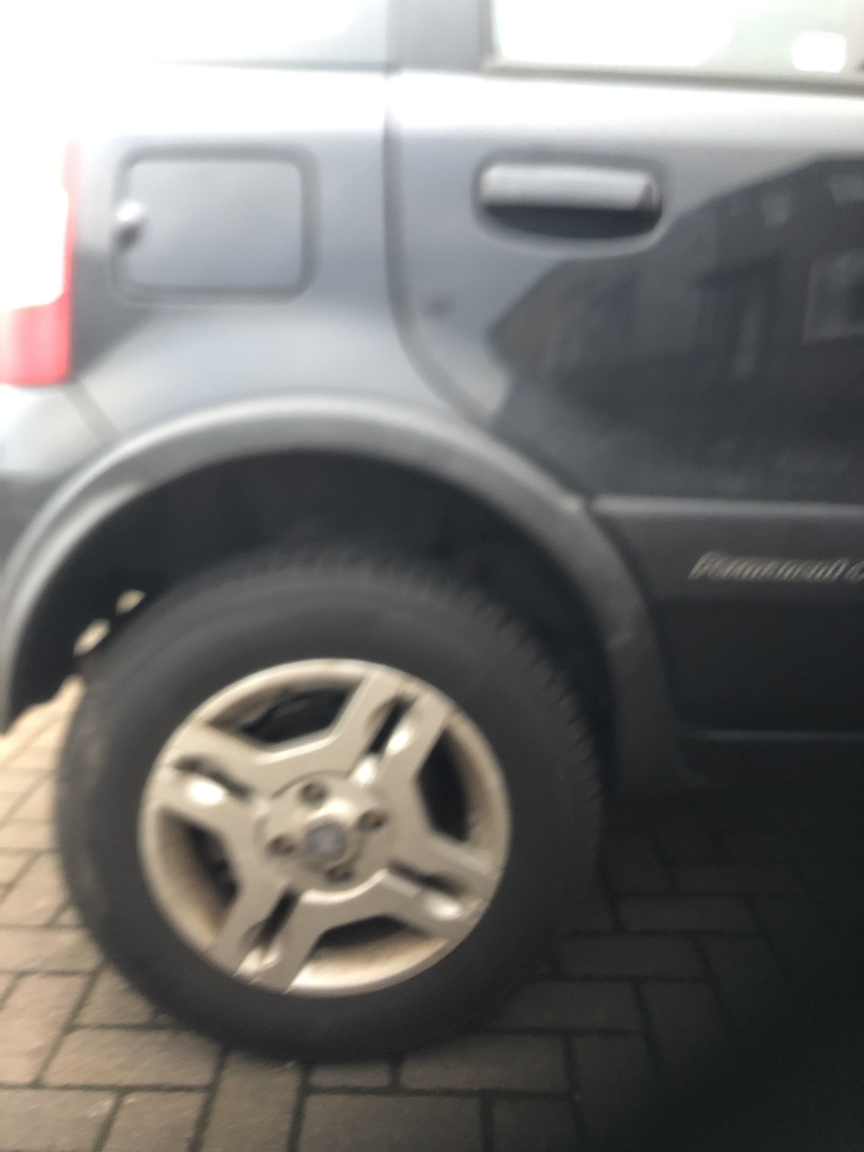

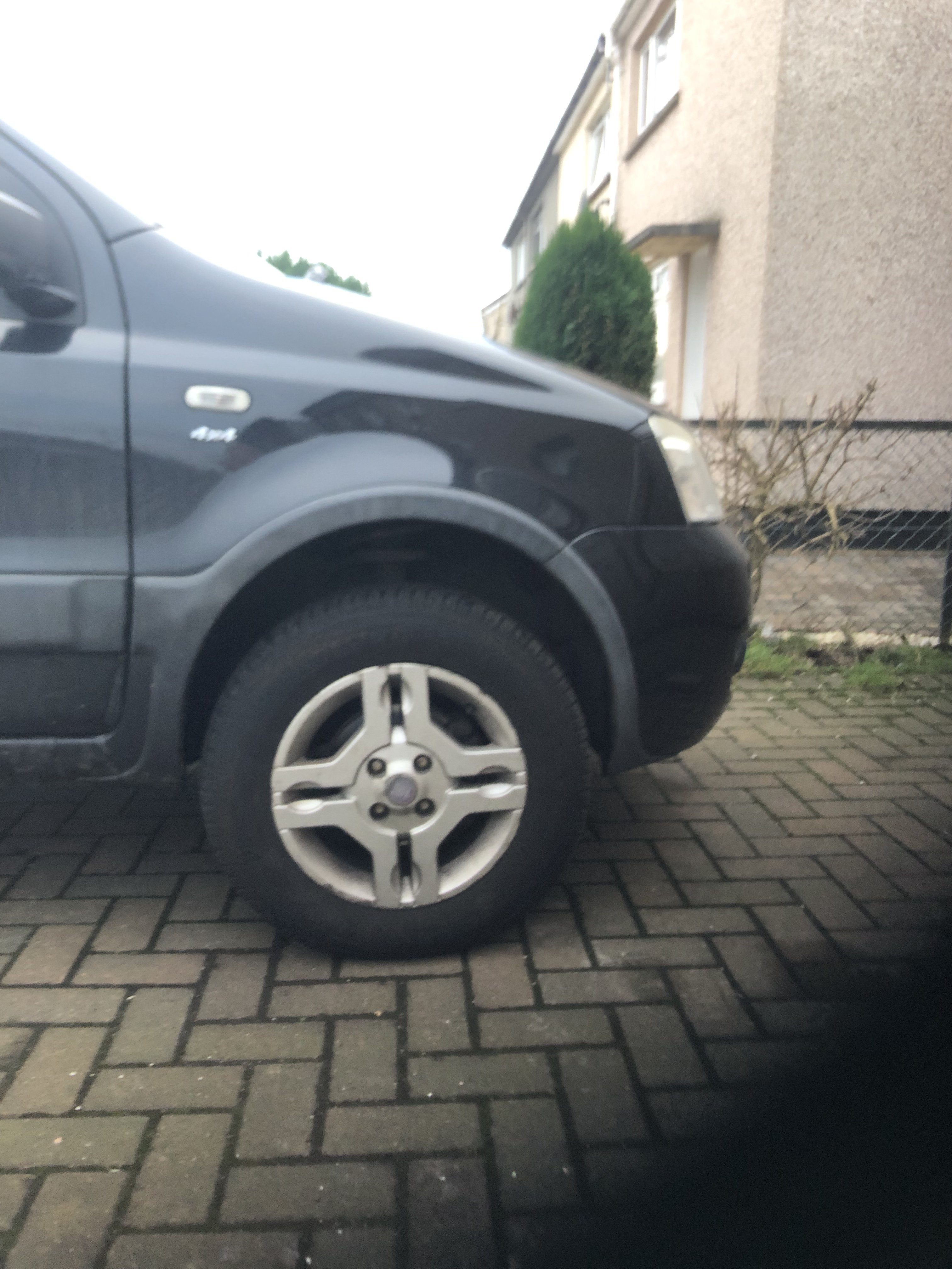

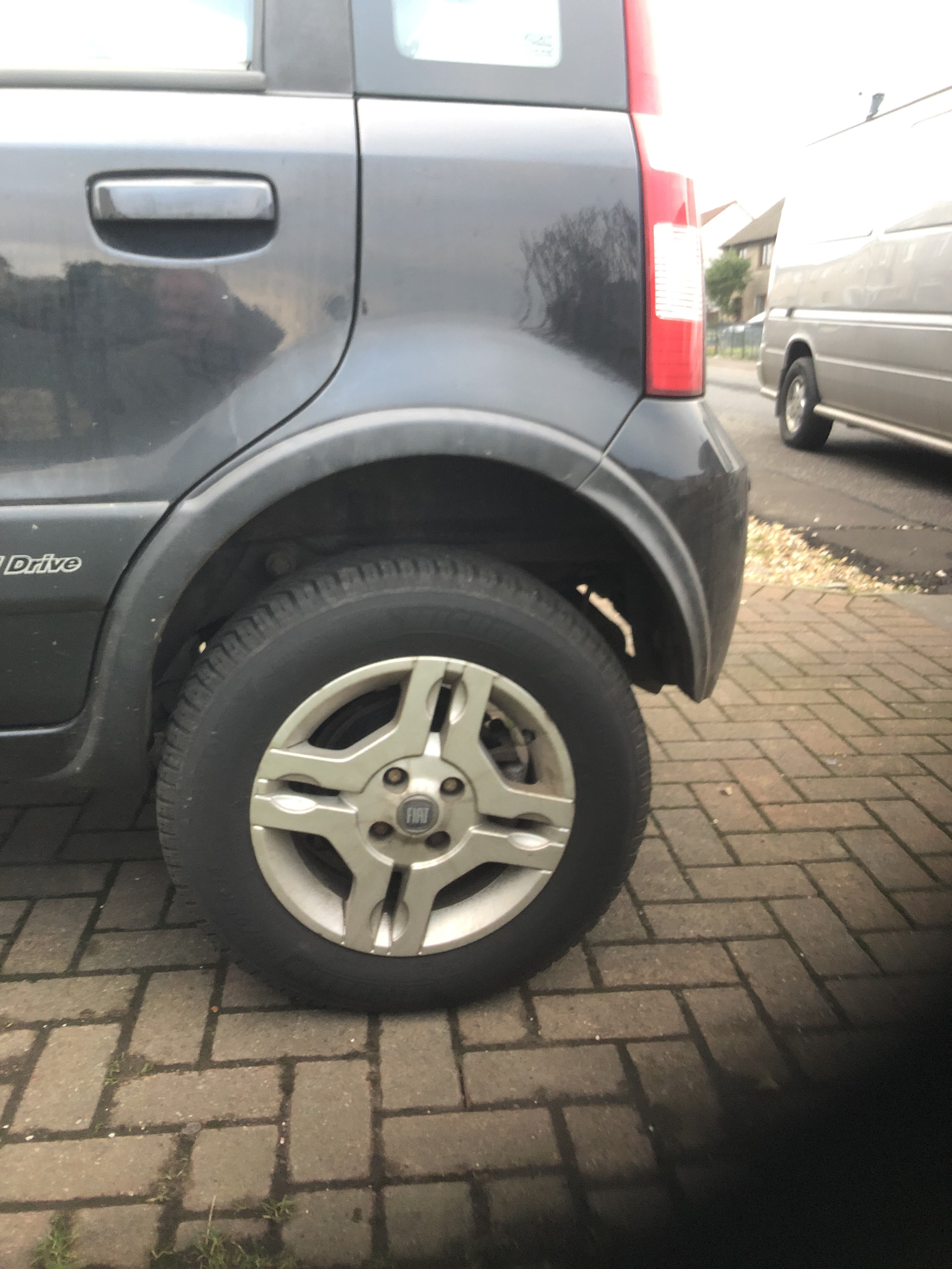

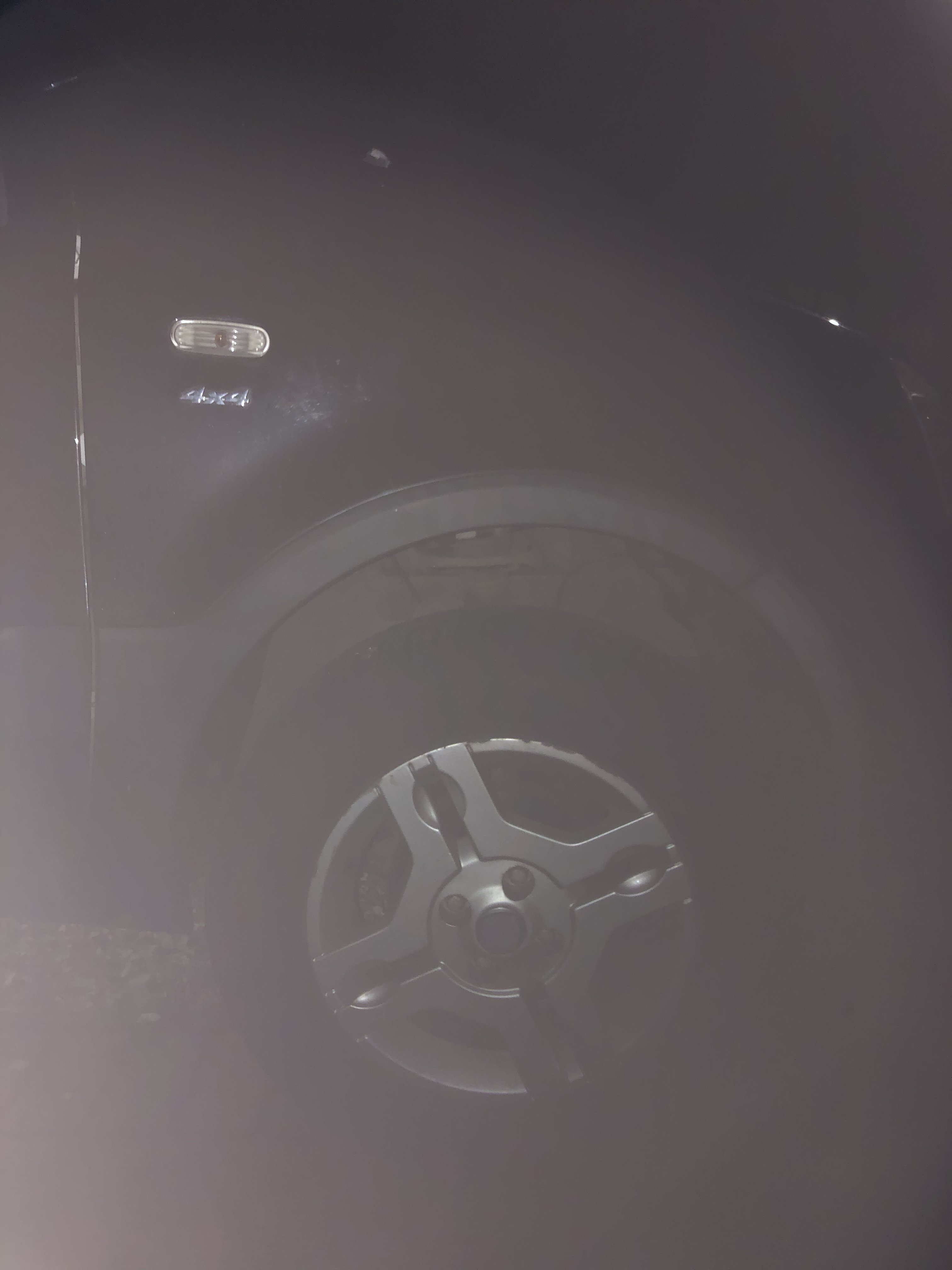

Alright. New to Pandas and am now proud owner of a 06 4x4. My first question is about ride height. Mines looks very high. So high the rear tyres at times rub on the lower arch😬 What’s the factory ride height? Cheers
Some photos

before I go and look it up and possibly get it wrong. If you have the owners manual the ground clearance is quoted in the back of the manual.
hard to tell in the photos but doesn't look far out. Daylight photo is going to help. The rear does alter quite a lot according to load. Main things to check are springs aren't broken. Both nearside and offside are the same. Correct tyre size
don't quote me but with a full tank of petrol, spare and tools. Ground to wheel arch around 685.5 mm. Its one of the 4x4 from around this era but no idea if they are all the same.

When turning they sometimes rub on end of sill/arch liner. Looking at photos of rear the tyres seem too close?
No your right. I reckon rear is too high but don’t want to rush in and buy new springs for it to make no difference. I think if it was a tad lower the wheel would centre better

ride height looks about right. There a bet of give and take. Its much lower when loaded
are they the correct tyres
175/65 R15 on a ET35 wheel were standard and 185 would just catch the wheel arch on standard wheels

Yours does look high but what do I know I don't have a 4x4. Pick up the phone and talk to Shop-4-Parts. They will tell you the different spring lengths and wire diameters for the various models. If you decide to replace yours their prices are good.
It's either been cut and shut, or the rear subframe is in the wrong place.
