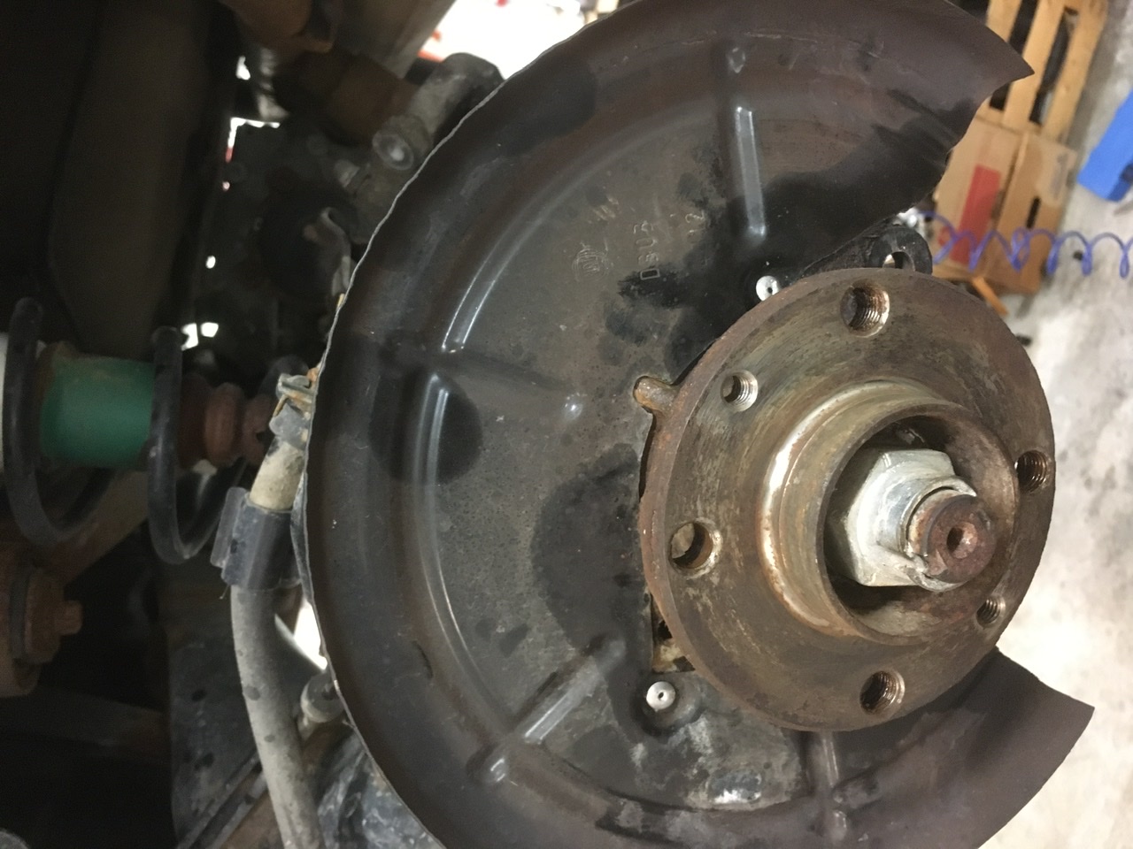

Pic 1 - i am pointing at the cut-out in the rear trailing arm.

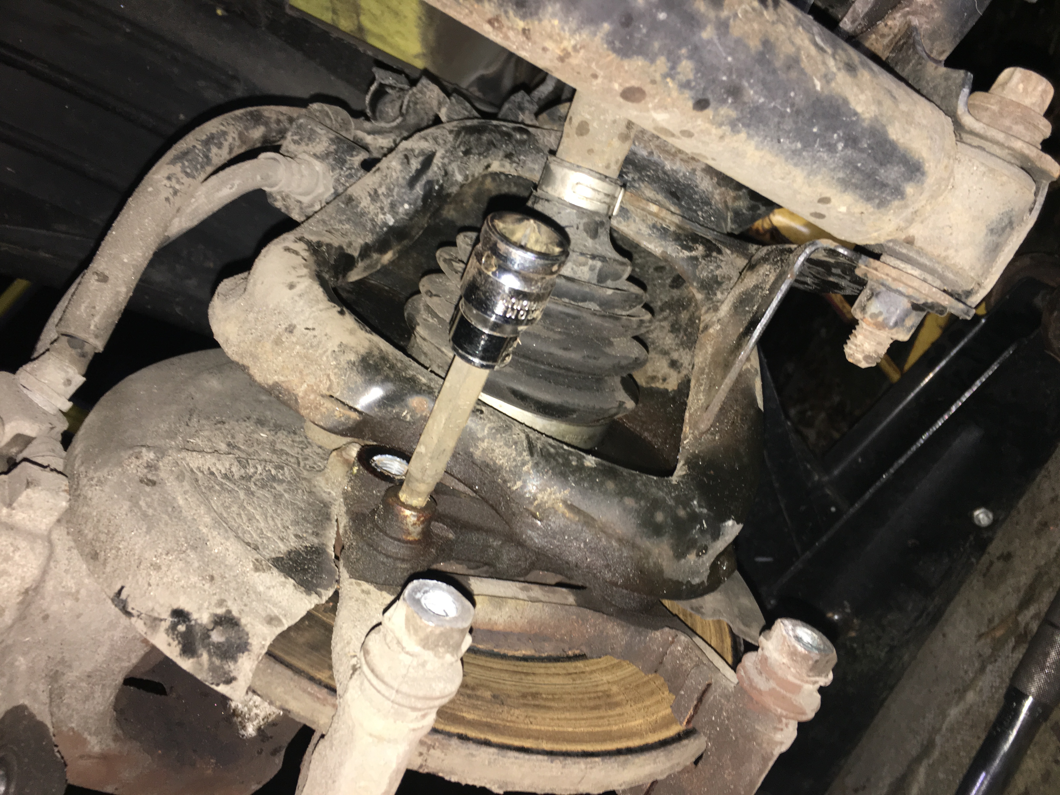

Pic 2 - this is a 14mm wall-drive socket - it fits the star/torx head bolts which fasten the hub to the trailing arm

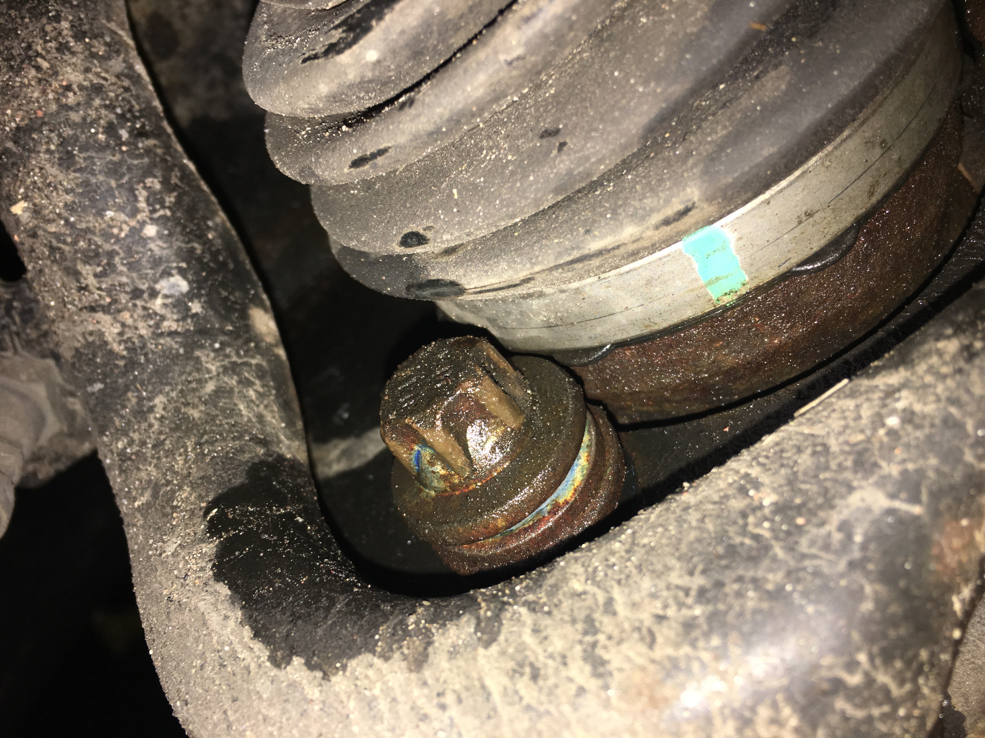

Pic 3 - the star/torx head bolt.

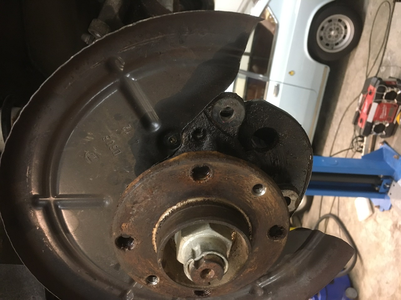

Pic 4 - the 8mm hex bit in the 8mm hex bolt which secures the caliper guide frame to the hub.

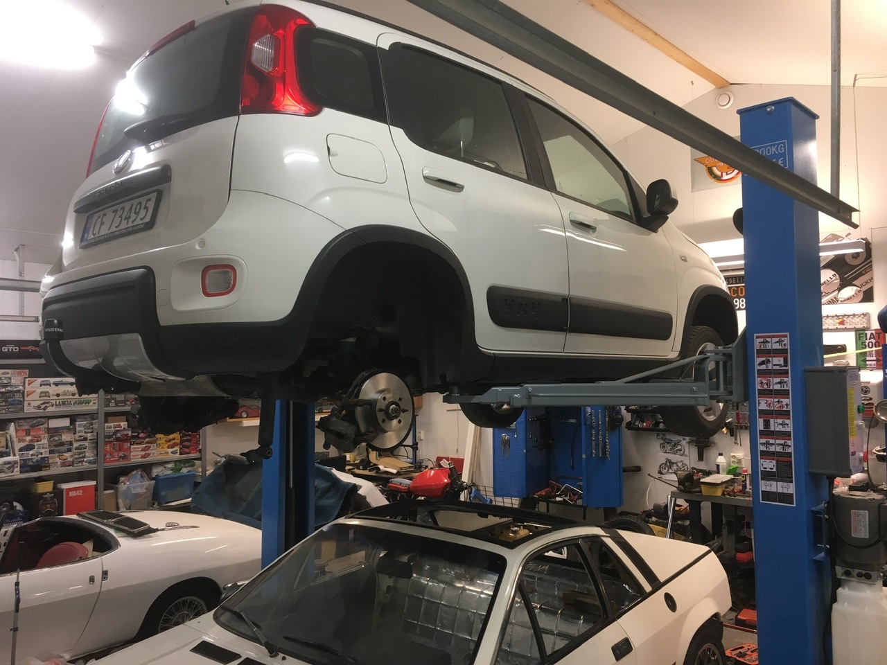

Did this job today, it was not as bad as I thought.
Thanks to you guys for posting how to do it, with your help it was a breeze. (Just accept that it takes some time)
Everything came apart ok, had to put some new rivets on the braking shields as they had come loose.
Now it is hanging on the lift waiting for new pads, which should arrive shortly.
