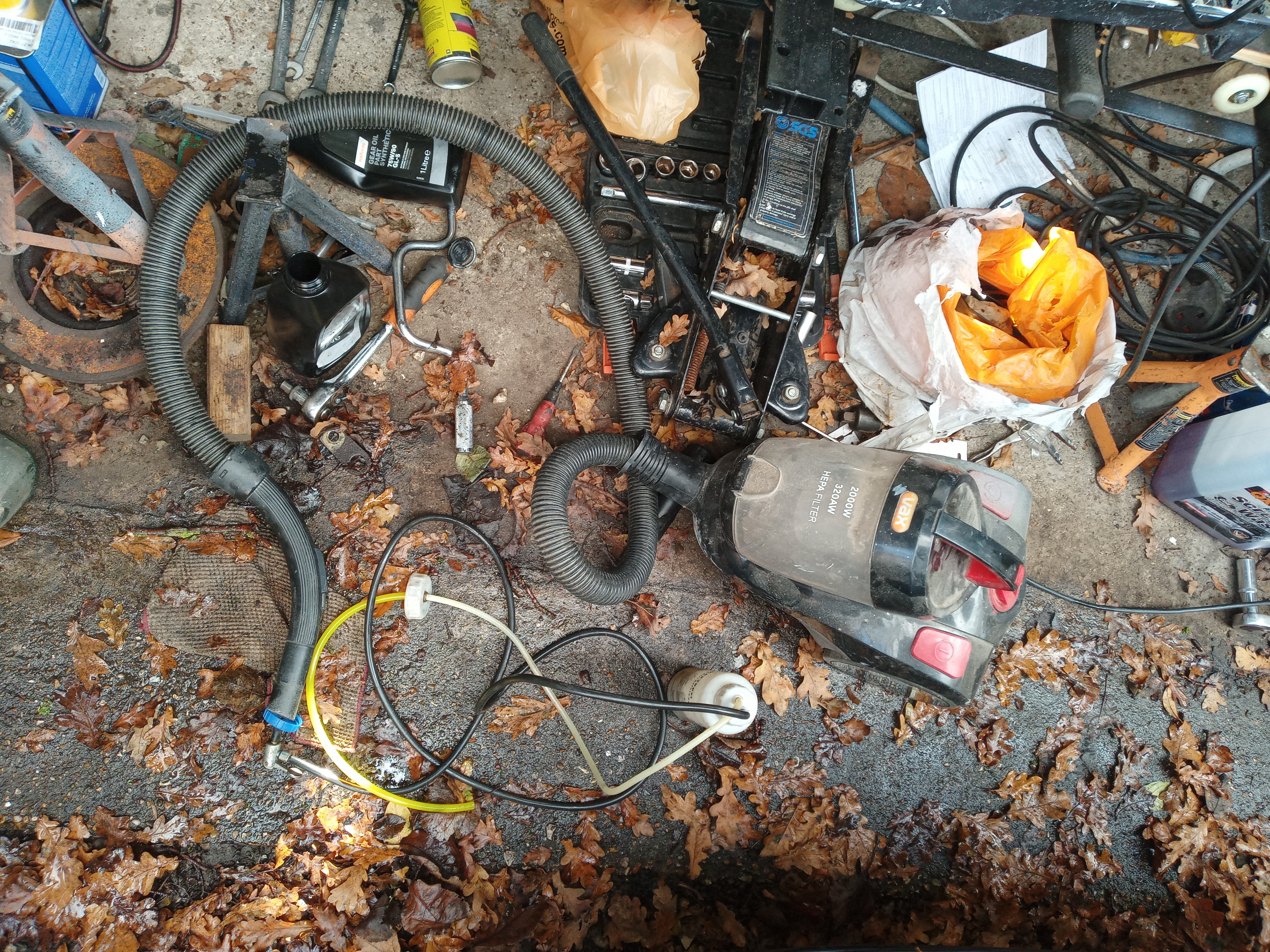

clear 6mm OD was too small to reverse bleed on slave nipple with big syringe. Cannot tap bubbles out. Kiwi guy had larger than 6mm diameter on youtube.
I sorted out mine with forward pressure bleed recently as that is kit I have, just on slave. It had been sat for 10 months not moving. I think lower pressure comments sounds like good advice.

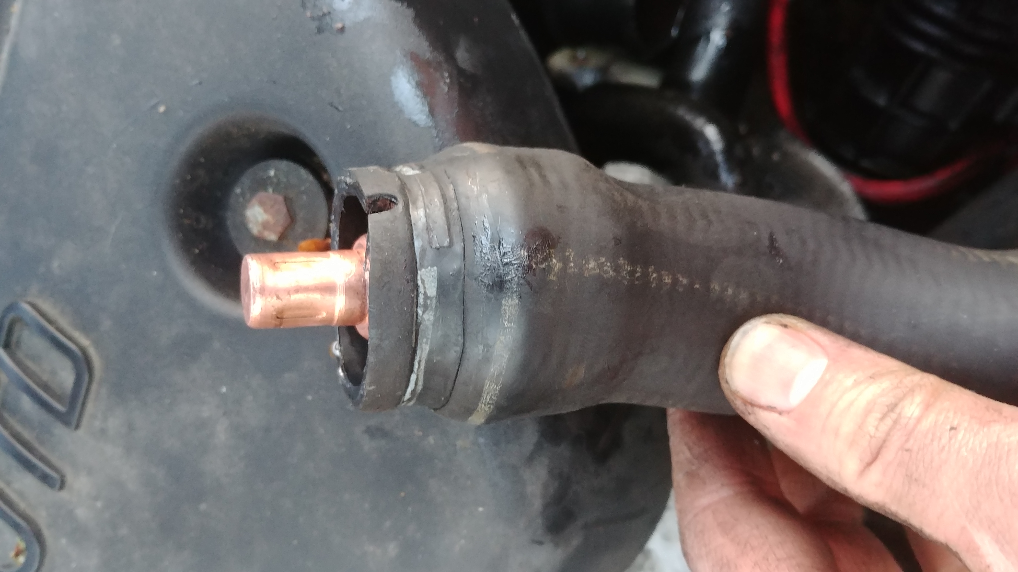

Thought I'd fix the 1-2 bars on the temp gauge the only way I know.
Offending top hose with clip removed:

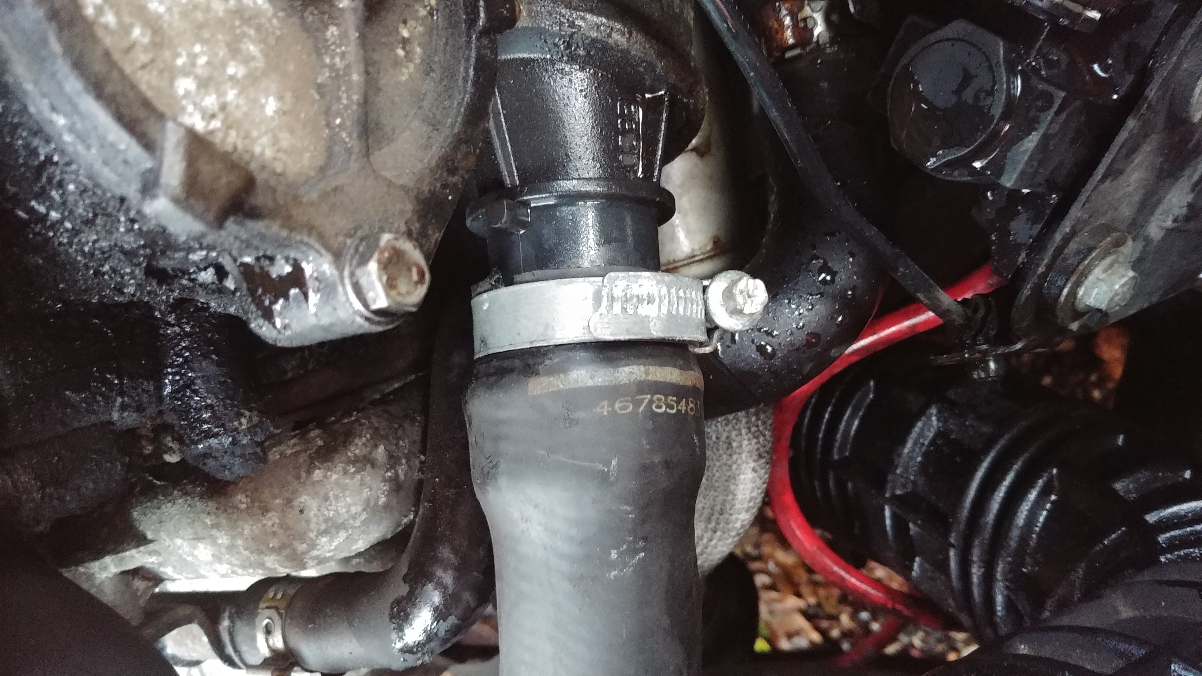

Renault thermostat showing the task in hand:
Mug o hot water to soften the hose and some cv joint grease on the thermostat:

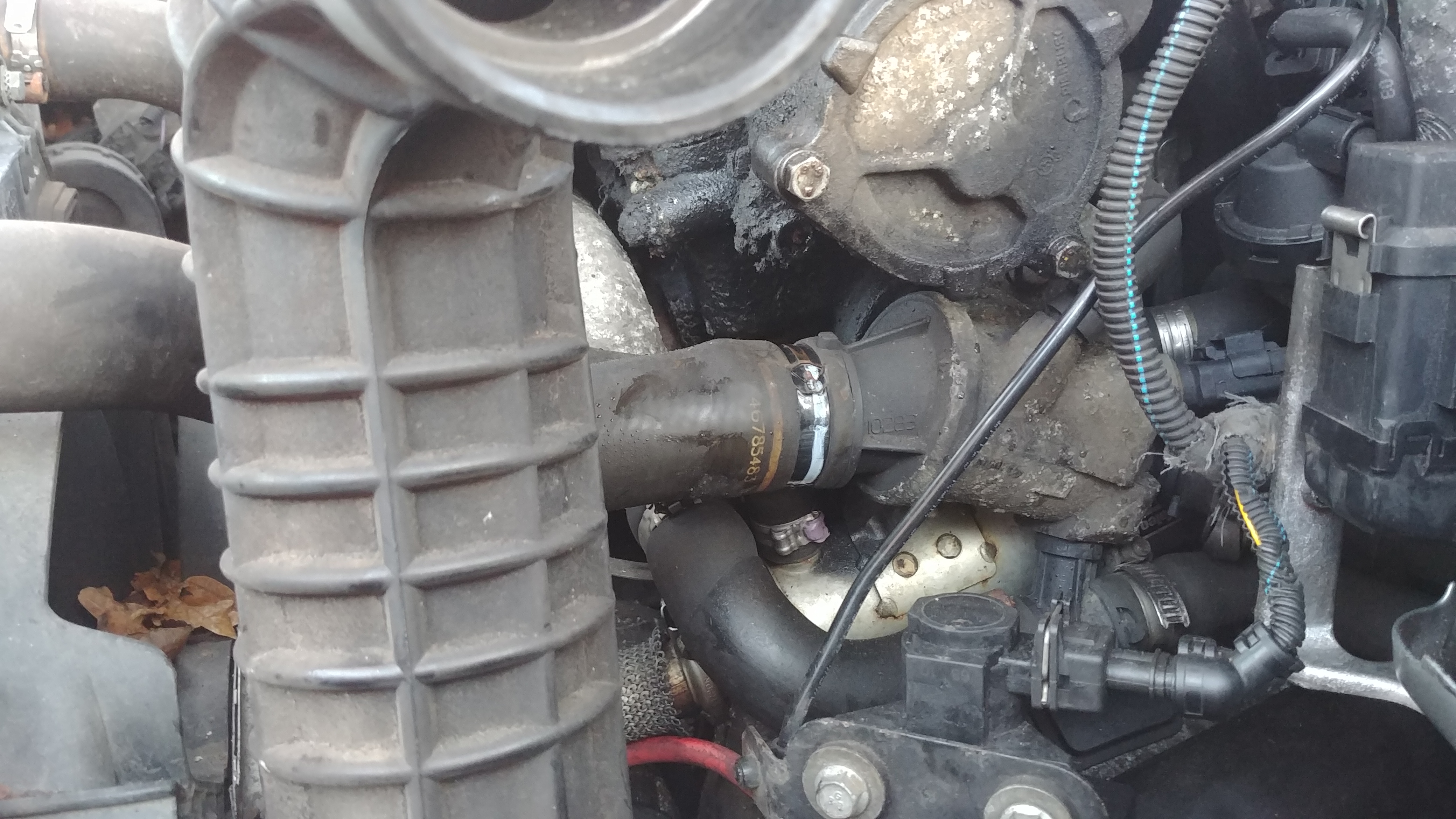

Took some squeezing to get it to here believe me! But it's enough to get a decent land on the jubilee clip ahead of the safety bead on the fiat thermostat housing:
Job done.

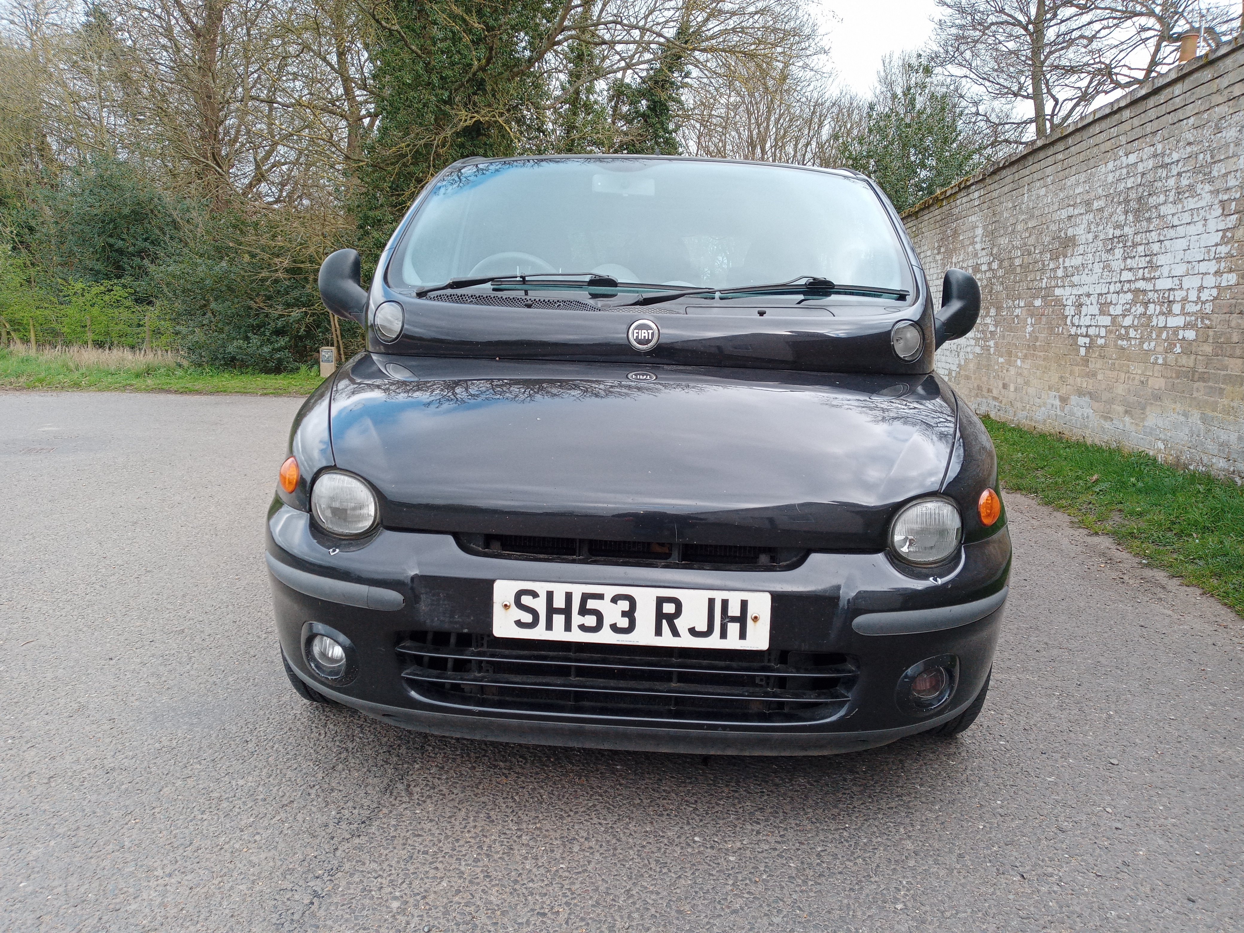

Hello All,
If anyone fancies picking up the baton on this let me know.
MOT Jan 2022, 136k.
Faults: Aircon didn't last long after regassing, sunroofs don't work, and the MOT guy was saying the rear radius arm bearings are worn but are not giving any unwanted movement yet.
Clutch good, recent oil, air, fuel filters.
Tow bar & roof bars.
£800 Colchester.
Nowt really wrong, I just want a change.
To be replaced with another 'pla, or are you moving on to other things?
I'm sure you won't have trouble selling it for that kind of money. Roundnose models are getting hard to find now and yours looks basically sound.
I legit would be interested but theres no room at the inn i'm afraid :shrug: as above though, if you are in the market for a prefacelift (not the biggest market granted) theres not much about. I've had my eye out for a decent one since my daughter was born, been to see a few but not come across one I'd be happy to own yet - really hard to find one with a remotely nice interior still lol
Thanks all,
No not another Multipla, if I win the lottery there'll be a space reserved for a turquoise SX with grey bumpers but for now I'm going to move on and get a Ford S-Max or Galaxy. Stupid dog now warrants a bigger boot with room for the three kids and bikes and what have you. It'll still be old, crappy and unreliable but then again that's all I've ever known!
