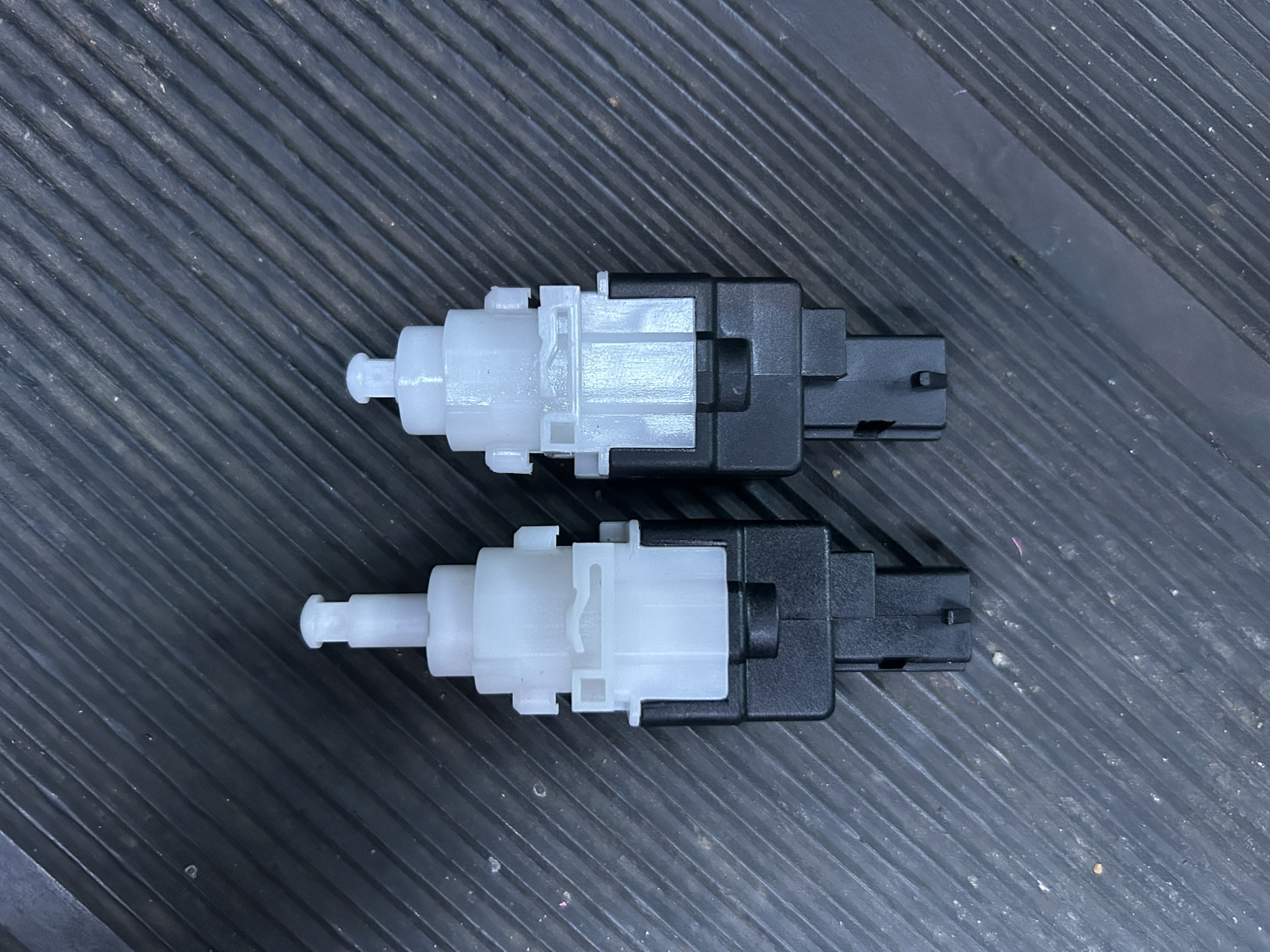

Break pedal switch signal invalid. Anyone had the same problem. Is it that switch that I have to change?

Yes its.a.commom.problem
Yes it usually the switch
You can sometimes fix them by gently pulling the plunger out,it's on a ratchet and let it recalibrate, especially if the fault occured after the foot slipped of the pedal and it bounced back hard
The UK version of the panda twin air .the switch is on the passenger side . It is good to know that. I tried to remove and put it back again but the triangle spy light is still on.
Try pulling the little plunger out as here sometimes fixes them
If not it should just be a replacement job
Good news I replaced it .I bought it in Amazon for 10 pounds and even better the TRIANGLE LIGH WITH THE EXCLAMATION POINT HAS SWITCHED OFF
