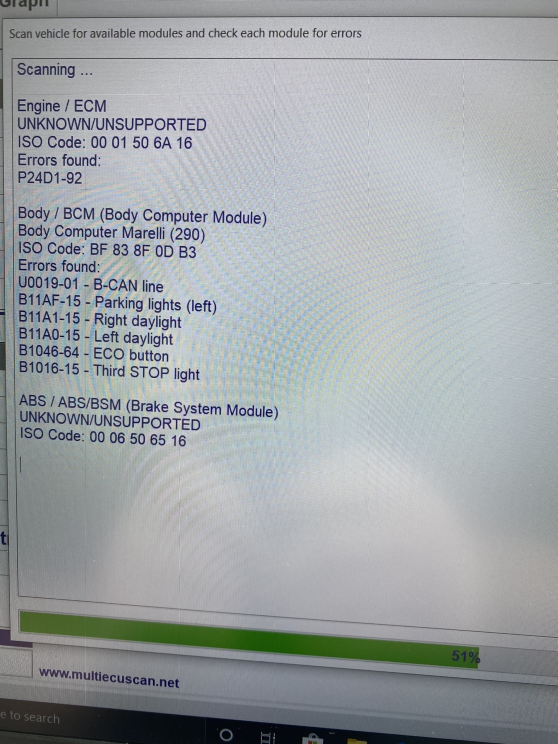

Old version of MES (2018 vintage) wouldn’t recognise new van engine or abs, but the body/ECU was
Only showed ISO codes for the engine etc
But it would let me clear DPF matter sensor fault, and reset oil degradation (early oil change)
Now I’ve had to install MES on new laptop yesterday buying 4.6R license
Nothing is recognised?
It scans then says complete
Nothing else on screen
Am I doing something wrong, do I need drivers fir elm327 cables that worked fine before laptop change
Any advice?
Thanks
Neil
You said in another thread that you can't use your previous version of MES as it's gone now.
You can download older versions from the MES site, and the current licence should work for any of them.
http://www.multiecuscan.net/ReleaseHistory.aspx
All I can suggest is to install the version you were previously using, and see if that works as it did before. You'll at least figure out whether it is MES or your laptop that has the problem.
Check your adapter/interface settings make sure it detects your interface on the test section
Spot on mate, just need to get the issues sorted now haha, not bad for 2 months old
