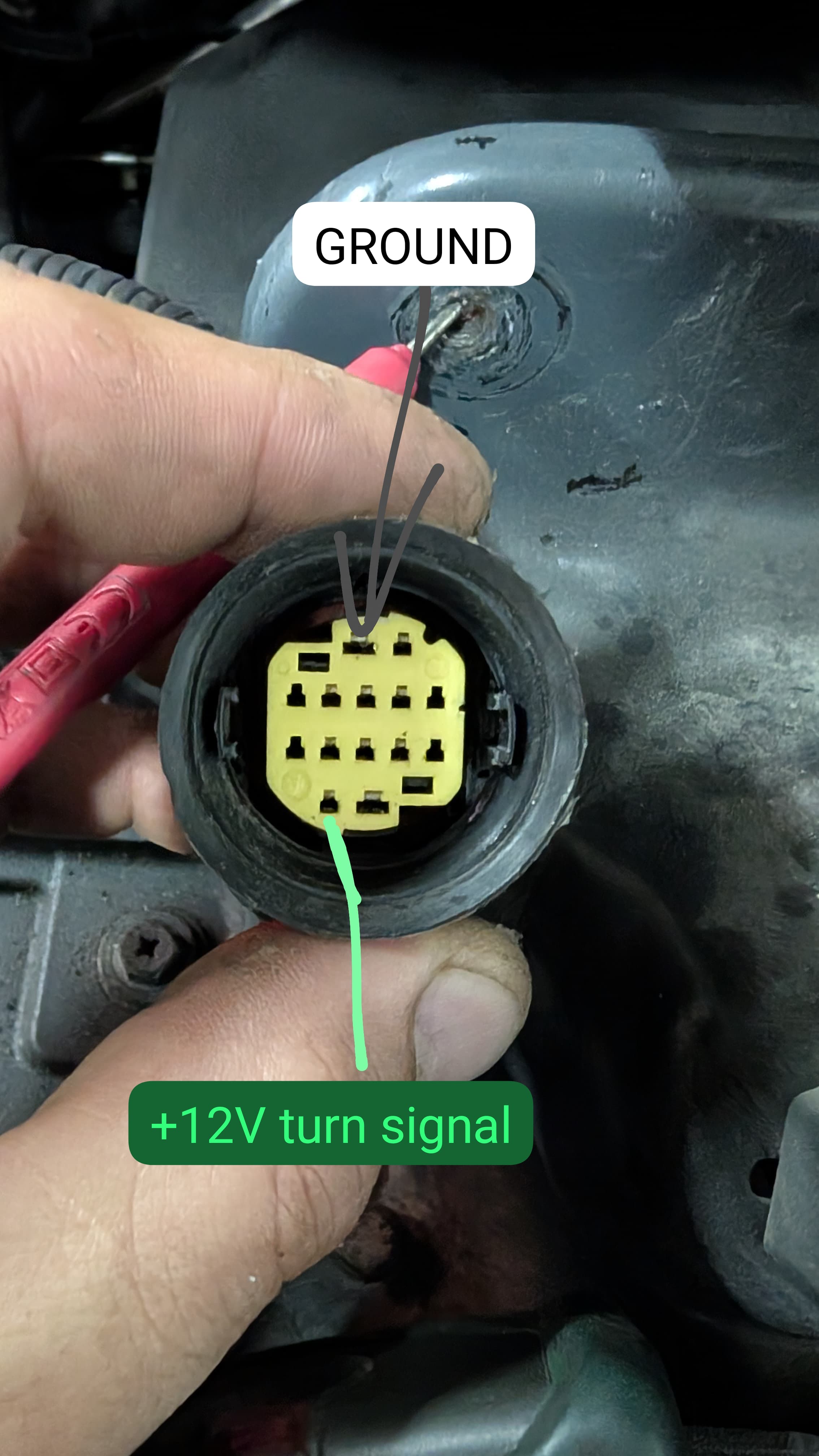

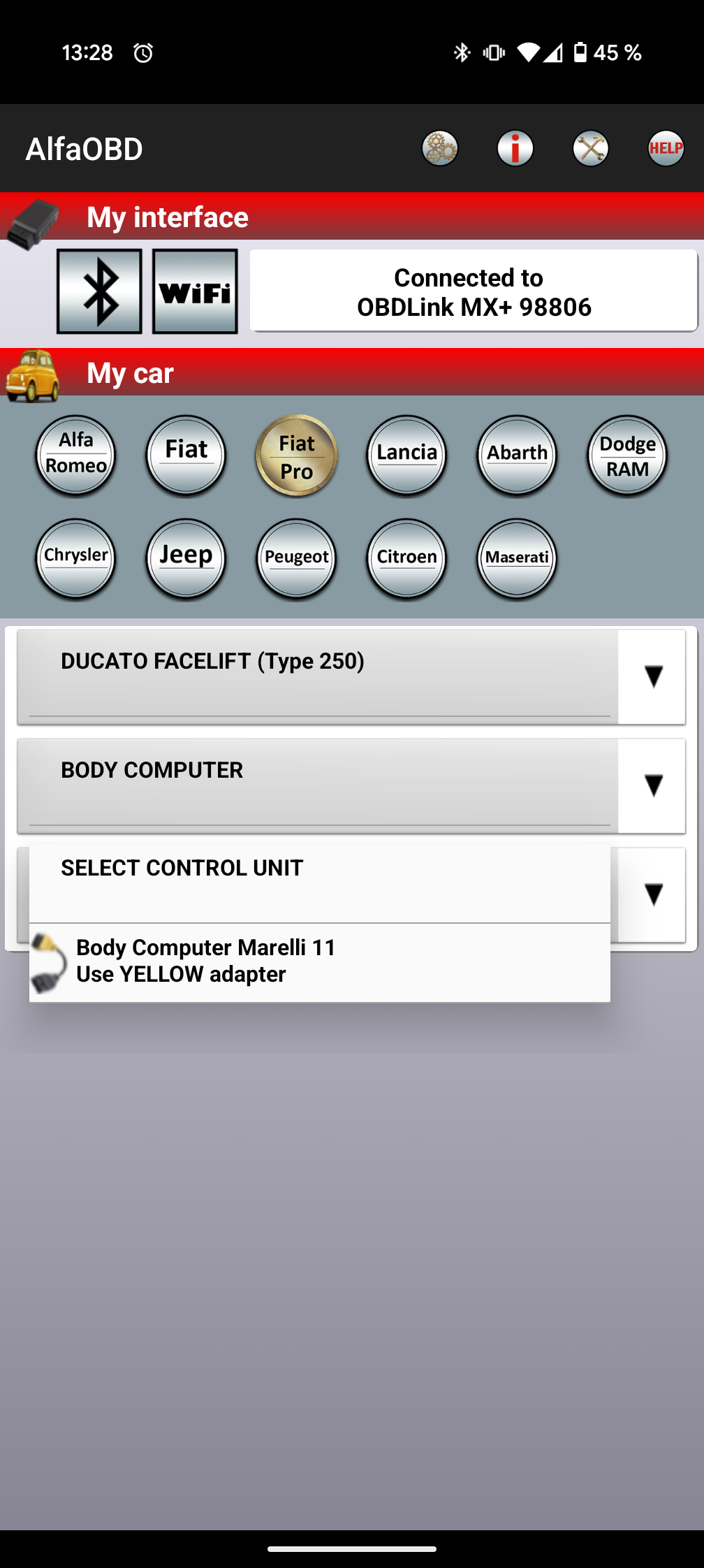

I didn't find an option for front turn signal Led. I have just to choose between 21w and 27w. Same for mirrors: 5w or 16w. I tried also other proxy values, work ok just using resistors. I am ok using resistors. On 2019 I use 21w Osram resistors. +12v turn signal: left Blue/White, right Blue/Black. Fyi: for 2019 with alfaobd need to select x250 facelift BCM. For the rest of modules work with x290.
