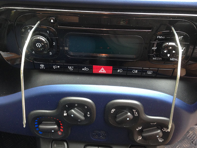

As the new Panda Radio only has two holes for the release keys (instead of the usual 4) you'll need to bend the keys straight-ish.
attachment.php
The keys only need to be inserted about an inch to release the lugs but you don't have much purchase on anything to pull the radio out so it is a bit fiddly
attachment.php

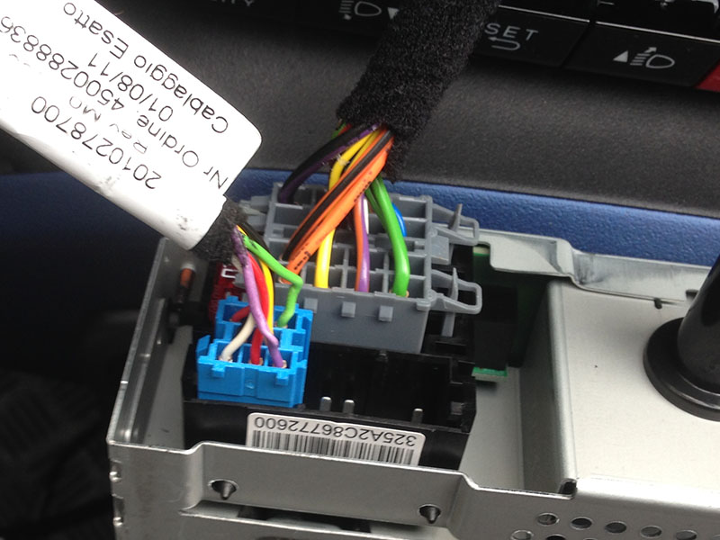

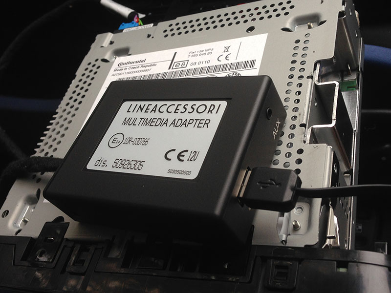

For those that are interested in these things, this is the label on the 2013 model Panda CD player
attachment.php

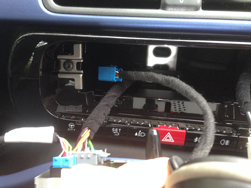

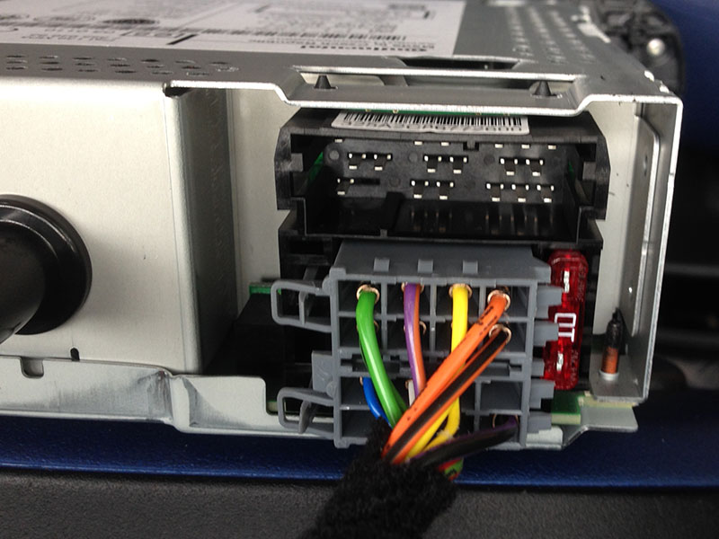

The adapter connector fits in the top right slot of this socket on the back of the radio
attachment.php
It comes out of the box with the VIOLET and GREEN wires in this position. These need to be swapped over to be compatible with the Panda radio. ON ONE END ONLY, do not swap them over on both ends of the wiring
attachment.php

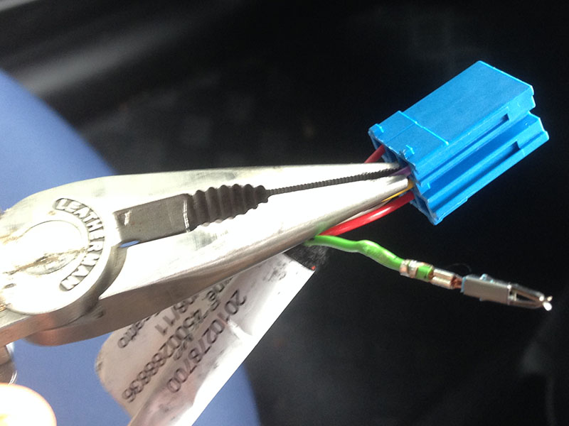

With a pair of pliers just pull them out and swap them over. They are in VERY tightly. Do not yank them out but grip firmly and pull with steady force, they'll come out eventually. When you swap them over make sure they go back the correct way around, they must align with the pins on the back of the radio. Look at the other connectors to see which way round they go
attachment.php

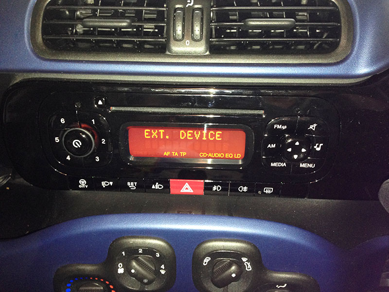

I chose to test it before fitting it all back in place. It worked straight away. Just press the MEDIA button to see 'External Source'

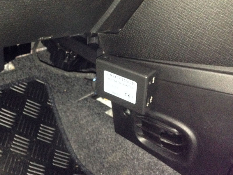

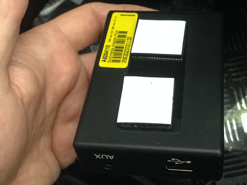

the adapter comes with sticky velcro tabs so allowing you to place it anywhere convenient. The instruction manual details a method for placing is INSIDE the glovebox but I figured that would be inconvenient and the glovebox lid wouldn't fit very snuggly once closed
attachment.php
I chose to stick mine on the side of the centre console under the dash (see below) it is not as neat and hidden as I'd like but it makes it easier to plug things in and means I wont be trapping the USB cable in the glovebox lid.
attachment.php

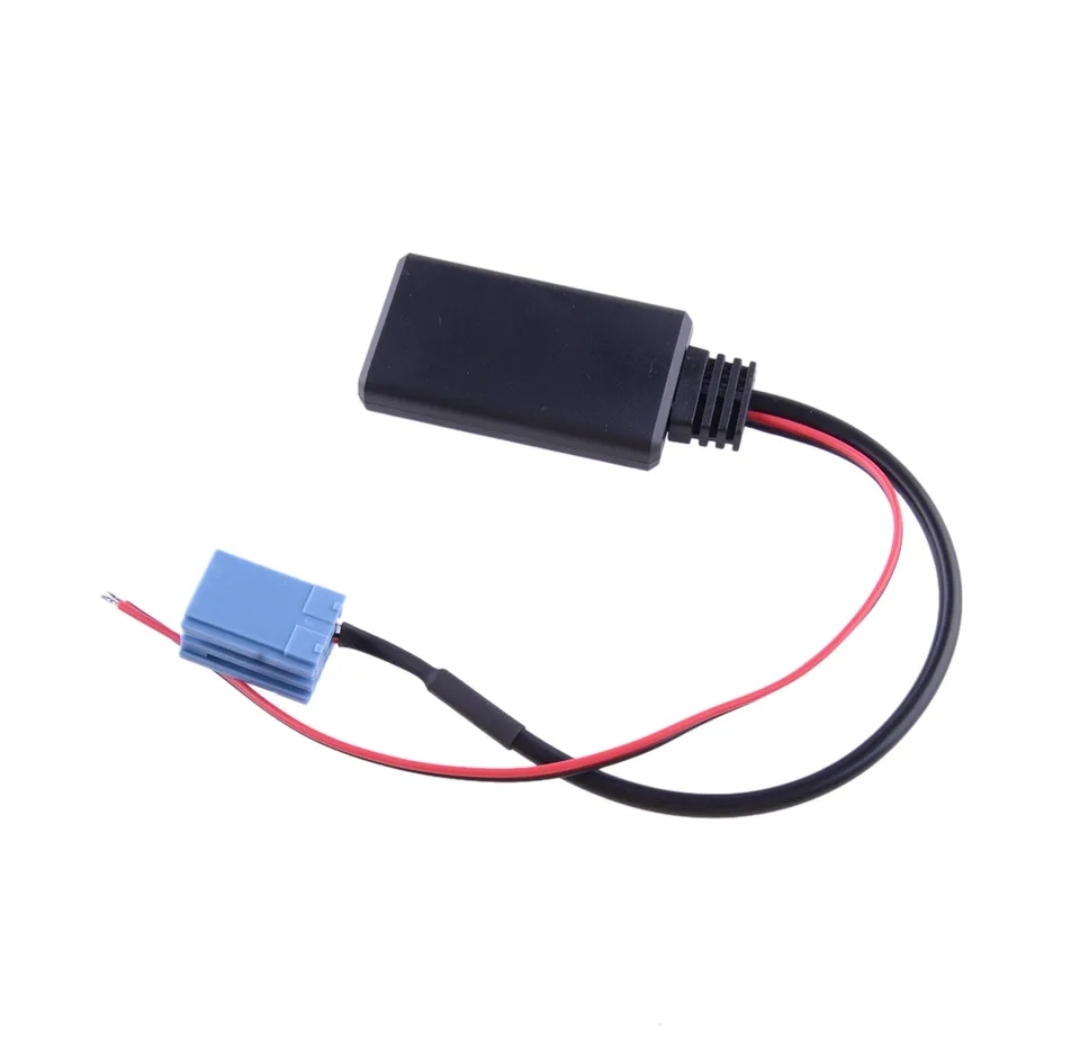

Great thread - I got these bits off of ebay and added blue tooth to my Panda Pop in next to no time:
- Bluetooth Aux Adapter: https://www.ebay.co.uk/itm/304050110621
- Some similar Aux Adapters (just so that I could steal the connection pins out of them): https://www.ebay.co.uk/itm/402466295871
Using the pin diagram above powered the bluetooth aux from the stereo itself, so it literally was a case of pop-out the stereo, plug the lead in the back, and pop it back in! result!

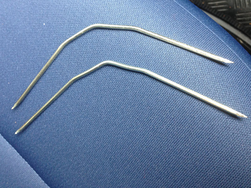

I used unbent staples inspired by Oor Wullie's instructions to release the two wires from the terminal for swapping, which really worked well and avoided the need for an expensive terminal release tool.
