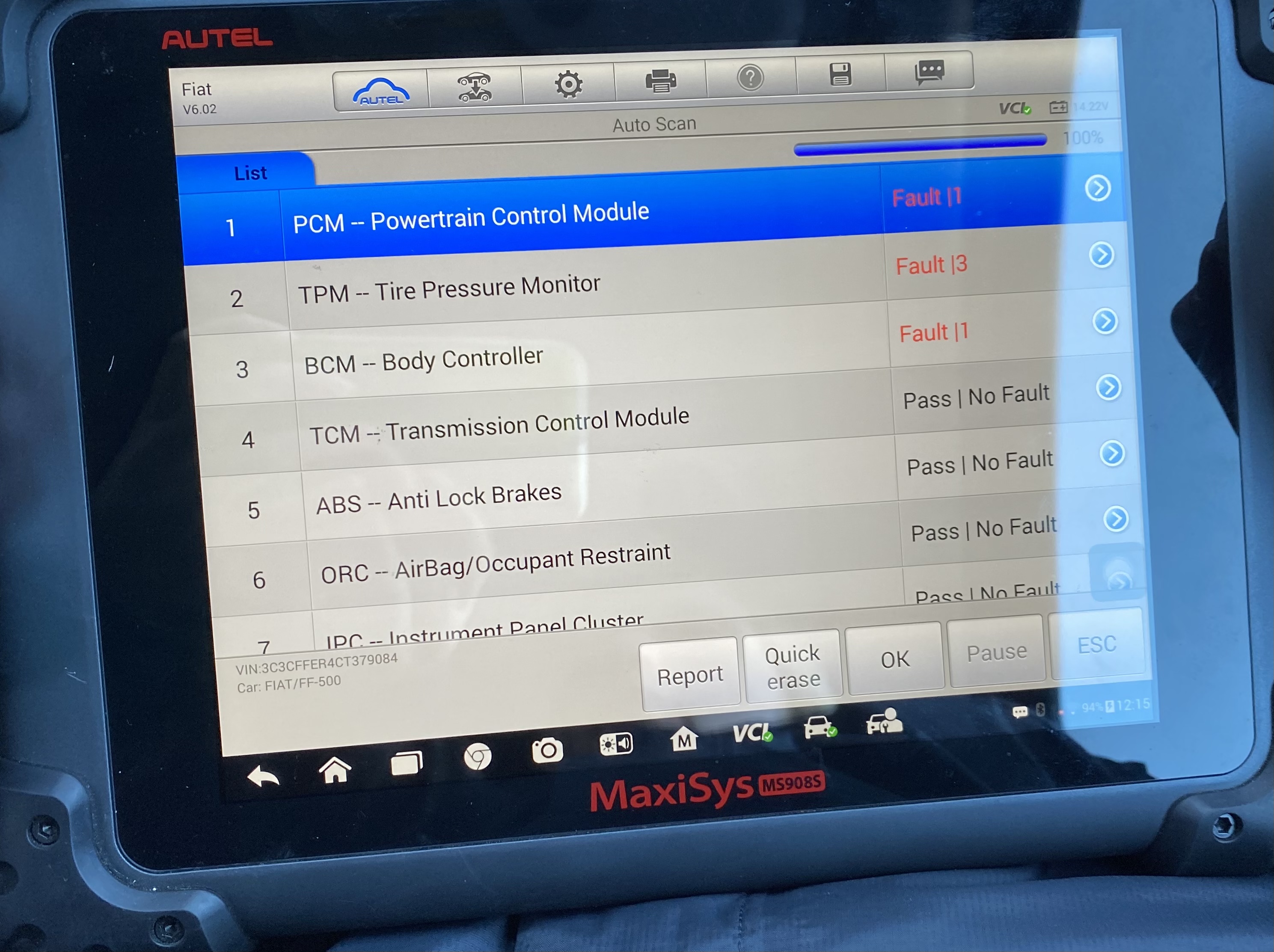

Hi, I just joined on behalf of my daughter. She owns a 2012 500C and today her check engine light came on. She’s currently taking mechanics in school and her teacher ran and diagnostic on her Fiat and this is what came up. Any ideas where to start?
Thanks for any tips/advice/suggestions!
Did they try deleting the codes and seeing if they reappear as they may have been logged earlier due to a low battery fault or similar possibly.
What did her teacher/instructor advise?
You need to go down a level to see what the fault(s) under each heading actually are I think...those are just the categories.
Ok I see. I will try and see if she can run it again and go down a level. Now that I’m looking at the pic again, I can see the arrow on the right which may show more?? Really hoping it’s nothing huge to fix
The more problems there are at once, the more likely it is to be something simple.
