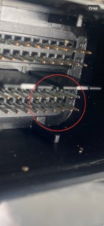

Thanks for the help, got the passenger headlight out and checking the cable loom at the moment as an ex Fiat technician college tutor else has suggested this, ECU also removed and noticed some slight corrosion, will carry on tomorrow testing the wiring loom, cheers again

Thanks for everybody’s advice, looks like the OBD Autel reader was on the Money telling me the problem was with no communications to the ECU(U 1701)), sent the ECU off to Car tech who sent me a plug and play ECU and we are now all good, cheers, Paul.
