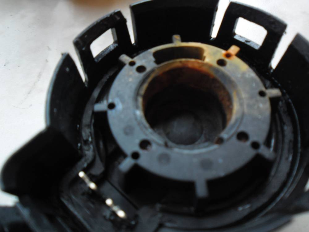

hi all . I had the same problem with my 3L x250 along with others associated with water ingress it turned out to be the ( throttle control valve) that's to techno 100 check out the thread

hi tribby . yes it did just check your throttle valve for water ingress first if its the same type as mine only 2 screws & you will see straight away any water damage

hi not sure about your engine but someone on here will here is a photos of water damaged valve on x250 2008 3L one photo from another thread techno 100 water ingress
