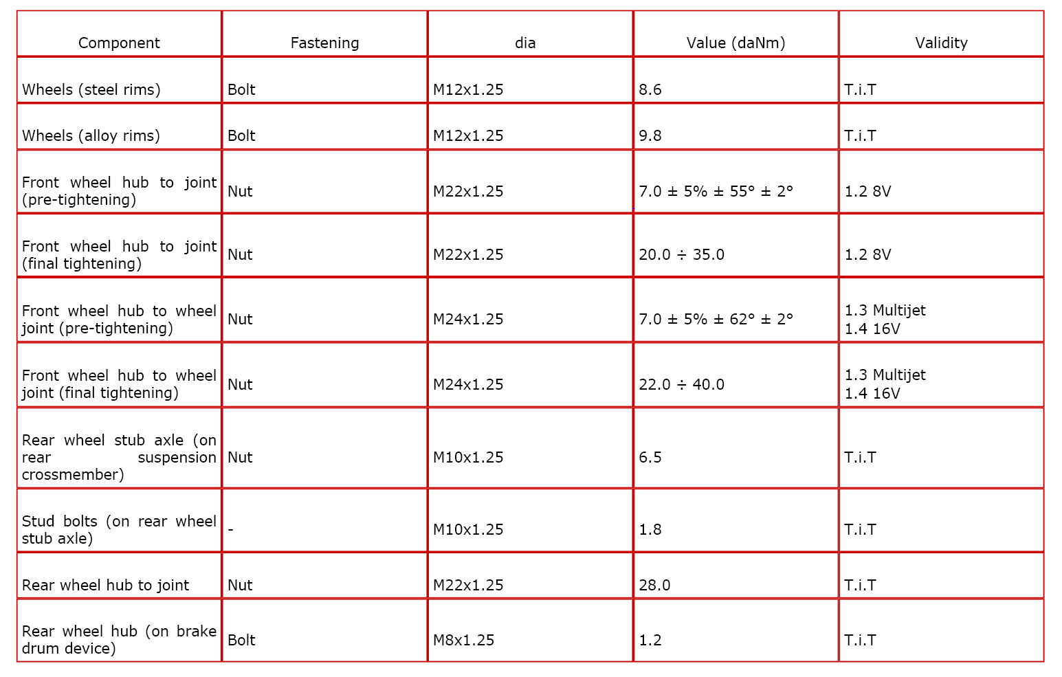

Do the studs screw into a blind hole or is it a through hole?
Sounds like a plan - when I go to collect I'm going to see if I can get the service dept to find out what Fiat recommend for re-fitting; both torque specs (although I have some of that from searches on here and from the Haynes manual - even though it doesn't cover rear discs) and thread lock (and hopefully what grade as well, if they do!)
Here's a table from eLearn giving the thread specs & torque settings for the rear stud bolts.
Through hole on all four. :)
In that case I would say 18Nm or so , use blue (medium strength) thread lock and assembled stub axle to axle and torque retaining nuts to spec before the thread lock cures (in order that no cured thread lock is under any loading)
If you are confident you won't need to remove the studs again you can use red (high strength) thread lock.
