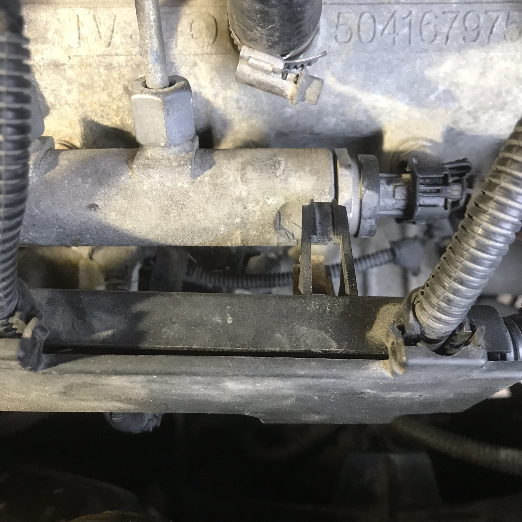

Sorry only just seen this! The photo shows the rail as it is on the eLearn diagram but on mine the pressure sensor is fitted in place of the prv and there is no centre tapping where the pressure sensor is shown.
I’ve still to measure a couple of things and then I’ll be stripping it down to get better access to the rail and hp pump.

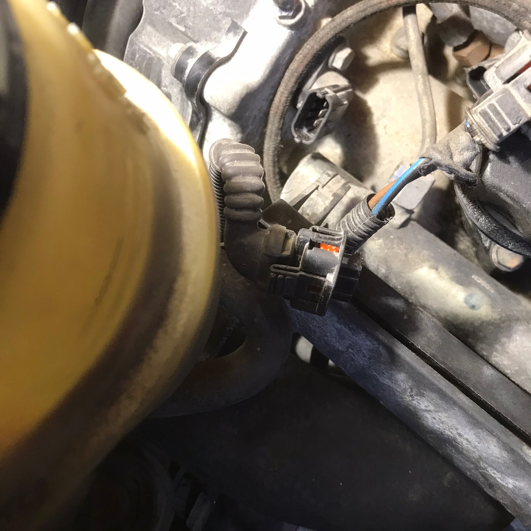

I’ve just been out to confirm what I said above. I’ve disconnected the injector wiring and pulled the plastic trunking back to get a better view and check there are no connections on the rear of the rail and there are only the 4 injector pipes, the feed from the pump and the pressure sensor on the end. The leak off tube from the injectors goes back to the pump but there doesn’t seem to be a return pipe from the rail.
This show the air pressure sensor on the right hand end of the rail
Middle of the rail no tapping for the prv
Left end of the rail - the open plug is the camshaft sensor
