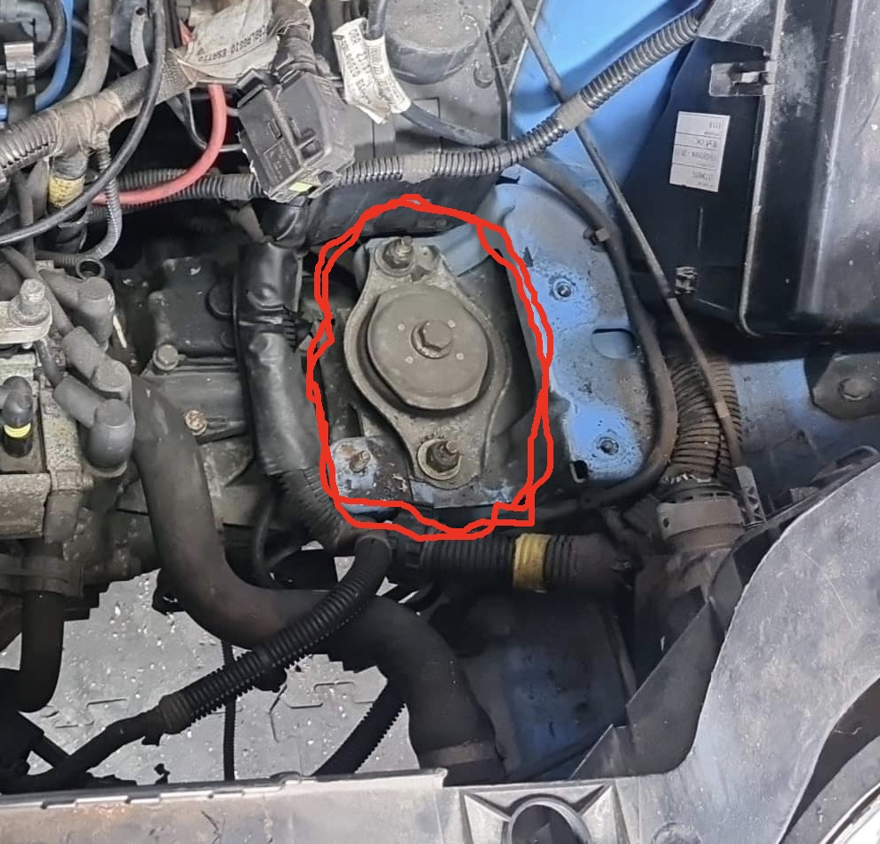

I've owned my 2004 Panda since about 2016/17 odd before 'selling' to my partner last year as I inherited a new car. Unfortunately he is a very new driver and ignored the engine temperature warning light, which led to a very stressful breakdown on the side of the M25 and a diagnosis of a very likely bricked engine.
As a budding mechanic (and a Panda lover!) I am giving replacing the engine myself a go, and have almost everything set up (including the new engine). The main problem I'm having is that the Haynes manual seems to want me to take the engine and gearbox out together through the bottom of the car, and now I've got the air filter and battery/tray out I can see what looks like a bit of the chassis blocking the gearbox coming out the top.
Is there a way around this where I'd be able to get the whole setup out the top of the car or, failing that, just the engine? It seems I'd have to jack the car up really high to be able to get the engine/gearbox setup out from underneath and I don't really have the means to do so.
Thanks in advance for the help! I've attached a picture of what it all looks like so far.

To answer your question
If you mean you can’t lift it up because this area is in the way
it doesn’t come into play as you shift the weight on the hoist so gearbox end is dangling down at about 45 degrees and it slides underneath
