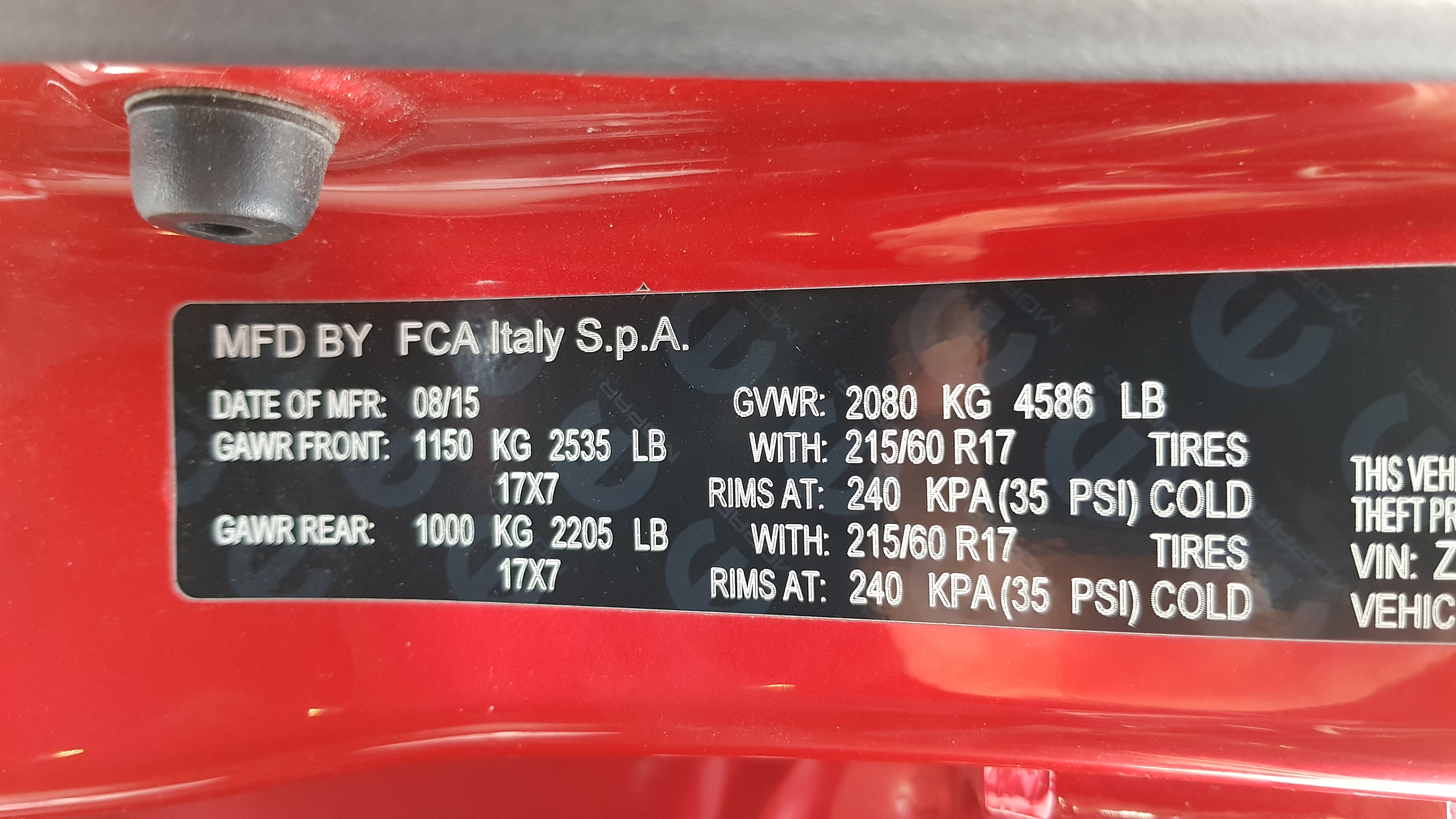

I didn't think about the B post sticker. Thanks! The location is the same in the US cars, it just happens to be the driver's side in those.
However, I'm not sure what to make of it. What exactly should I be looking for here, if I want to tow another car? Is it GAWR REAR or GVWR?
Interesting as the US plate is different to the UK/EU ones.
GAWR = Gross Axle Weight
So the maximum load you can have on the front axles is: 1150kg / 2535 pounds
So the maximum load you can have on the front axles is: 1000kg / 2205 pounds
GVWR = Gross Vehicle Weight
So the maximum total weight of a fully loaded vehicle is: 2080kg / 4586 pounds
NOTE! In this case it is less than the combined GAWR of 2250kg / 4740 pounds
The label is NOT showing a GCWR = Gross Combined Weight
GCWR = GAWR of car/truck + GAWR of towed trailer/towed load/towed vehicle (e.g. another car)
So your 500X does not have a GCWR rating. This is probably why no figure is listed in the Owner's Manual.
I think you are going to have to Fiat US to get a definitive position on this. The alternative is to contact the US homologation/vehicle standards agency and ask them if the 500X AWD is certified for a GCWR and if not is it legal for you to tow with the vehicle.
An internet search on GAWR, GVWR and GCWR will help you as well.
I just searched the owner's information DVD that came with the car and it says "Trailer towing with this vehicle is not recommended." Probably that's why there is no GCWR indication on that label. So I guess no towing other cars for me. :(
