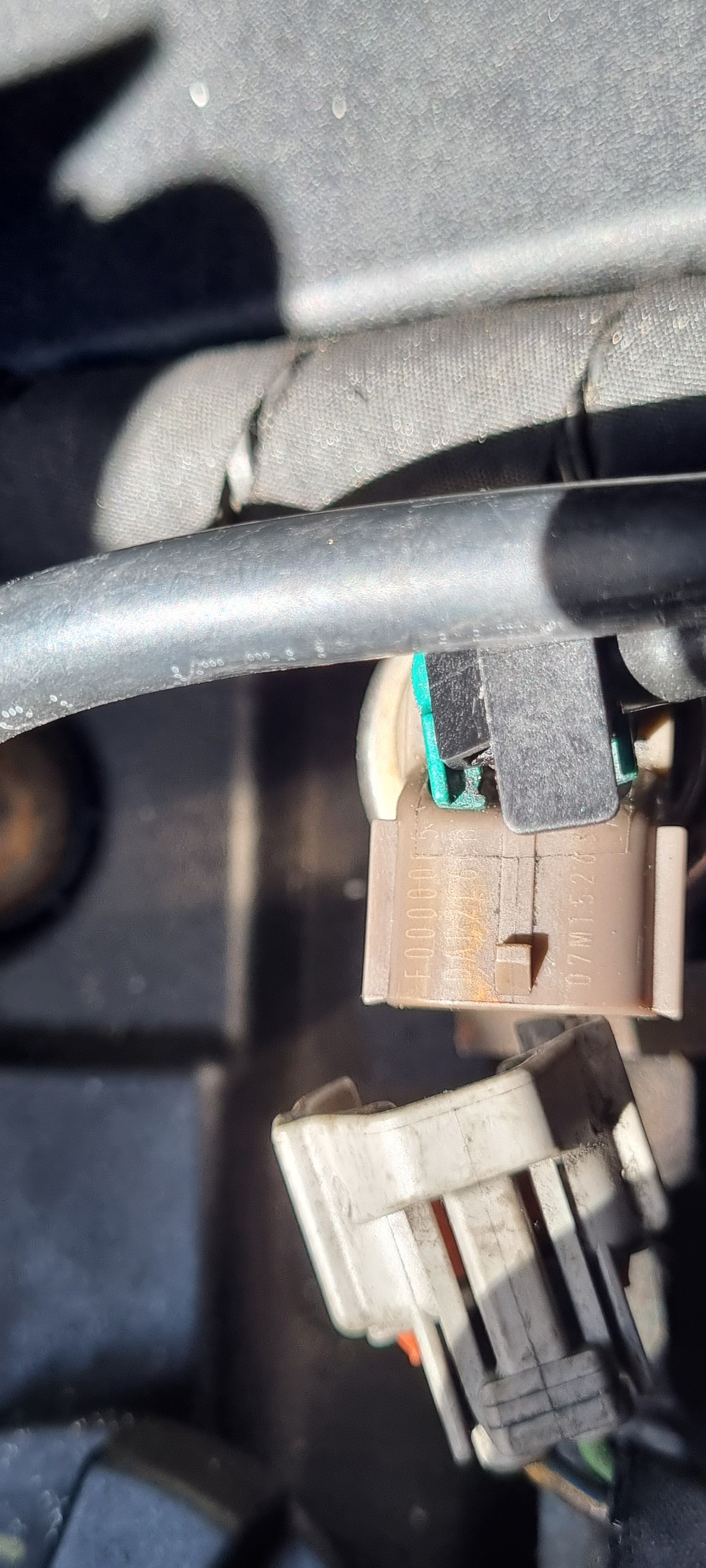

Question I have is about the injector numbers.
Very hard to read. Especially the one printed on the weld.
Noticed oil on one so took it out and changed seal. Tried to read it while out. Not much better.
These were the originals gone back in the wrong way around.
Which numbers are the actual code?
Or. Can I get the already programed in numbers as these are the same, but in wrong cylinders?
As you can see. Some numbers are not good and may be wrong.
Many thanks.

Ok I found them, so entered values.
Runs worse than ever. Stalling now. Once was perfect.
So I have to ask. Are the cylinders numbered 1 to 4 from left to right?
Also. When asking for a pilot learn which is esential i think, Inget "failed to execute"
Many thanks
