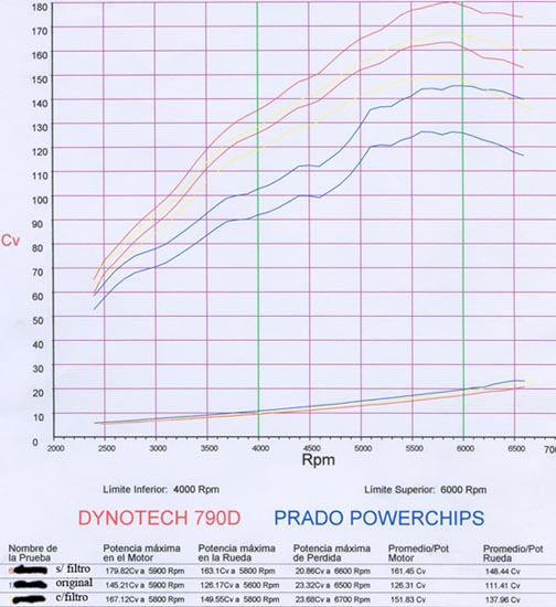

Actually, you can.
You are very much mistaken and I have the dina's results to show you...
Firstly, my car is not the English Marea, it's a Brazilian Marea with, says FIAT, 160 BHp.
Secondly, FIAT's air intake is rubbish as I said before. Do yourself a test (only for a little while, because your engine will be running unprotected), take the airfilter off along with it's casing and go out for a spin (remember to give your car's electronic fuel injection time to adapt to the greater amount of air coming in), and tell me if you can feel the difference...
I bet you'll be impressed.
Thirdly, here are the dina's results from my car's remapping:
The "s/filtro" curve stands for the car's performance WITHOUT the air filter (red), the "c/filtro" stands for the car's performance WITH the air filter (blue), the "cv" following the numbers 'equals' to "bhp" (actually the conversion rate is: 1 CV = 0.98632 BHP)..
Now, tell me, are you high yet? ;)

Good job i understand Portuguese. But now your telling me... a completely different story, about taking off the induction system? Why the hell would you drive around with out one? Just because you have a rolling road graph. Doesnt mean thats the exact amount you will get. Go to 3 different rolling roads, and i bet you you'll have 3 different charts! I think the rolling road people were conning you. :D
I saw once, on a Honda Civic Type R, Forced induction, you know the leaf blowers? Those big powerful machines... I saw a guy, put in one in his induction system (only for a rolling road test) Which created more a lot more power than any standard possible air. He gained 6bhp. On an ACCURATE rolling road. I don't have to sit here and argue with you, with you hoping your air filter will give you 12bhp. If you really believe it, then good luck.

Which completely different story? I am saying the exact same thing.
Another thing, again you are mistaken on your oppinion about rolling tests...
This particular result was obtained on my car, but there are plenty of others that give the exact same amount 12BHP. Of course, if you put your car on lousy dyna with lousy personel, that's a different story, but this happens to be one of Brazil's most reliable shops (and that's saying a lot given our racing history)...
That being said, the less restrictive filter you use, the better the results (12BHP being the most). If you re-read my post, you'll see I said half this value could come with a proper air intake system, not WITHOUT any.
It so happens that the air intake (before the filter) is WAY too restrictive, and if you manage to put in another one (I forgot what do you guys call it, a 'cup'?) that 'captures' more air and takes it to a less restrictive filter you'll be sure to gain that amount on a MAREA.
Remember, I'm not saying that you'll gain that on a BMW or a Porshe or any other car for that matter (I wouldn't know), but as I said many times before, Marea's intake system is rubbish...

Hey snoopie, chill out... No need to get upset...
Listen it's an ACCURATE 'rolling road' as you call it, secondly, I/we are talking about MAREA's not Hondas or any other car, it's a big difference...
Another thing, I believe you, having been proven wrong are using that age old 'work around' called "misquoting". Sadly, my post is right above yours for all to see...
I NEVER said you would gain 12 BHPs WITH an airfilter (restrictive or not). I said that WITHOUT one you would ON A MAREA.
What I meant was that if you were to put a less restrictive air filter ON A MAREA, you would and will gain around 6-8 BHPs (the exact amount depending on wehter it's a "in a box" or if you mount one that completely bypasses the original air intake).
Don't be mad and start a fight, and as you said, believe what you will... Cheers
