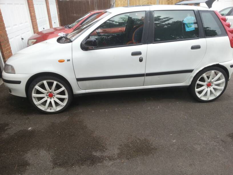

When i work out how to put photos up on here as i forgot, if someone can remind me thanks
This is before i started flareing the arches, should have then done in the next few days and have red door edge trim to glue over the edge to make it safe and road legal as cant have a sharp edge, but the fronts dont come out past the arch so just have to cut about 3/4 of an inch out and leave it as is, backs need about 1 to 1 1/2 inches taken out and a short scaffold pole used to toll them out a bit and then just fill and smooth and they are done.

Like you say each to there own, and havent had it lowered yet plus the rear lights look a damn sight better than the origionals, and no they havent gone out of fashion, just check google photos like i did
Punto Donk look?
If you're doing that much arch work now, lowering the car will be near impossible.
It's an interesting choice going for a five door. To clear wheels like that you'll need a lot more metal to work with. It wouldn't surprise me if you run out of arch to feather.
Only using the scaffold pipe to get the arch rolled out a small amount and then fill it to smooth it out and got some red door stop to glue over the edge, if i take more of the arch out ill just weld a new extension on to make it look good, and then i can bring the arch back down to where it normally is just further out away from the wheel, but just below the line on the fronts where the arch starts to curve to the wing and just above the same line at the backs and will clear great, but if anyone else wants to go nuts like me you will need 16mm hubcentrics on the back and 5mm spacers on the front, 30mm wobbles are fine for front but you will need 42 for the back, plus once ive put the combat bodykit on it then it will look lowered without changing the shocks or springs.
