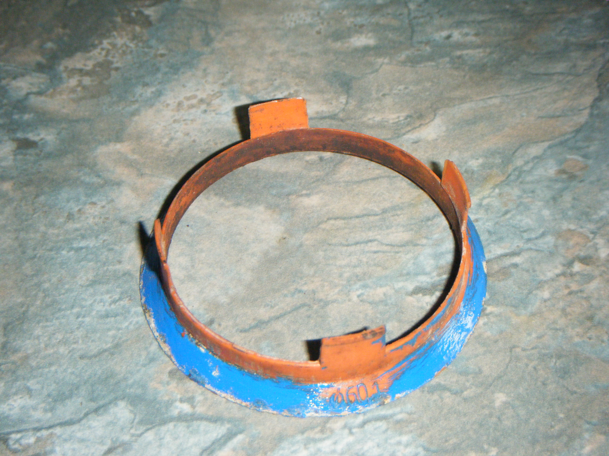

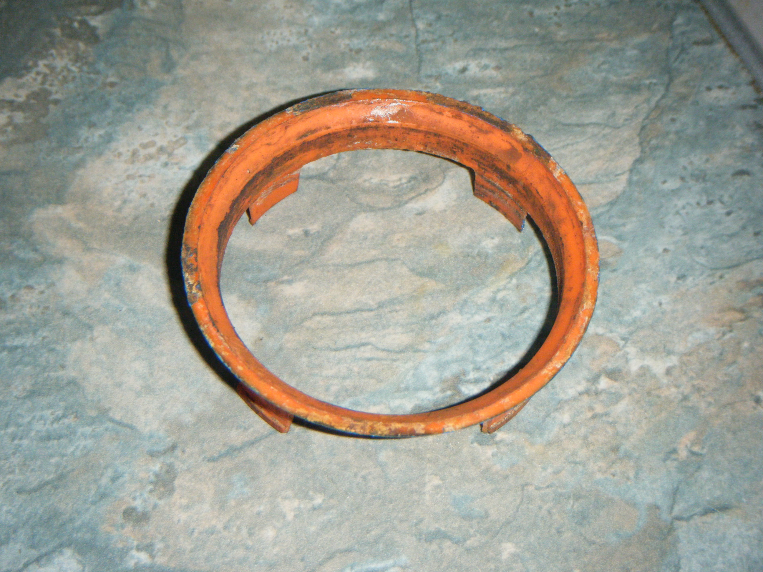

Those two spigots you removed hold the discs/drums to the hub when the wheel bolts are removed. They also align the standard wheels. I have removed them from mine and have no problems.

This is the pic of the so called spigot things, if not what are they called.
different part to what i was thinking. thought you was talking about the two spike things.
I still have those on my wheels.
