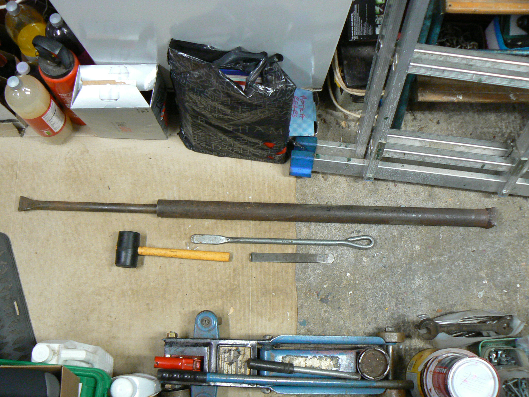

I was worried that the rim might be corroded either around the rim seating or the valve hole so I decided to strip the tyre off and rub down the rust before painting. Many years ago I made my own "bead bumper" and I have a large and small tyre lever and heavy rubber hammer which will deal with most "normal" tyres and rims - I wouldn't use the "bumper" on alloys though as it would damage them - works a treat on steels! Here's a pic of my "gear"
![P1090671.JPG P1090671.JPG](https://cdn.fiatforum.com/data/attachments/193/193916-f5eeddd754446002977e98d083a44cc9.jpg)
