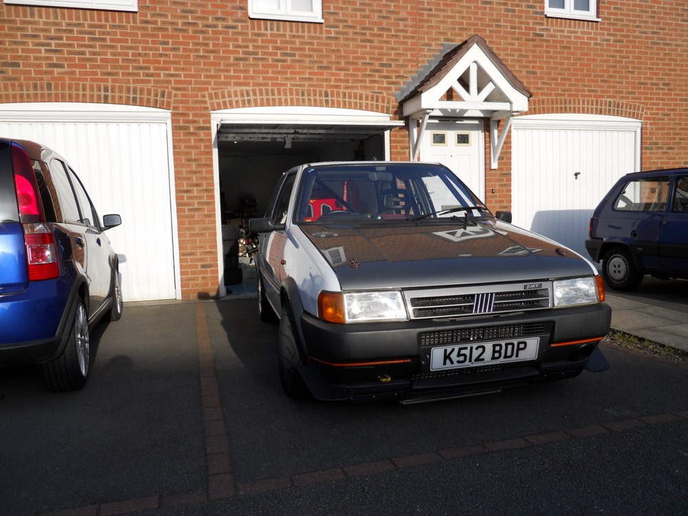

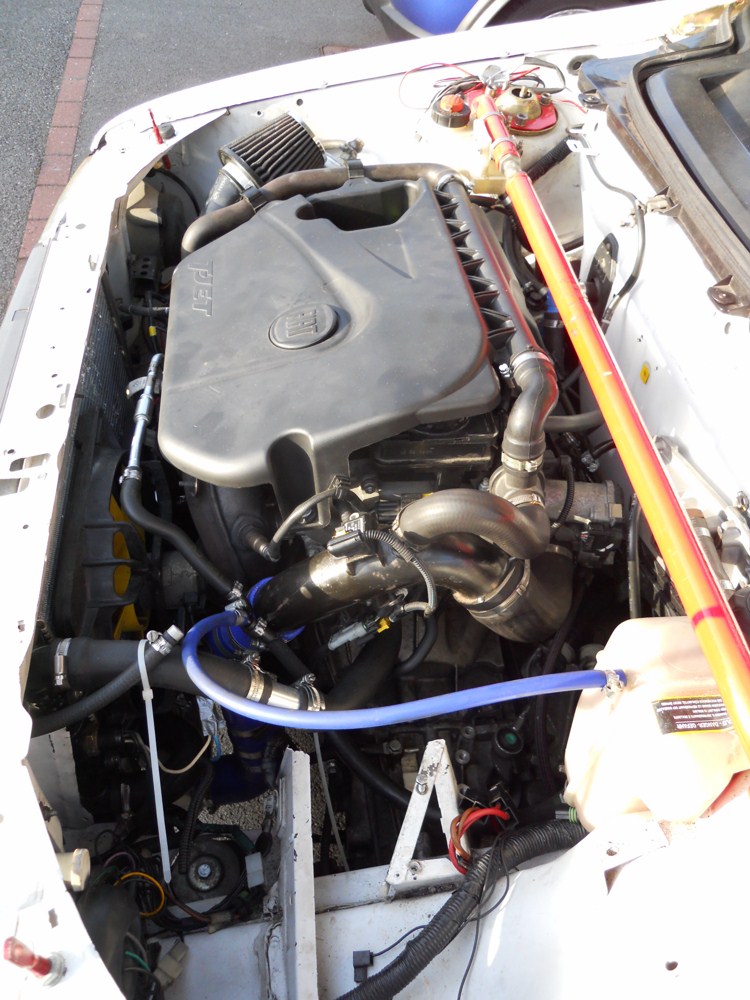

Here is what the car is looking like now. Quite a few finishing jobs, particularly loose and temporary wiring. Dashboard will take a while to sort in general.

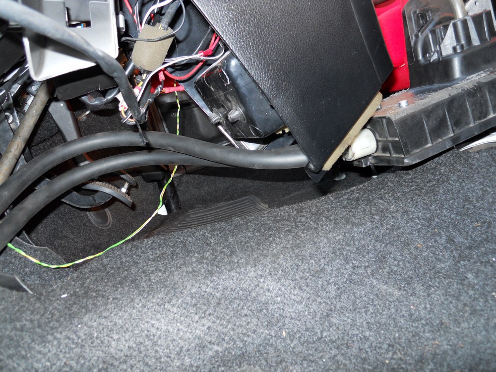

Bowden cable gear change

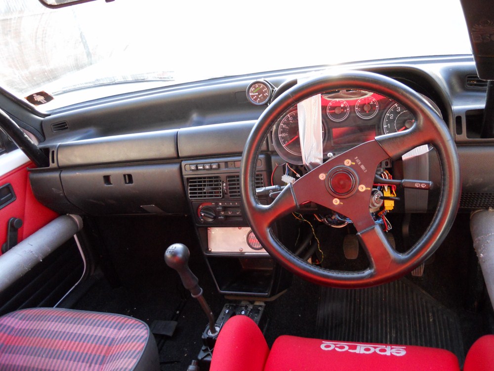

Bravo dashboard gaffer taped over UT dash, only useful for coolant temp, oil pressure warning and rev counter. What more do you need?!

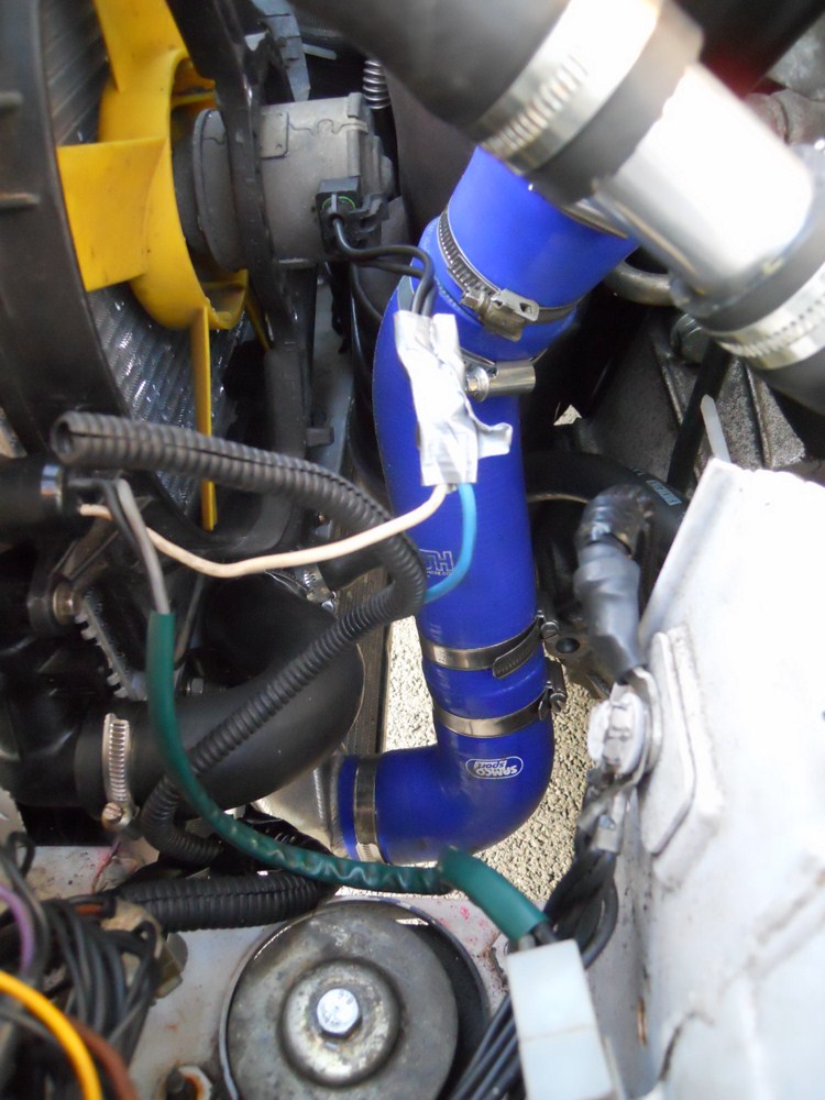

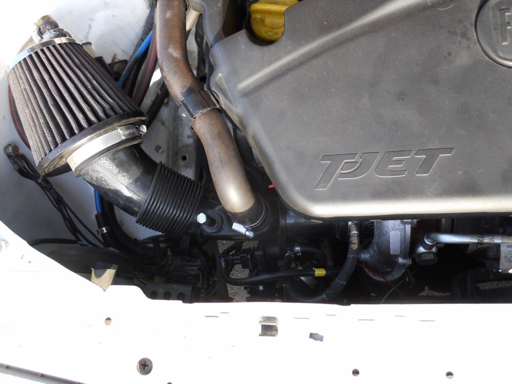

Engine bay

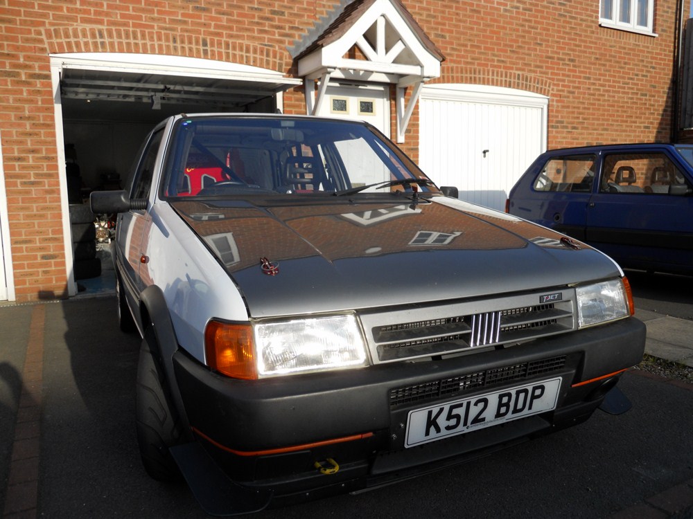

General look and grille badge
