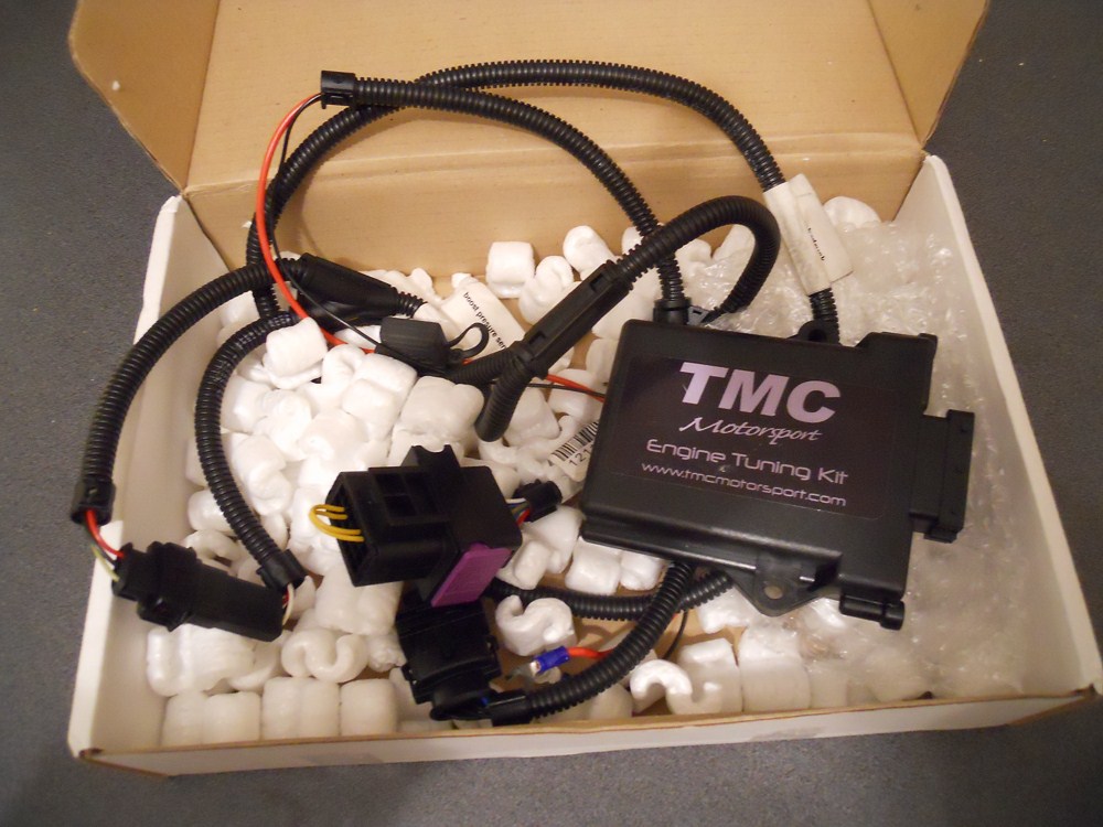

In other news, I bought a TMC tuning box second hand for around half price, which seems like the cheapest pretty safe power one could ever buy. Should be looking at 180HP and 180 lb/ft torque, which will do fine for the first stage of the tuning.

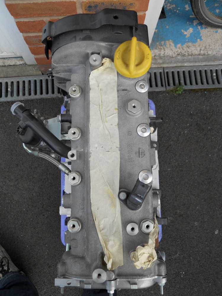

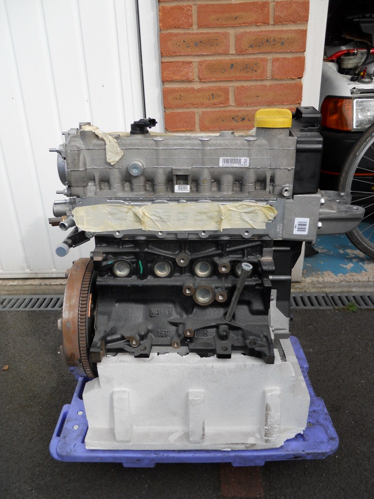

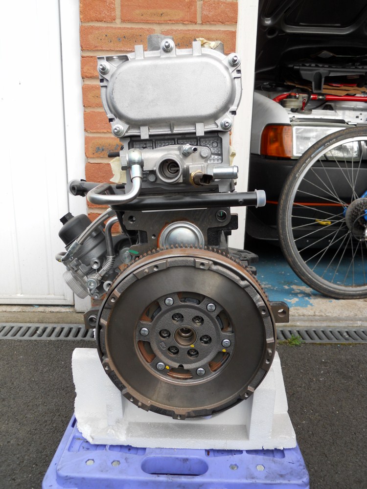

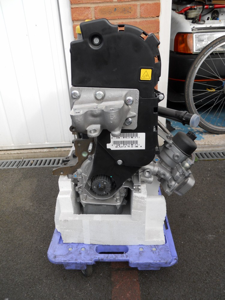

I went to collect another (and last!) T-Jet engine today. This one is from the last of the Abarth Grande Puntos before they went multiair. It is BRAND NEW! Part number 71751111. Not exactly sure what to do with it yet. Could keep as ultimate spare for the Uno or use in the Panda and sell 120 engine.
[/img][/url]
Blimey! How? where? have they got any 1.4 8v`s? how much?
Your a lucky man!
Wanna swap a 1.4 lump for my Tempra 2.0tc? lol :D
Your a lucky man!
I'll have a 1.4 16v from the 100HP available some time this year. All my cars have 1.4 FIRE engines in, so I don't need any other type!
I found on eBay not listed very well. £600. FIAT price is £4,500! They didn't have any other FIAT engines, they generally get Ford. They didn't know it was Abarth or indeed turbo. 1.4 8v engines are easily got and not expensive from my research.
