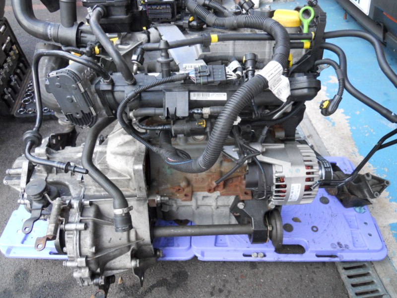

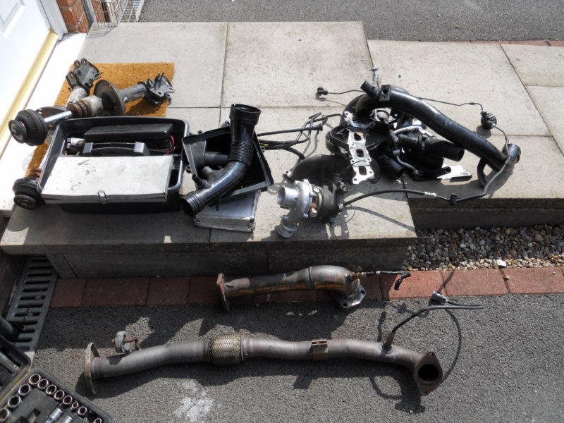

I just picked up a 30k T-Jet 120 engine and 5 speed gearbox from a Grande Punto. 4th gear syncro has gone apparently. Have all electrics, pipes, ECUs and electronics I need to make it run as if in a GP. I plan to make it all fit in and make it run initially.
Rough Plan
  • Engine goes in as is using Uno FIRE engine mount. Not sure if reach correct until full measurements done.
  • Fuelling and ignition by GP ECUs.
  • Unlike my Panda, I'm just gonna do minimal wiring to it to make engine work and leave all other electrics standard Uno.
  • Uno instruments will remain. Need to find way of making rev counter work.
  • Gearbox will be a hybrid of the UT and Punto, to be fitted on standard UT mounts.
  • Driveshafts will be standard UT with a small mod to the intermediate shaft bracket required by my calculations.
  • Have a Ragazzon de-cat downpipe and standard front pipe that I'll bodge onto my exhaust for now. Don't need a cat for MOT, due to age.

So, onto business. First thing I need to do is make engine and gearbox physically fit and connect drive.
Reason I wanted a 120 GP T-Jet and it's unique 5-speed box is that this box is the old C510 gearbox that the UT uses (also Tipo, Tempra , N/A Coupe, etc). It has the key component that hasn't been available in this box type yet: a FIRE-mating bellhousing. It will theoretically just drop in on UT mounts and mate to the engine. I hopefully then just need a Uno FIRE engine mount on the other side. Reach could very easily be an issue here of course, I haven't done the measuring yet. Mount is being posted to me tomorrow.
Next bonus is that the intermediate shafts will bang into the diff housing and on the nearside that driveshaft is taken care of at least. The other side has the long intermediate shaft in a bracket. This will go in and the bearing on it just pops straight in the new FIRE axle "bridge" bolted to the engine. This was the bit I was counting on and it seems true. Problem is the UT shaft is 10mm shorter from the bridge to the diff than it should be, or to be precise the bridge is mounted 10mm too far away from the diff than I want. I need to re-engineer this bracket some how. I think it's possible. Drive will then be sorted with standard UT shafts. Sweet.
I have a Quaife LSD in my UT box, the end plate is different to allow the UT mount to be used and it has higher final ratios than the "new" GP box (which I like), so I'm basically going to remove the bellhousing half of the GP box and put it on my UT box. Almost finished this earlier, but was more complex than I thought. You really have to seperate the gearbox into main component pieces to do this, indeed to change the diff over you'd have to do this. Bit of a nightmare in comparison to the trusty C514 boxes where you can change a diff whilst it's in the car! So now I'm staring at the lay and mains shafts, I am dreaming of perfect ratio combinations. Not sure what to do. Leaving standard is probably the right decision though.
Need a careful session in the near future when taking apart my UT box, because I have been pretty gung-ho with the GP box since I won't be putting it back together! It has struck me that there is every chance it just doesn't fit on the UT box for some reason.

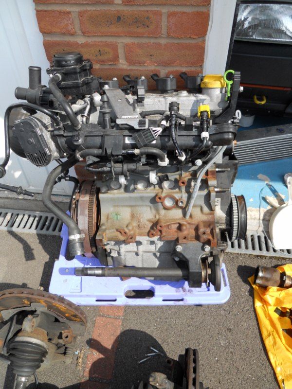

Stripped gearboxes down and made a hybrid gearbox like I said. After totally dis-assembling the T-Jet box and realising I need a few things to do it all properly I decided that I would go for a "two stage" build. I am going to use the T-Jet box almost as-is with the addition of the old selector rod mech and old end plate with old style mounts on. So no LSD and a lower gear range. I could see the damage on the 4th gear selector ring. Syncro is actually in fine condition, so I don't know what that means. I reckon it will change, but not be perfect.
In fact I am going for a two stage build in all aspects of the car. Plan is to have it ready to drive by Nov 14th for a trackday at my nearest track Mallory Park. I will then remove the engine and box again and do a few things differently. I will also significantly improve power with a better turbo and a few other bits over the winter period, ready for a remap and a season of trackdays in the spring I hope.
Anyway, I married the rebuilt gearbox up to the engine and have started to dress the engine. So much stuff to put on, it takes longer than you think! Initial measurements between mounts look in the ball park, but quite hard to tell until actually in it. I bought a engine crane today, but by the time I got it home, the day was done. I may try and fit it in an evening this week. I got a new genuine alternator from eBay for £50, which I thought was good and bought an alternator bracket that goes on the engine from local dealer (was air-con model).
As you can see, the Uno intermediate drive shaft is a good fit. It just sits 10mm too far out of the box to just bolt up to the driver side drive shaft. It is actually engaged on the splines in the differential, but only about 10mm or so. I'm going to have a fabricating friend have a look and see what the best course of action is.

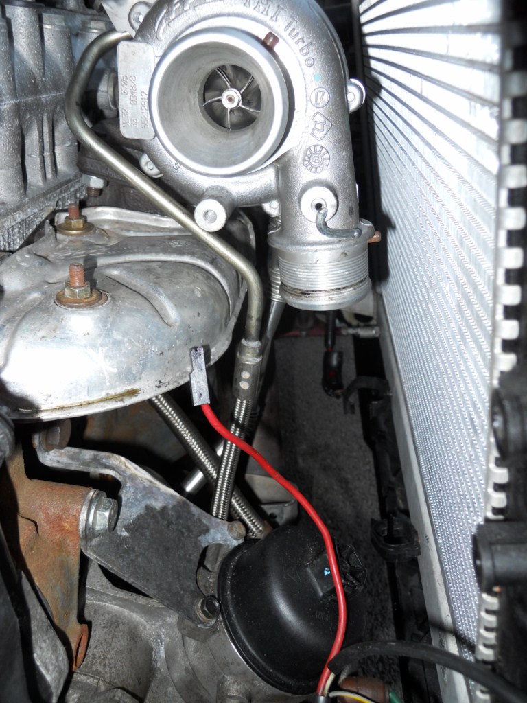

Yeah, so I couldn't resist and spent all day sort of carefully putting the engine in.
It fits! The intake is closer than I thought to the bulkhead and the turbo is pretty close to the manifold. So all in all, pretty bloody lucky. There is a lot of pressure on the engine mount, which I spaced out about 8mm with the nuts you can see. Hard to say how bad this actually is until I loosen up the other mounts and see where is wants to sit. The engine mount is certainly too high. What you can't see is that the bolt that goes through the rubber is facilitating around a 20mm gap underneath with the nut on the last bit of thread.
As turbo is so close and the turbo I want to fit in the near future is slightly larger, I will look at mounting the fan on the front of the radiator. Seems feasible to me.
