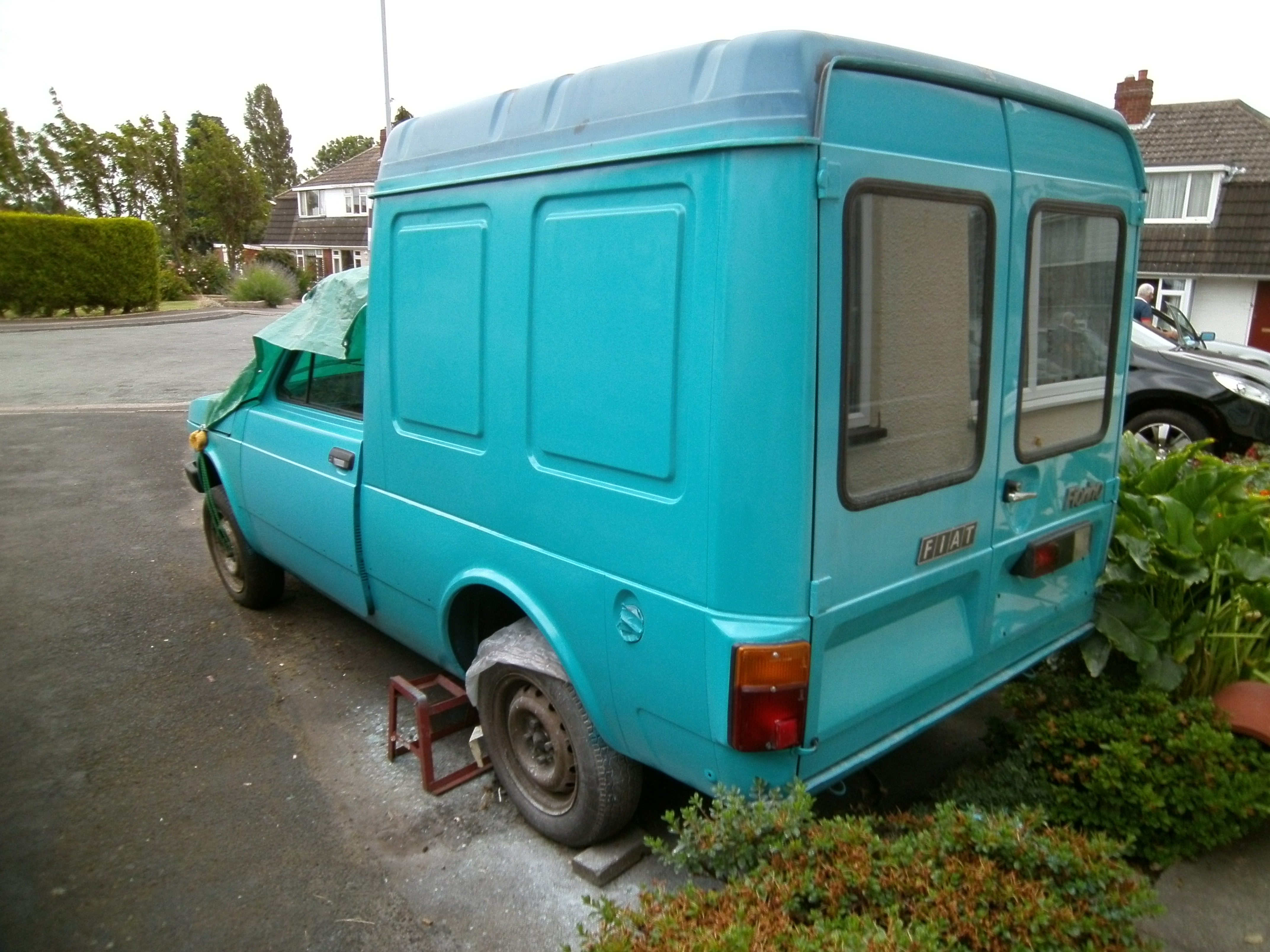

I know it might look like a bit of a shed at the moment but life would be nothing without imagination and dreams. So imagine that this is pristine in it's original colour of Bleu Fiordo (torquoise) and dream of it purring down the road. I do......

Let's see if I can post a few pics the right way..........
There you go, double for your money:D That'll teach me not to "double-click" on the pics:eek:
That's better I can see them now! (y) You were getting overexcited with the clicking weren't you?!

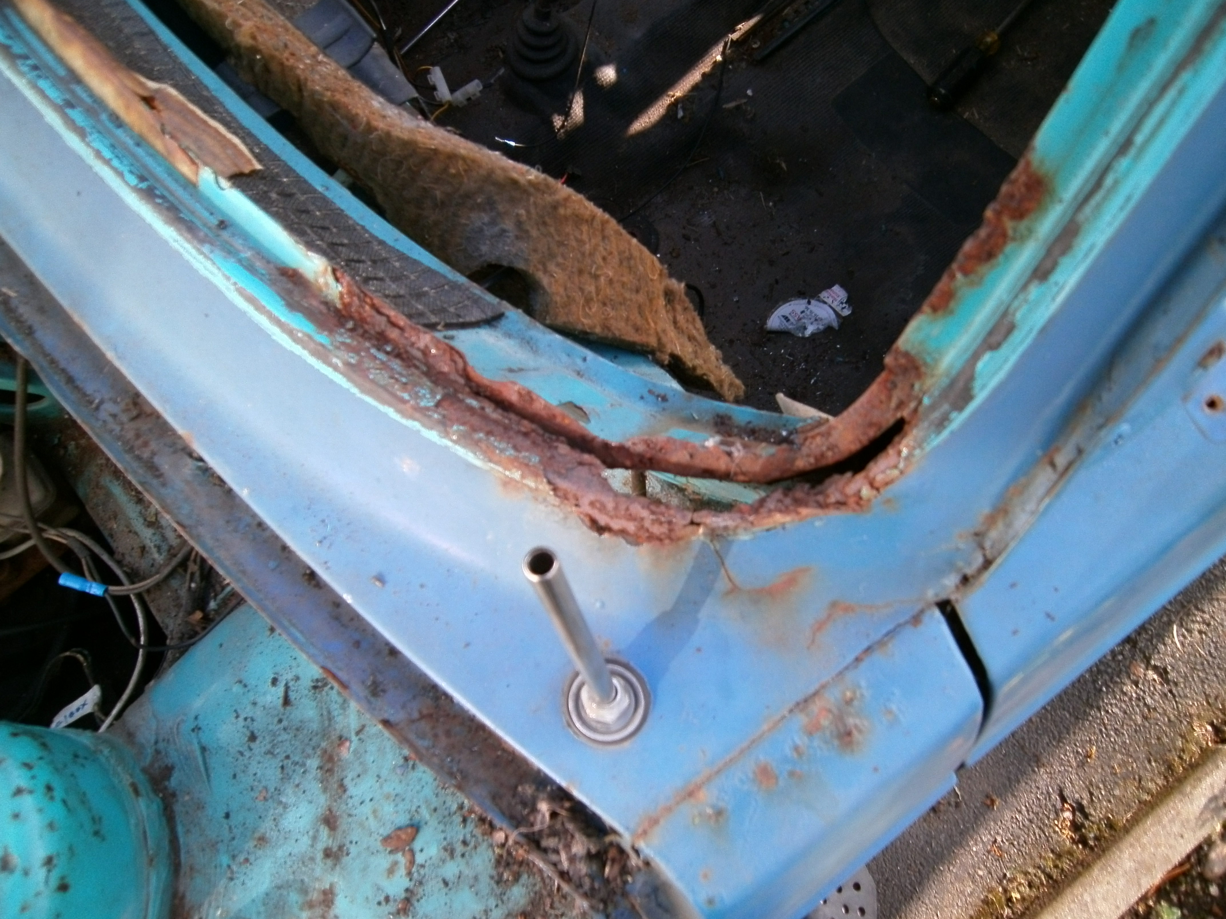

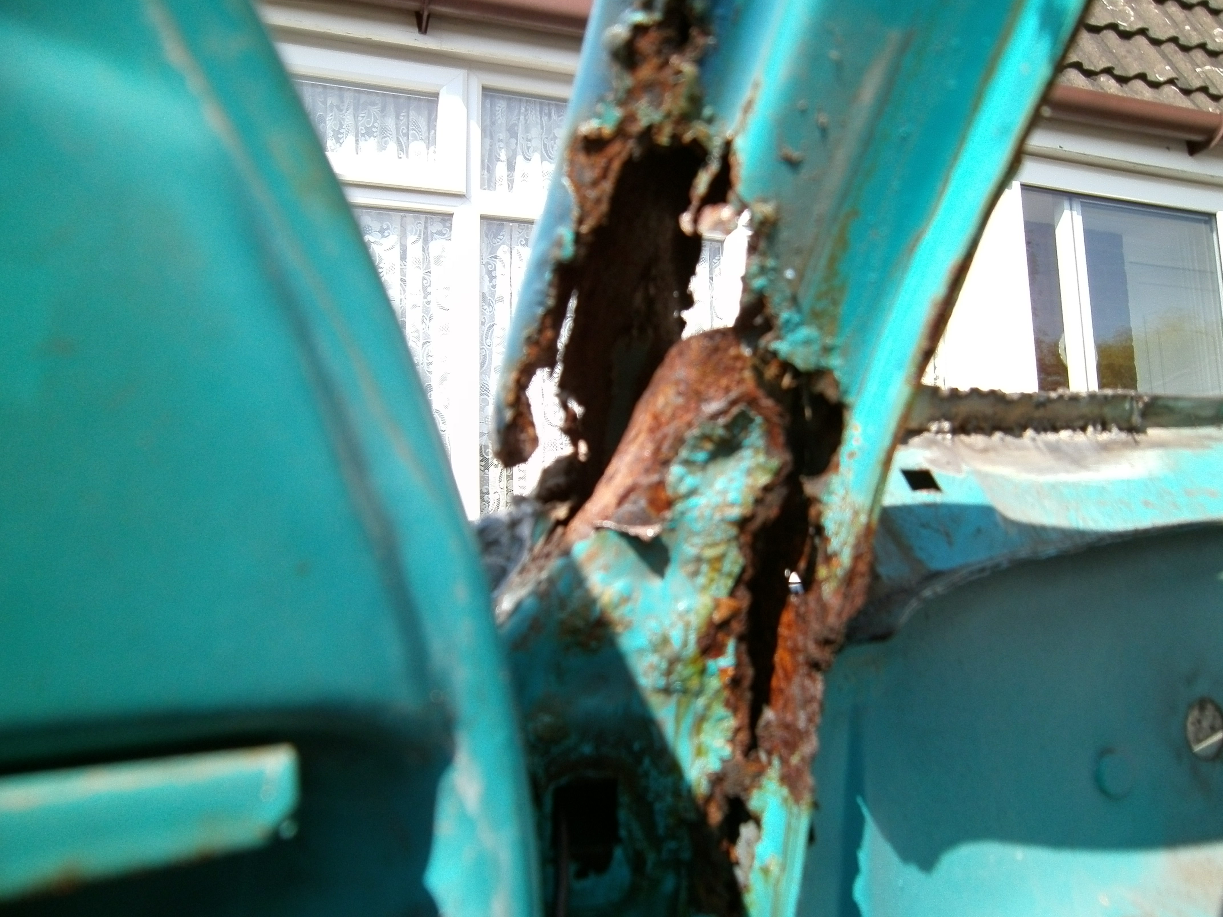

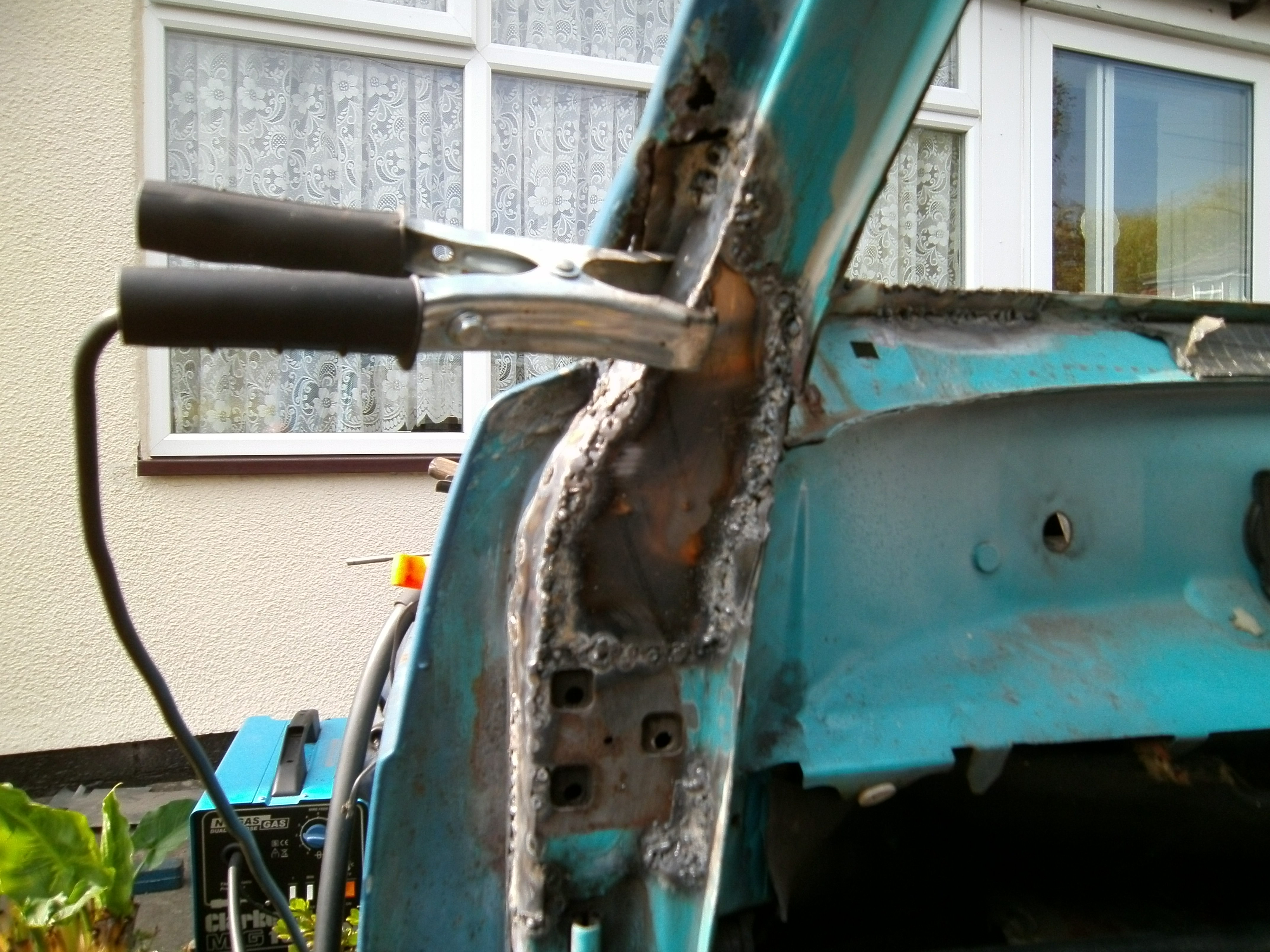

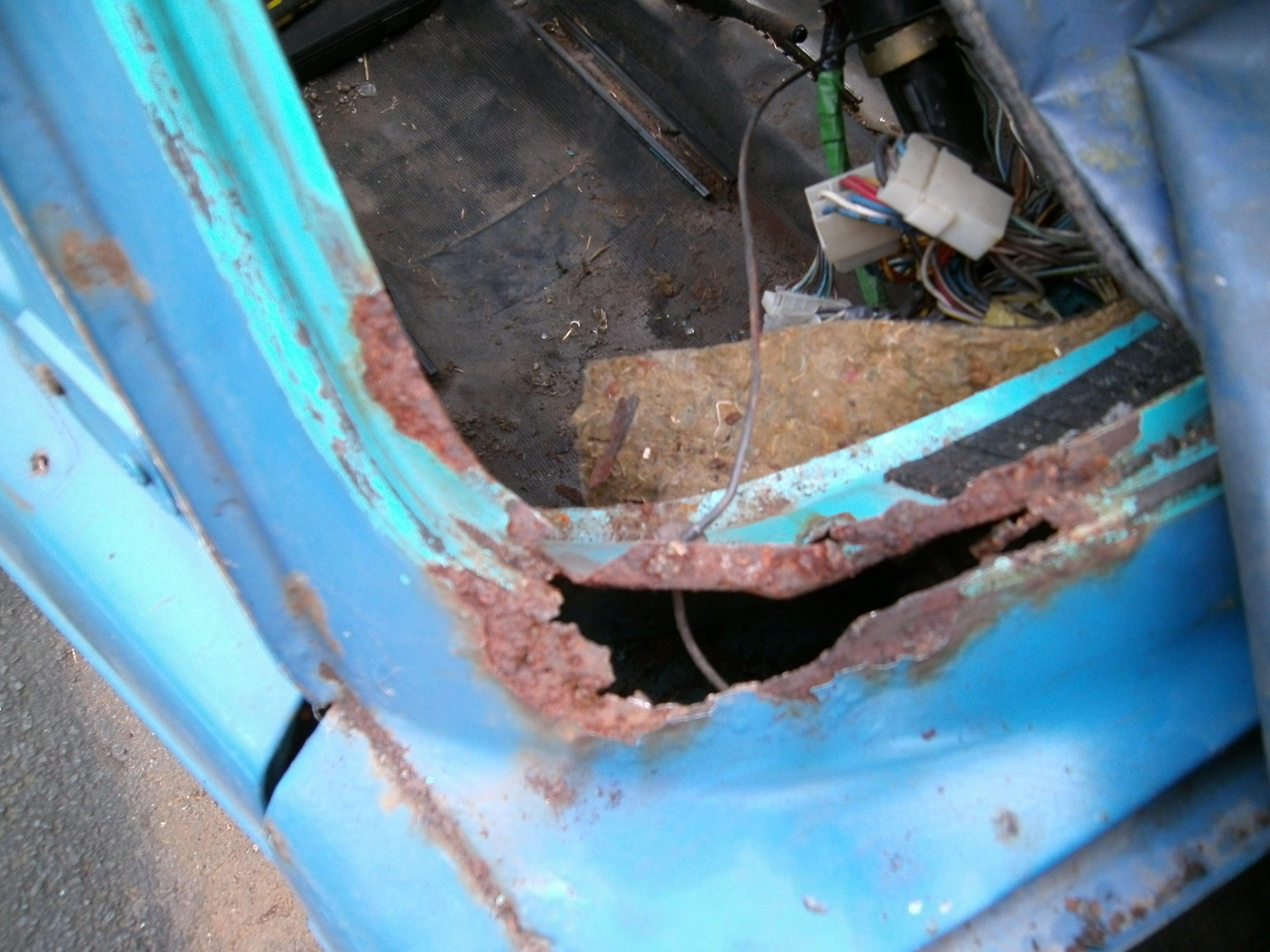

Looks like there's a bit of work there, but probably no more than you were expecting. The door jamb was a bit :eek: though.....

I know that rot looks daunting but that can all be fixed, as you have shown. Amazing to think this is being saved as commercial vehicles just do not see preservation in the same numbers as the cars they are based on. Makes sense as vans are a tool and abused...

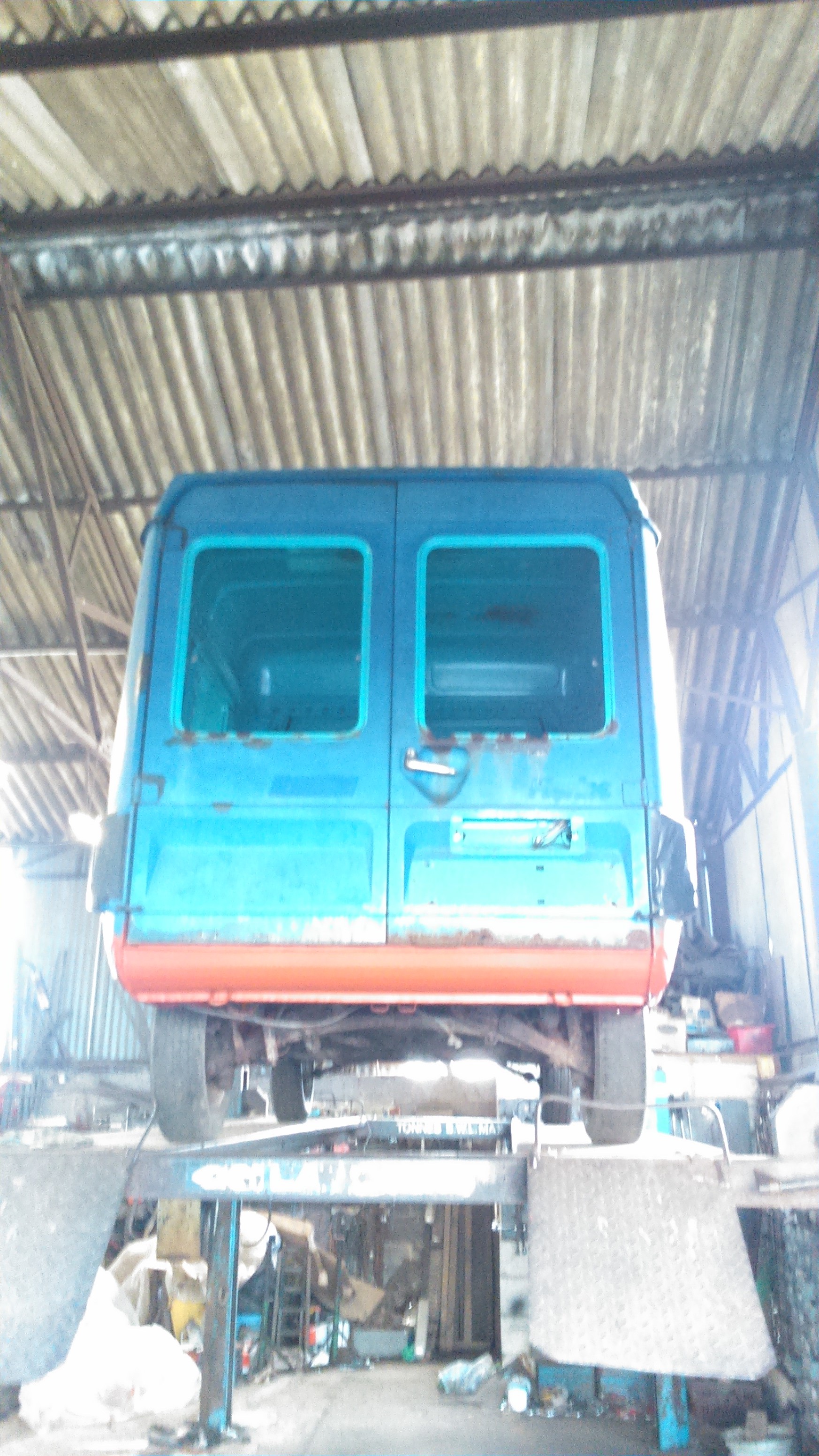

Fiordo is also the original colour of my 900T Citivan, which I finally trailered over to the paintshop this morning...

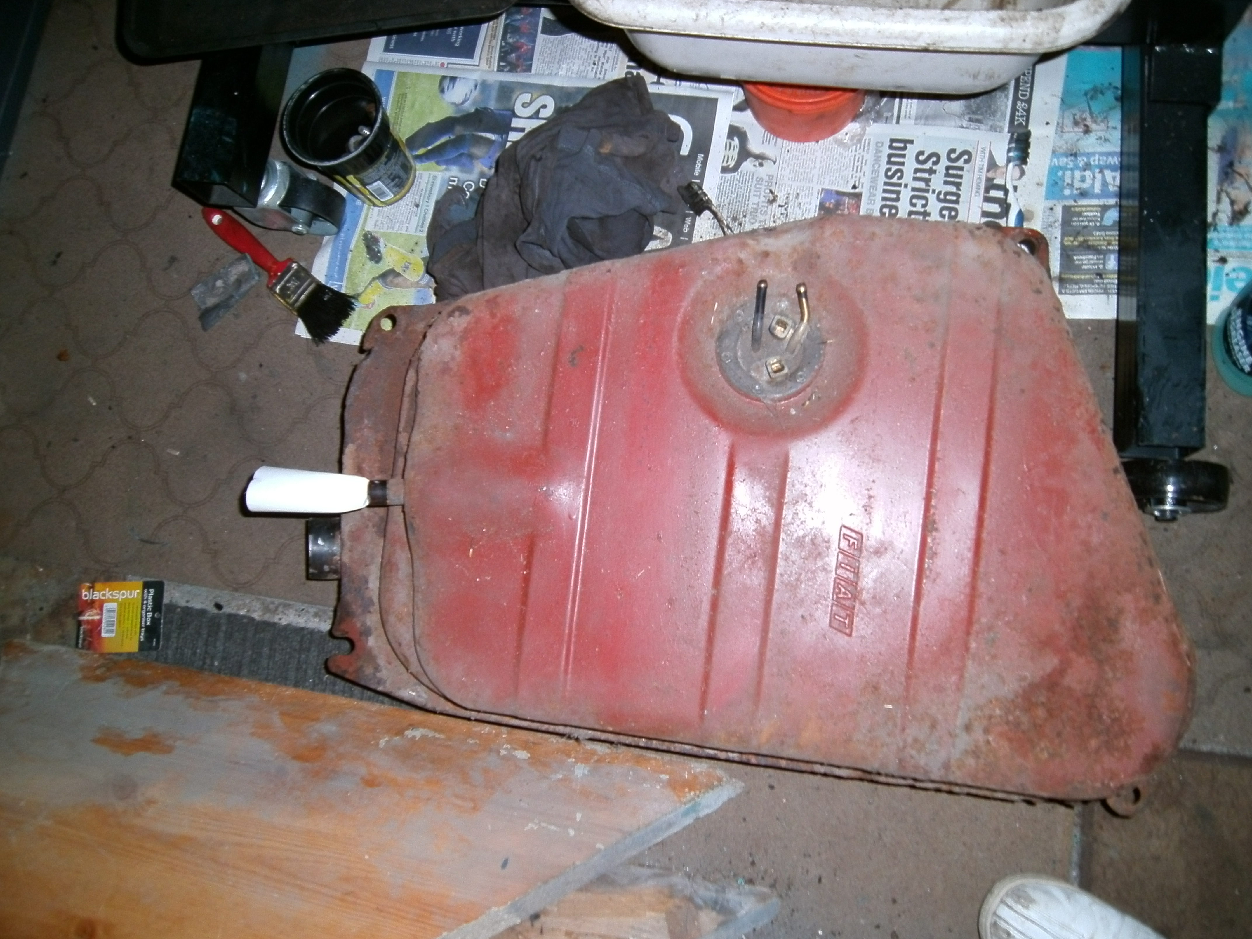

Now that the petrol tank is out it looks like it will need replacing. I checked out this one but apparently the supplier went bust :bang:
http://www.aaronradiator.co.uk/catalog/Fiat_127_Fuel_Tank-1675-1.html
The search goes on, but if anyone has a tank lying around????
There are two on ebay but they are not the right ones.
http://www.ebay.co.uk/itm/FIAT-127-...arts_Vehicles_CarParts_SM&hash=item35dffa8630
I have tried to attach a pic of mine.

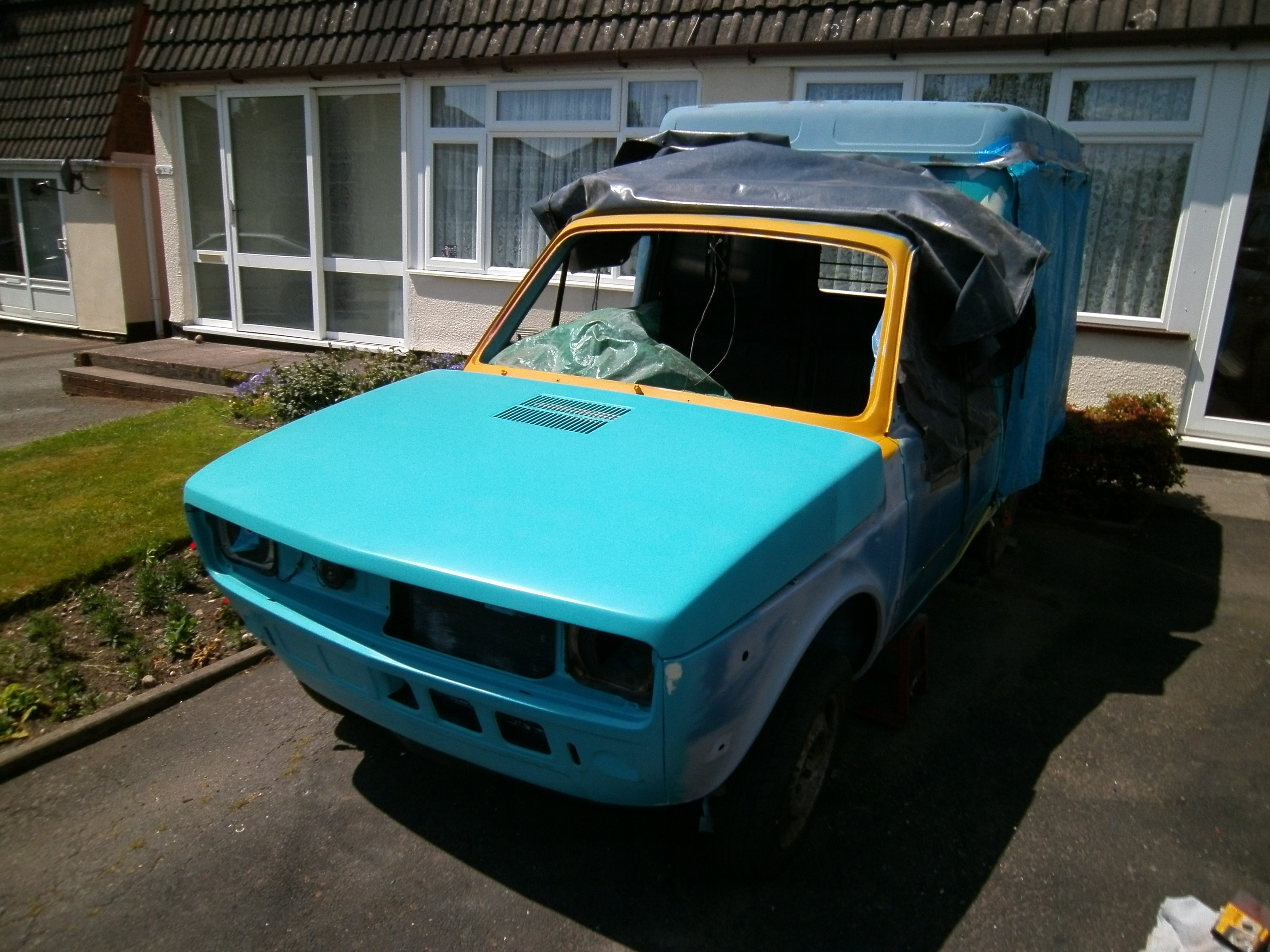

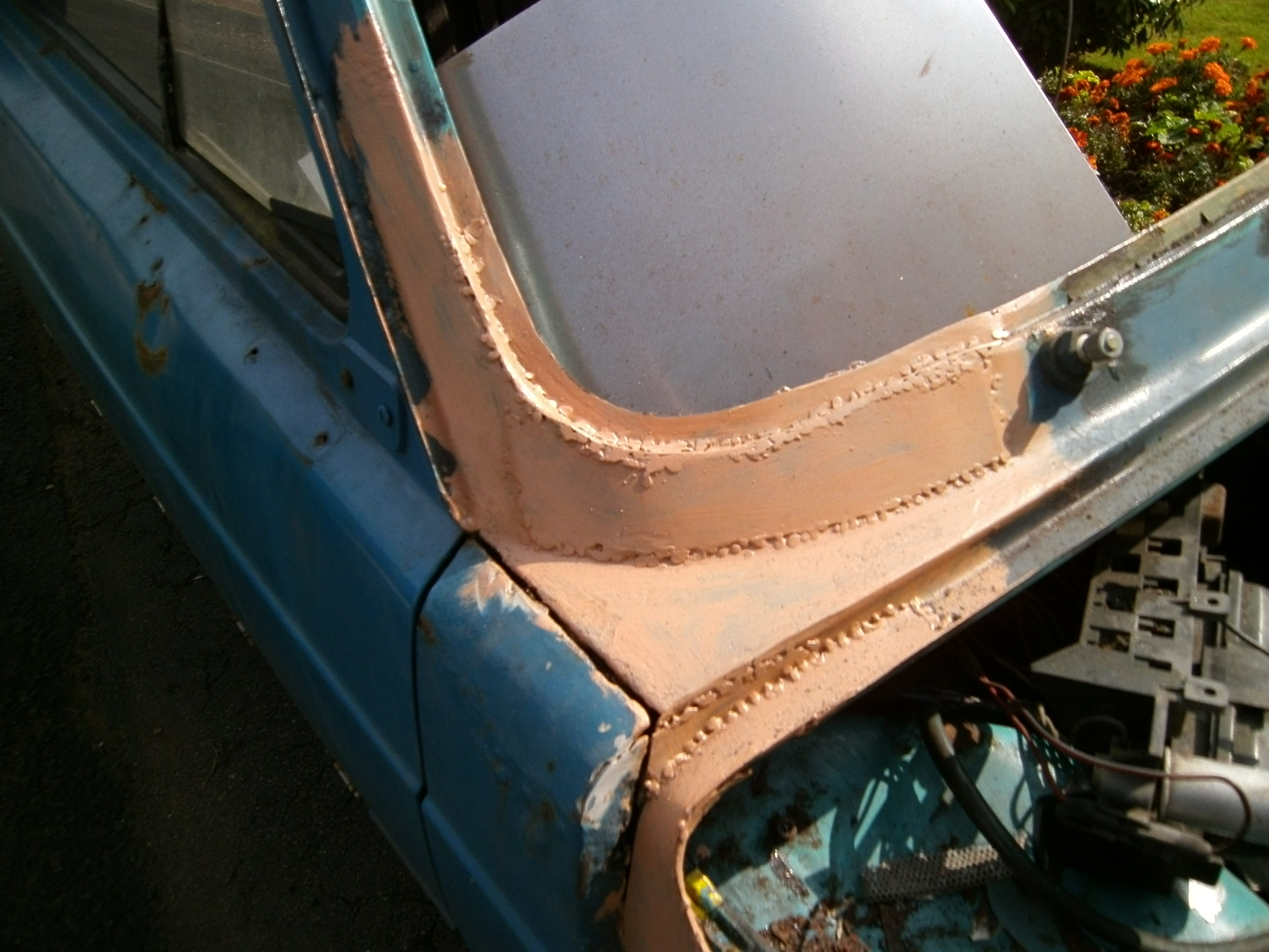

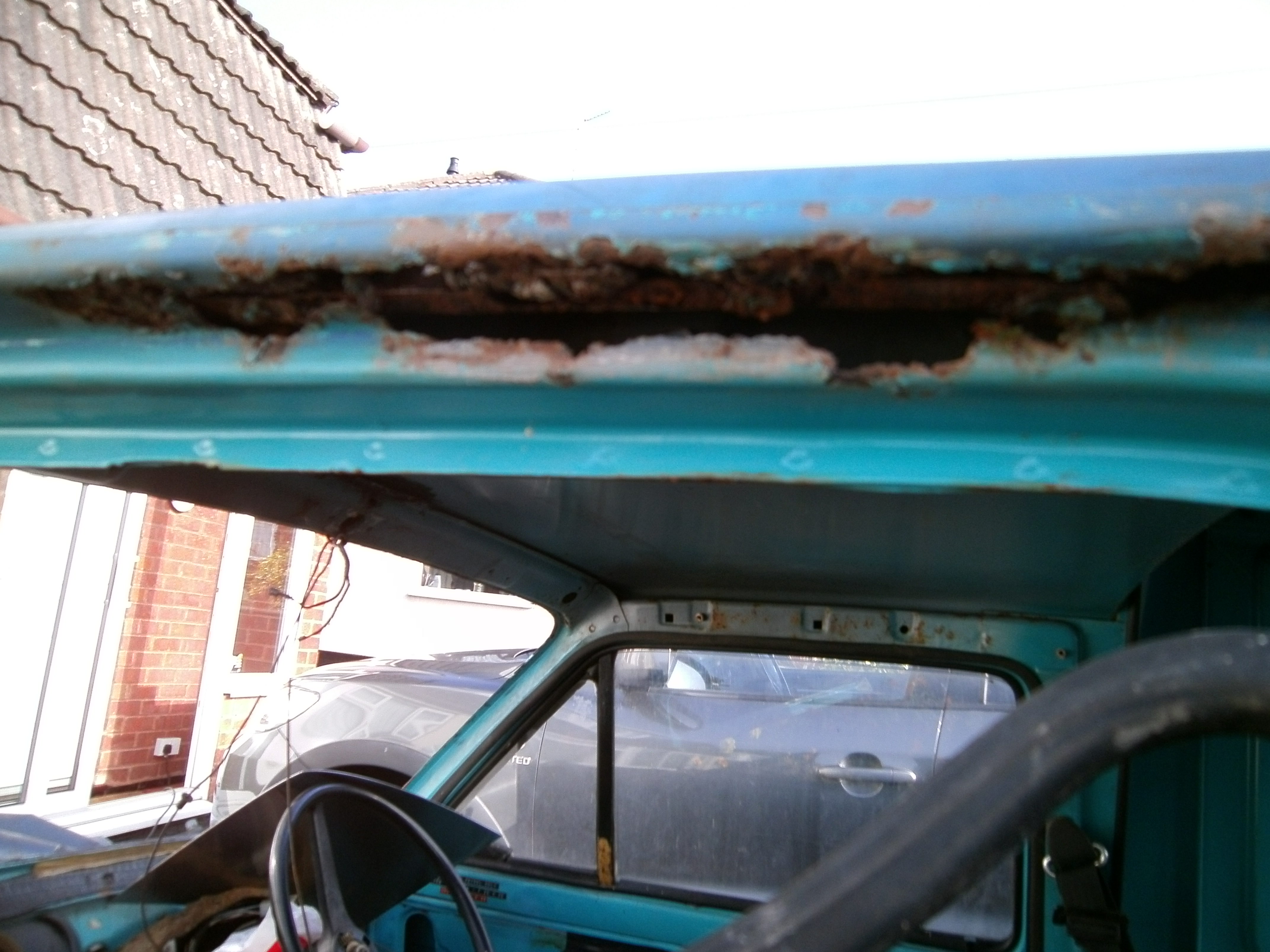

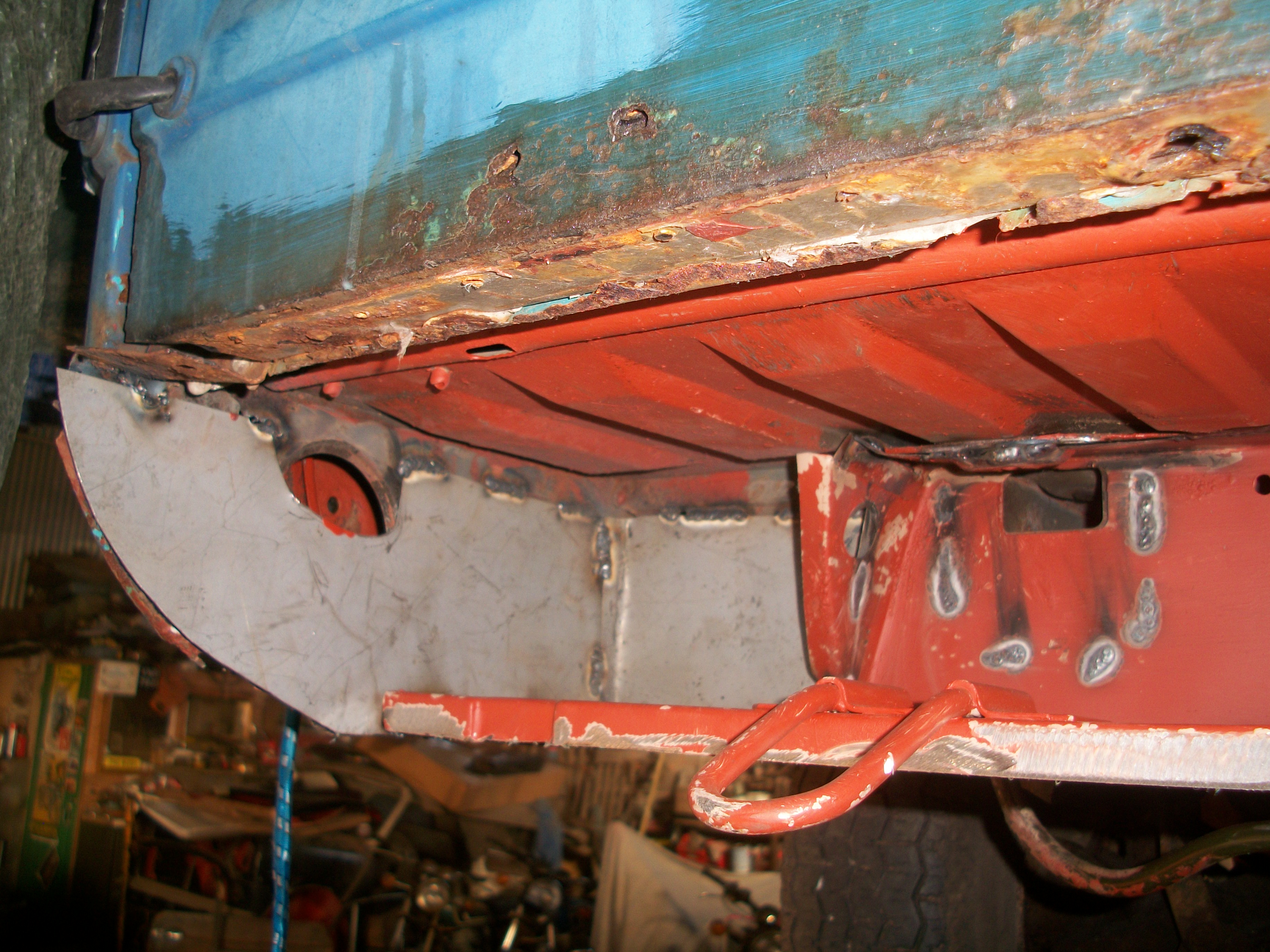

150 hours of welding and we are beginning to see some light at the end of the tunnel. It may be the tiniest chink in the corner of a big dark hole but it is encouraging. As expected everything that could have rotted did.
It now has new front panel, wing, rear panel, sills, rear arches. I have four new doors and a bonnet to go on, and anything that couldn't be replaced has been/ is being repaired.
Well work continues on the Fiorino. It's nowhere near done but there is some hope:bang:

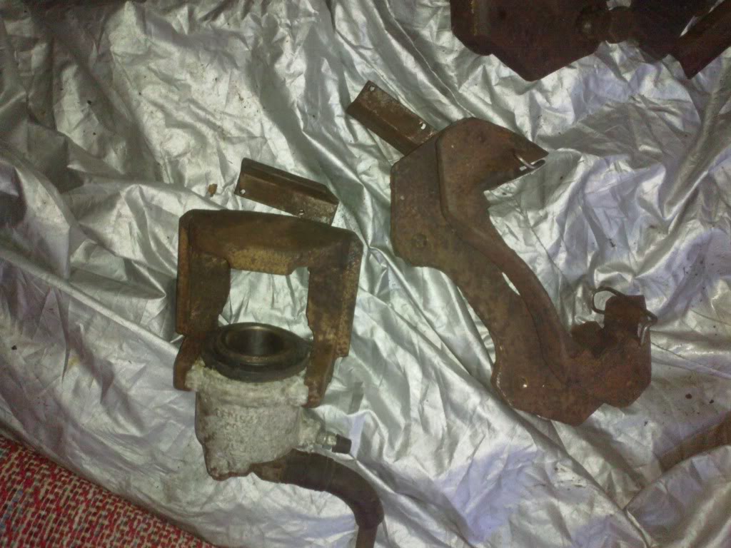

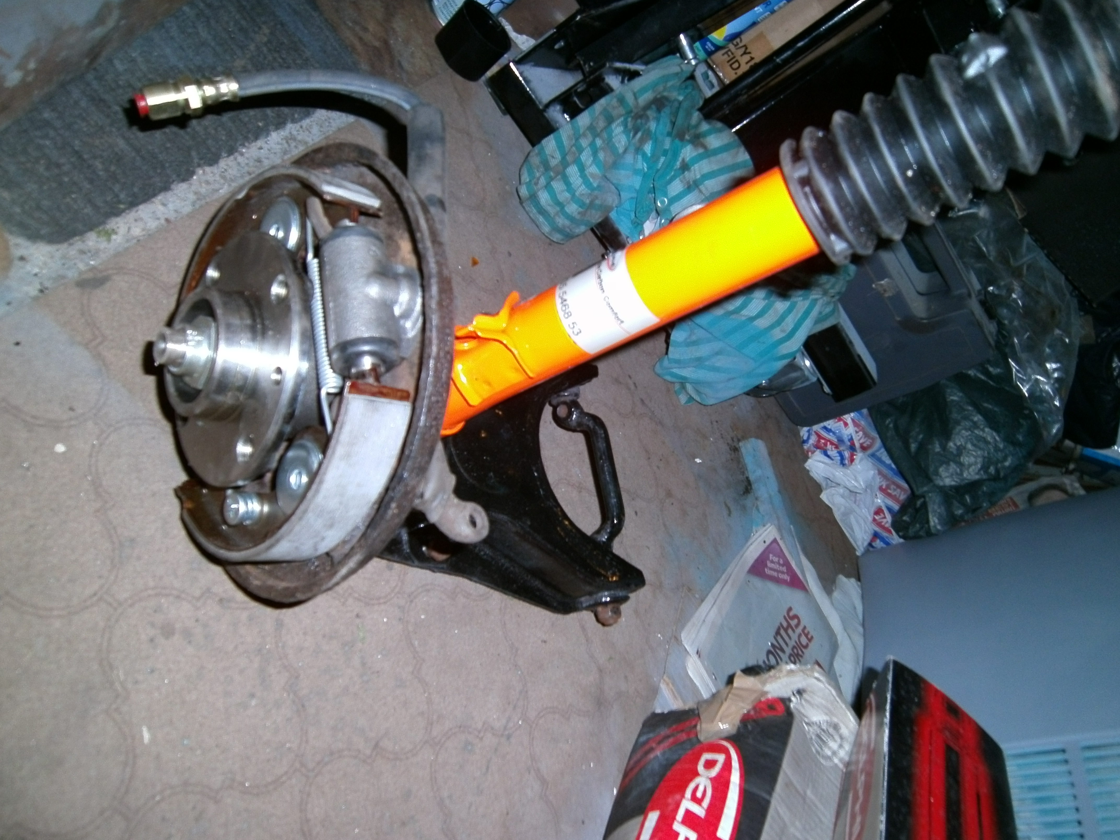

The engine is back in, albeit untested. All the suspension and brakes have been replaced. The back doors and the bonnet are on and I am starting on the sides. Still have to put the windscreen back in and the interior, plus the new front doors, but it's getting there.

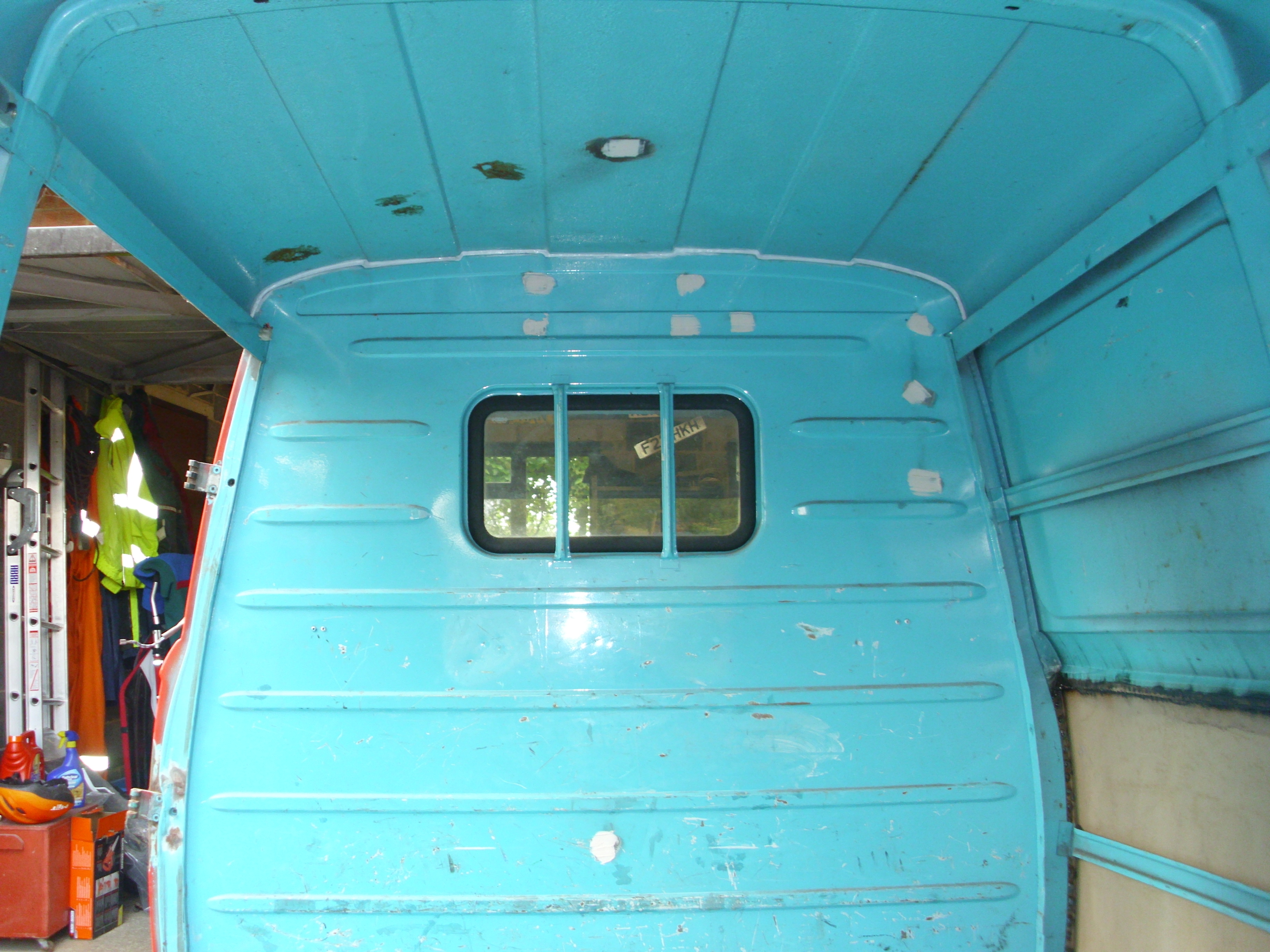

The Fiorino continues to make progress, but I am getting more frustrated with every job I tackle. The windscreen went in like a dream and the rest of the interior is back in. I filled the engine with anti-freeze and it leaked out of the water pump. It was obviously an internal seal as the water was coming from the shaft rather than the gasket. With the engine out it's a fifteen minute job to change the pump. With the engine fitted it was a two day job:bang:

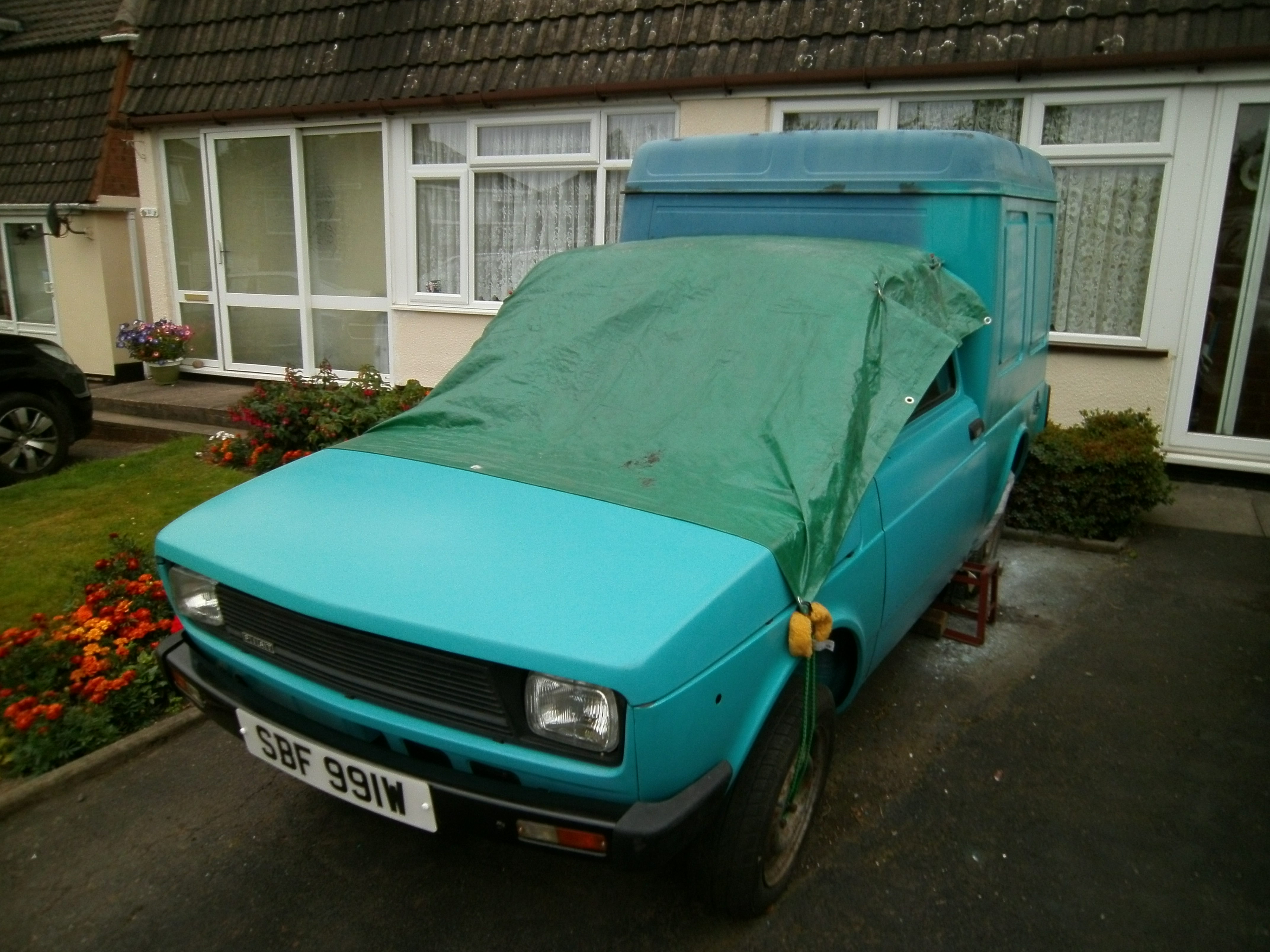

I've started to fit the passenger door, but my welding on the A-post has obviously left the top hinge mount slightly out of alignment so this will have to be redone.
The bonnet and front doors, which were painted in the winter, are a different shade to rest. The paint is the same supplier and code so I can only presume that the cold weather affected it.:confused:
That doesn't matter too much as the whole van needs smoothing off and a proper spray job, but I was hoping to have it looking half-decent for the Van & Pick up show at Gaydon on the 9th August.
This was the target that I originally set myself for the re-commission (not restoration) and I think that it may have been a little ambitious.
