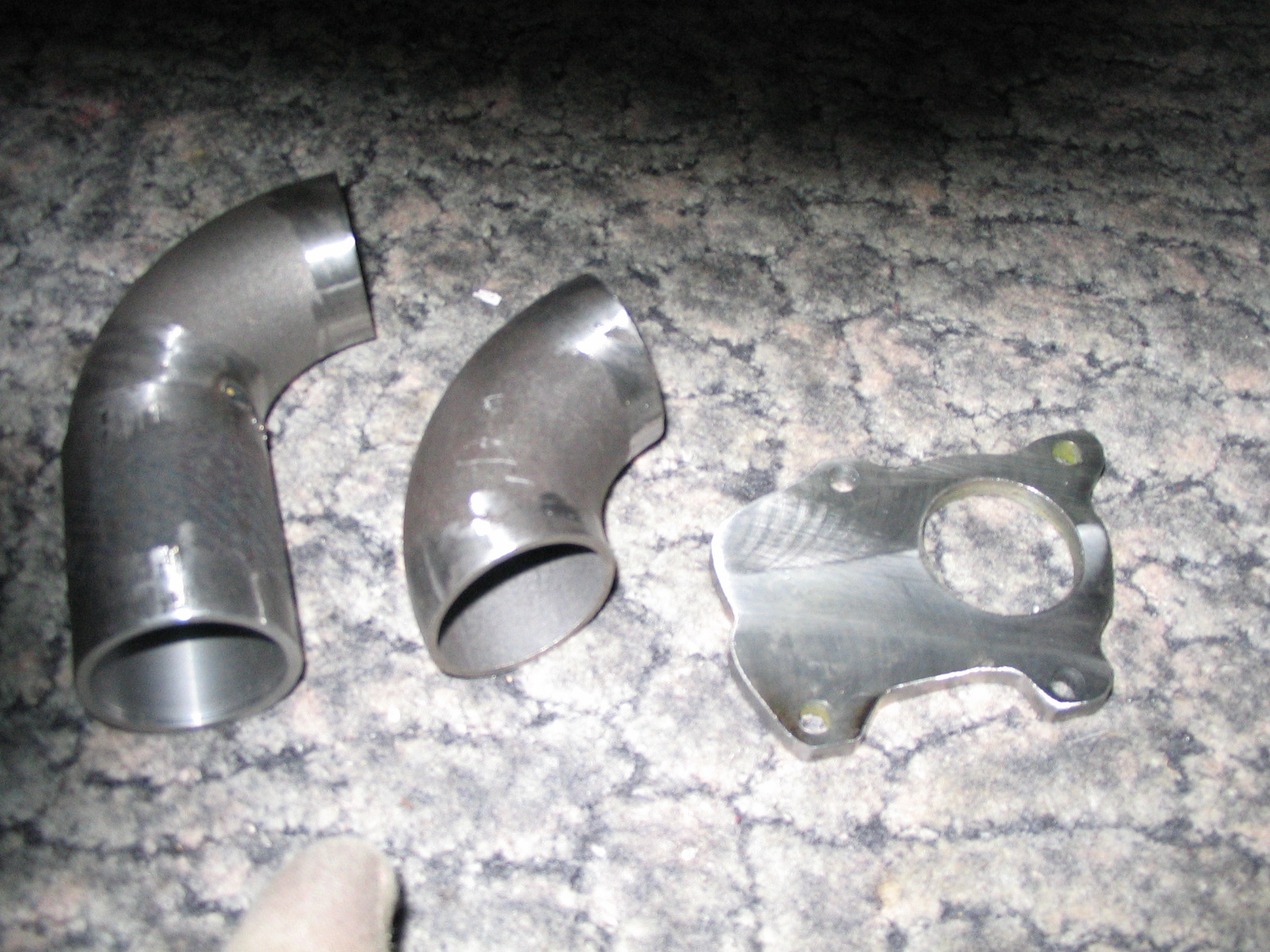

Turbo elbow parts:
Exhaust flange fitted:

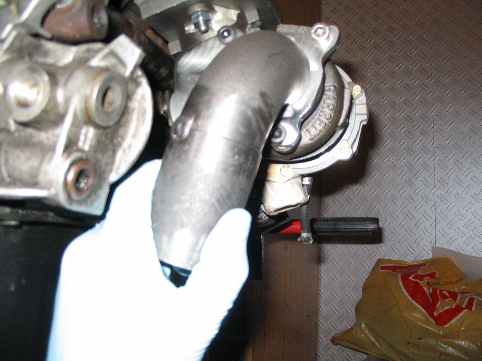

Now, the thing i need to know is should I take the exhaust pipe off of the turbo pointing straight down to the floor? like in the 1st pic below. Or should I take it off towards the engine? (as in the 2nd pic below)
Also when i put the bottom elbow on to the exhaust pipe do i want it pointing the same way as the one going on to the turbo exhaust flange? or does it want to be angled towards the clearing on the bottom of the sump?
Thanks in advance!
Lenny (y)
all depends.... if you want one like alex old cinq then poin it near the engine just means you cant get oil filter on and have to use a external filter relocation kit, or have one like mine away from the engine so it allows you room to get filter on/off ;) without need of a relocation kit

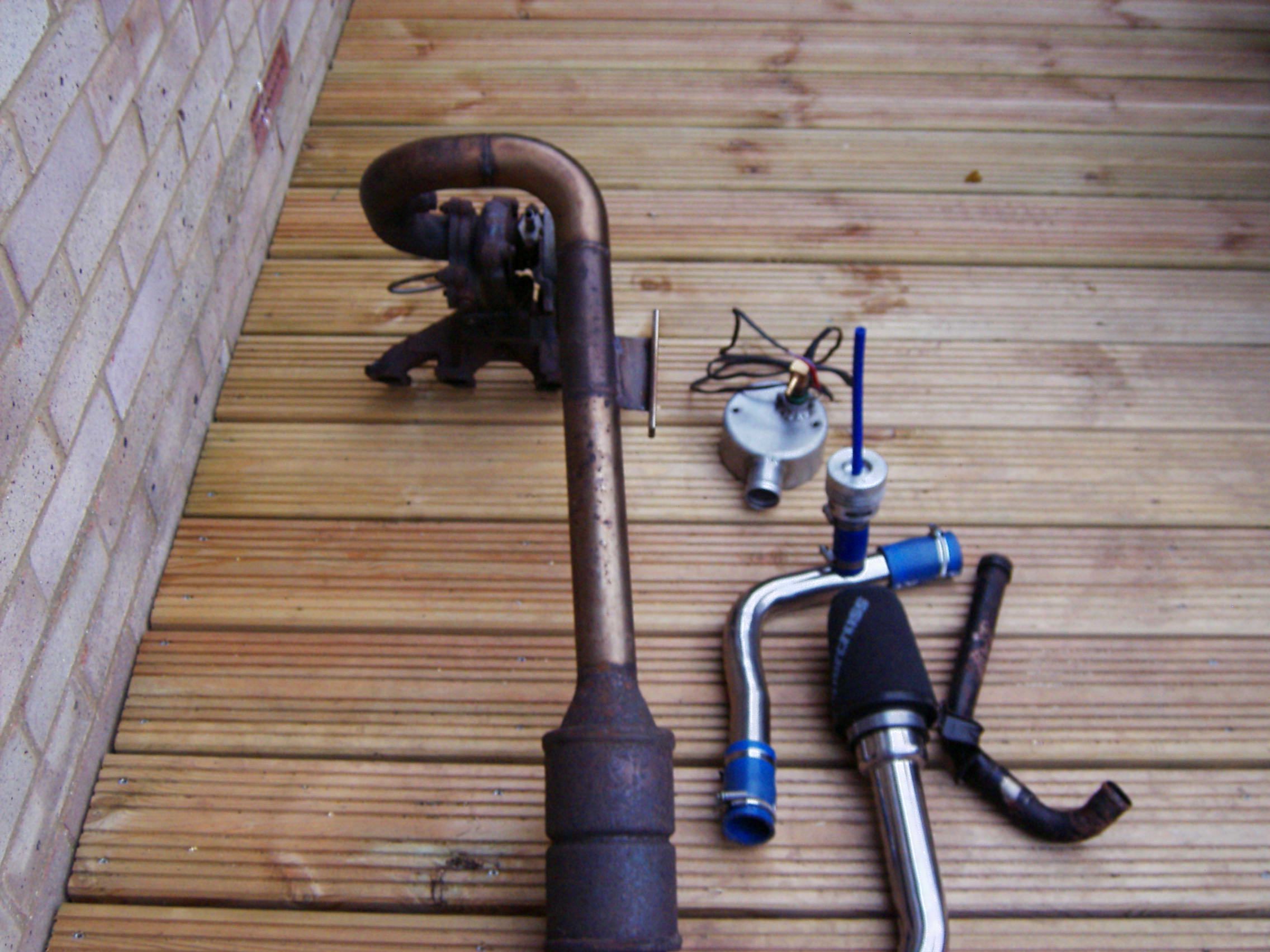

Some of these pics may help with the exhaust. I guy sent the to me,he was selling the kit,i i lost out:rolleyes:

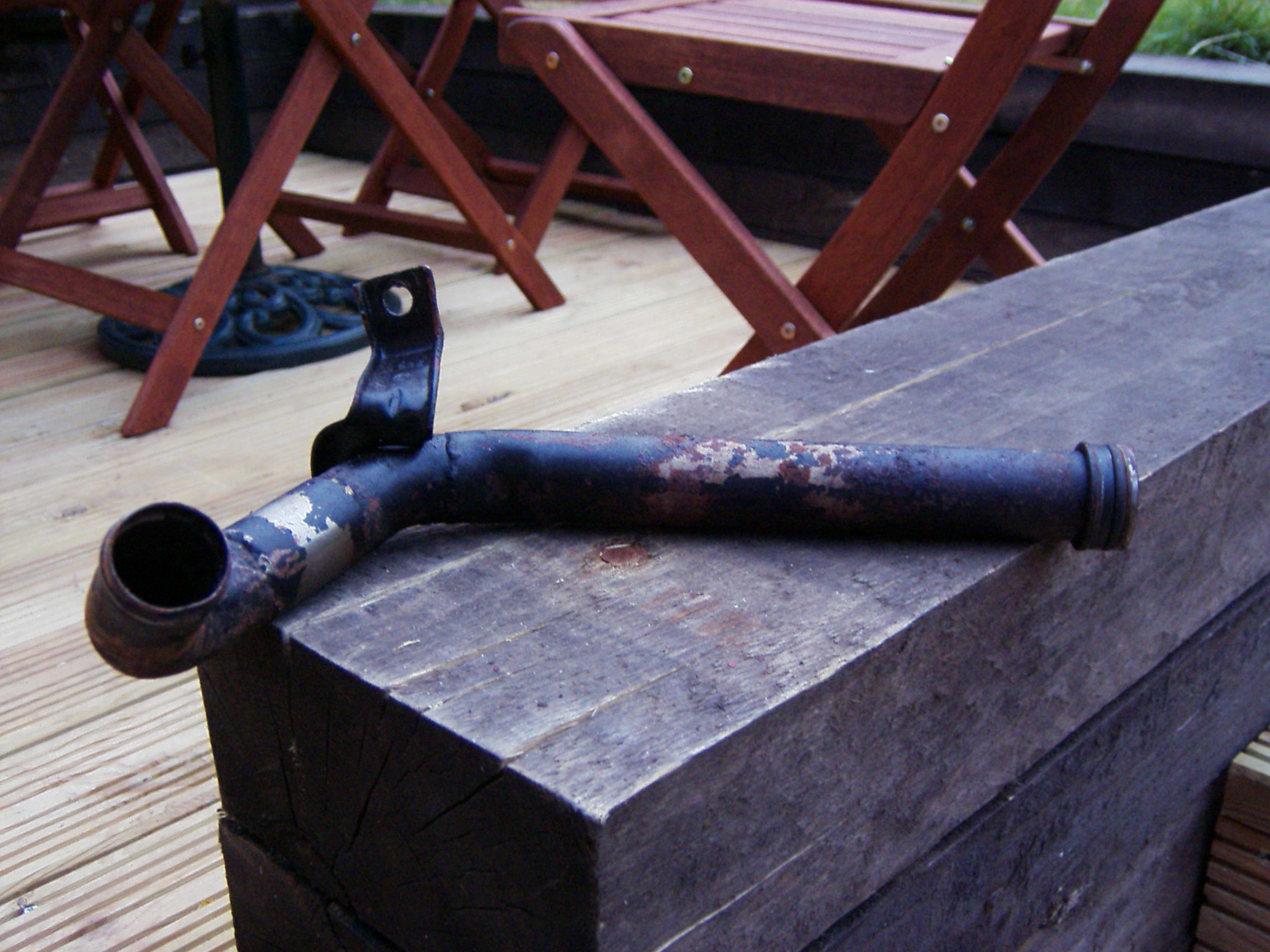

Thanks again for all the comments, just need to wait for the oil cooler parts to be ordered now, can anyone tell me if I need to modify the pipe coming from the water pump? (as on the pic that Brooky posted up on the previous page)
