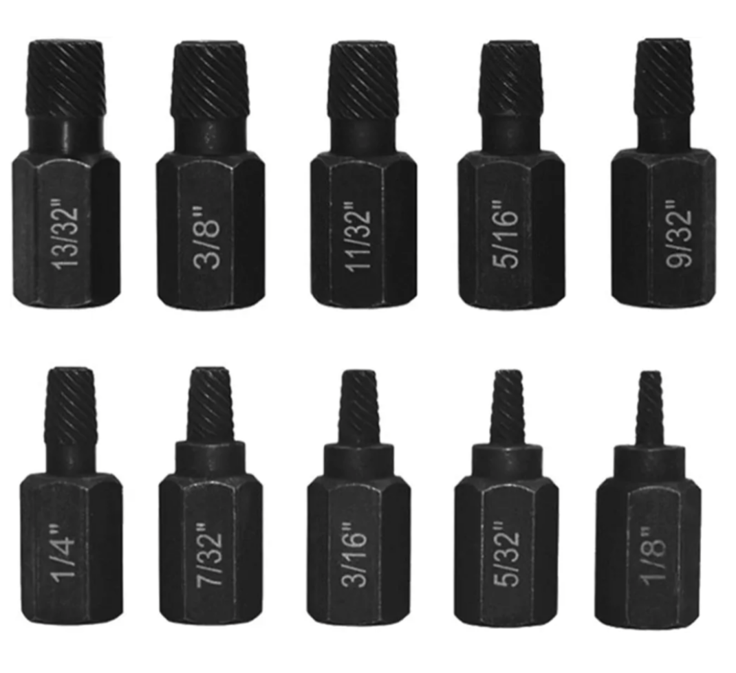

Something like this may or may not work
Cutting the head off and drilling and hammering in an easy out will work, might need some heat as well
The more common spiral type rarely work if the bolt is tight

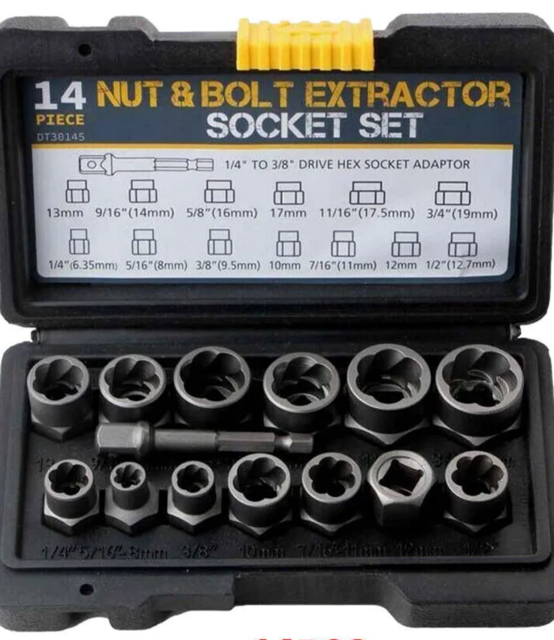

I have a set of these
I bought at a car boot for 33p no idea if they are any good as I have never needed to use them yet

Cheers mate. Haven't got access to a wedding rig. I'll buy some those stud removal tools and see if it works. Might have to be a garage job in the end😞

I have a similar box of extractors as in @koalar photos, you may need to hammer them on a little to get started , but have helped many times on tricky jobs.
Heat and oil also a help as mentioned.:)
I have never seen the last type, interesting design as long as well made.
